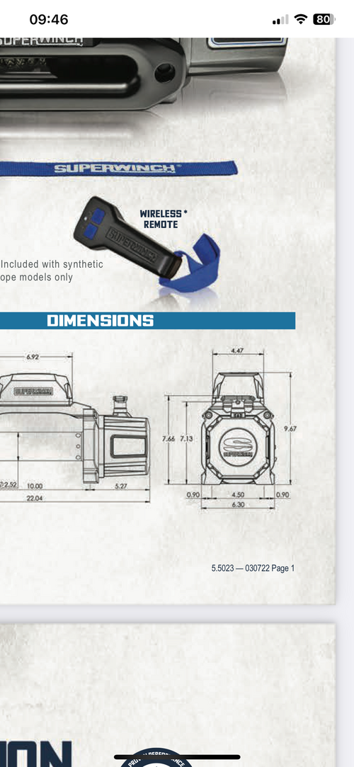

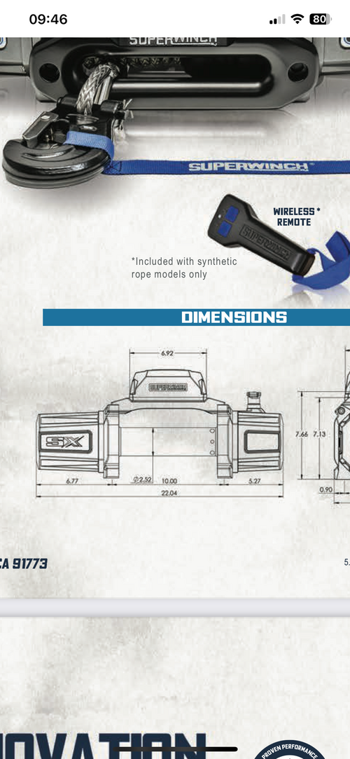

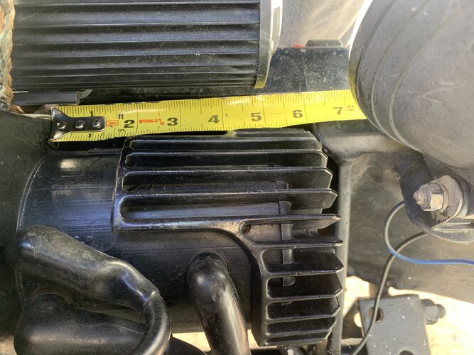

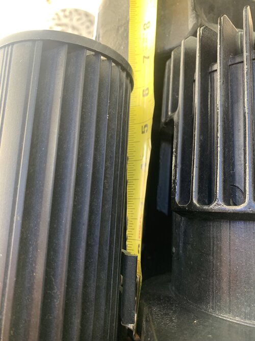

Issues, yes, plenty But also wanted to instal new Synthetic winch line to my current WARN xd9000i system. I fought long and hard to despool it, every foot.
OK, so l looked it up. Same model WARN Dimensions has changed slightly from the pre and 2000 year of the model that I have, space I have would make it a none fit.
Looking at a Superwinch SX12SR, still a very tight fit. Thoughts. superwinch-sx-12000-winch. Then the price is about half (or more) off the WARN ones. (Used it twice in the past 4.5 years). Mounting 10"X4.5" could be standard, I don't know.

So, my understanding their newer model does not have the Finned cap and a 1/2” + longer on the motor end (currently got a 1/4”, spare). By my silly measurements, The SW a 3/4” overall shorter than my existing W ( motor side).
Love the idea of rebuilding just dislike the part ordering that always gives me fits.
I’ll plenty of time for that in the future, however. So this is what I see.

Gotcha. You might double check, there's an XD9, XD9000 and an 9.5XP. Then there's the integrated with 'i'. It can be confusing.
I have the 28500 XD9000 and mine's a pre-2000 build, but it's got a smooth motor, no fins. It's the stand-along solenoid version of the 27500 like yours.
The current 28500 is called an XD9, still no fins. But the clutch handle is a flat key shape instead of my long handle. It's a subtle cosmetic change.
The 9.5XP had the fins back then and was a higher spec winch.
