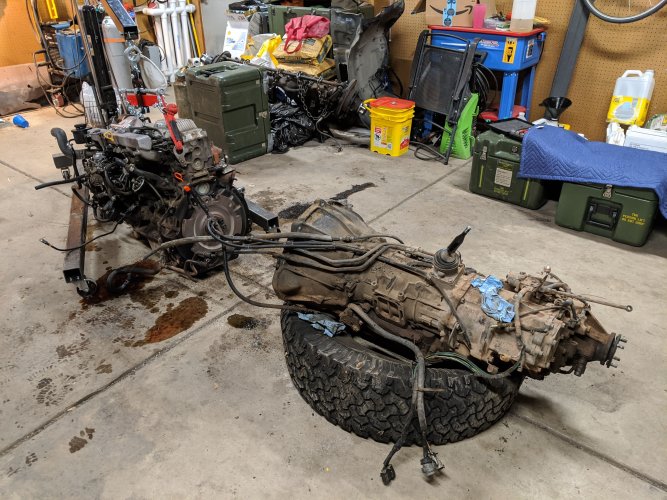

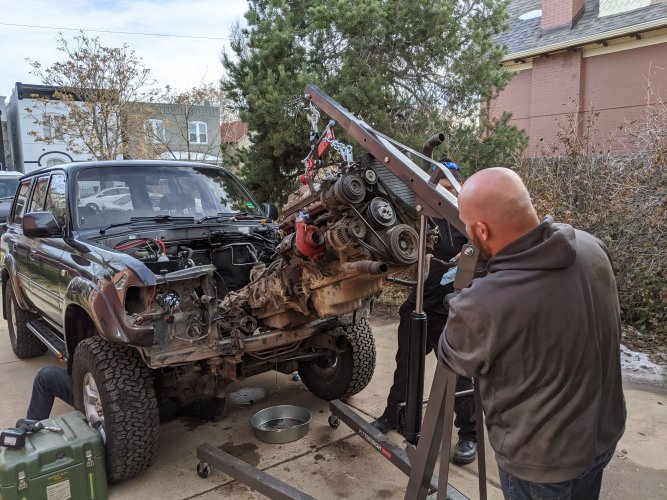

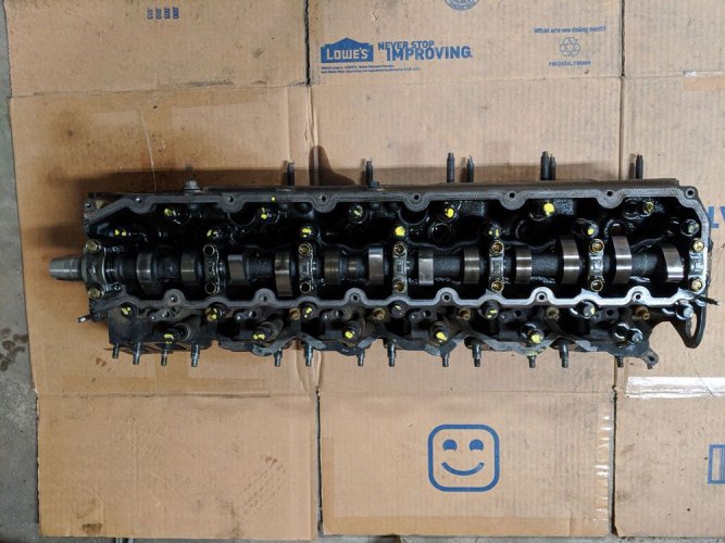

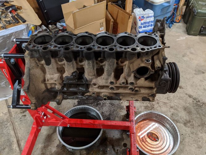

1HDT teardown is mostly complete. Just waiting for a better impact gun to get the crank bolt off then off to the machinist.
