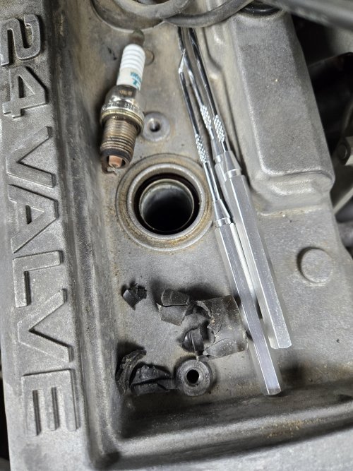

Anyone want to guess what we were up to on the 80 today?
PSA to change your plug wires *before* they rot to death and you have to dig them out piece by piece with a dental pick.

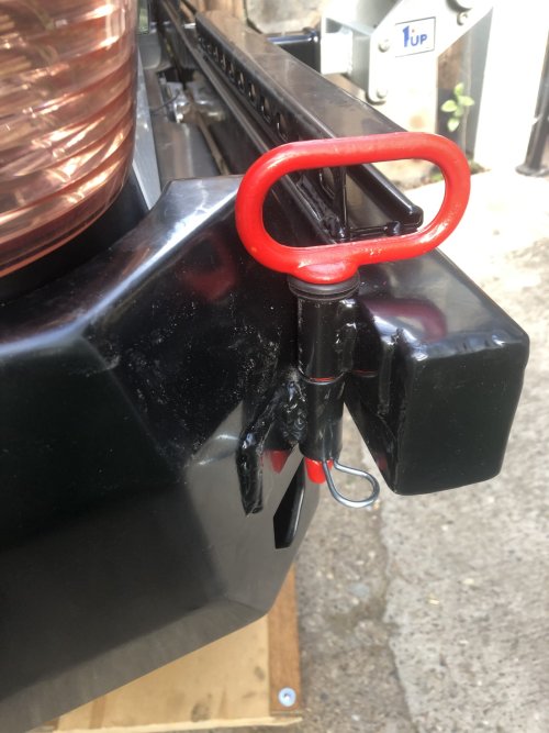

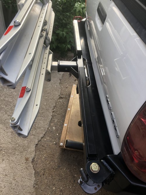

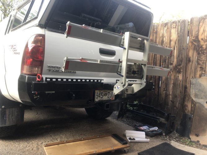

Newbumperarama.
Main body is 4xinnovation standard hitch. Used Adam's hinge and I'm totally to blame for the swing out.
I lost a little clearance but have a fully rated tow hitch again and the bike rack can swing out to make life a lot easier. The unistrut is roughly similar to the stock utility rails Toyota put in the Tacoma so I have some mount ideas for stuff on the back. I like being able to change things without cutting and welding since I don't plan on hanging too much back there. A single jerry water can, Hi-Lift, shovel maybe. See what works. Figure then for long 4wd trips I can change out the bike rack for a basket for a bunch of jerry cans for fuel and water.
This was the parallel winter/spring project with the new head on the 22R in the '85.

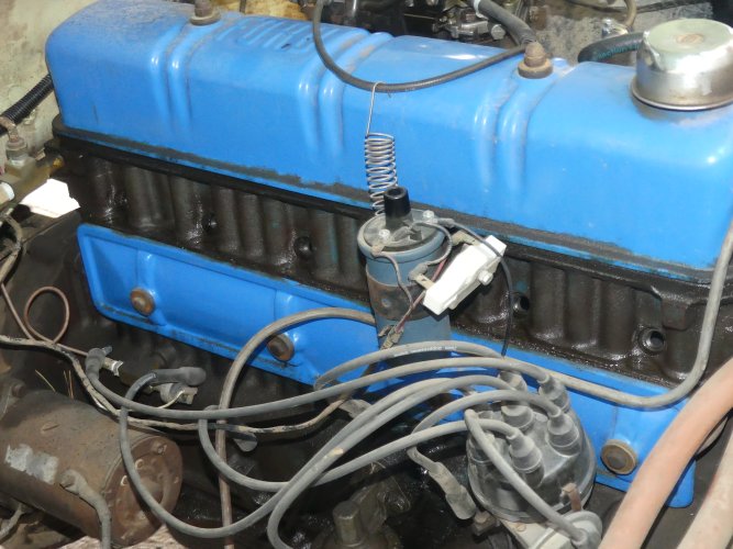

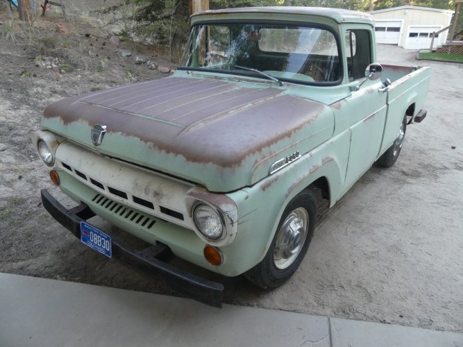

Working on a neighbor's '57 F250 as a labor trade for paint work he's doing for me. Super clean truck. So, so simple to work on... possibly the fastest compression test I have ever accomplished. Oh, for the days of vehicles so simple to work on. He's going to leave that sweet patina and clear over the existing paint.

Brings back great memories. First vehicle was a ‘65 F100 with a 240D straight six that I drove in high school and early college. As said, easiest motor to work on. I could stand in the engine compartment with my feet on the ground. Loved that truck.

Damn, that looks clean and straight as can be! And that patina 🤤

That’s really nice! We LS swapped my 78 and the wiring wasn’t too bad, we’re LS swapping a 58 Apache now and there’s like 3 wires in it. It’s awesome

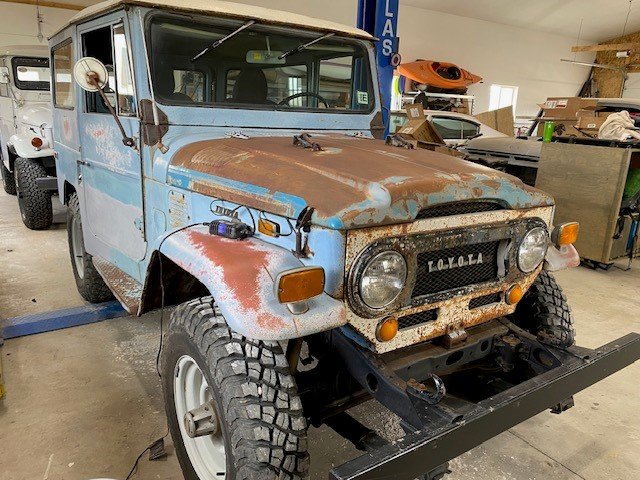

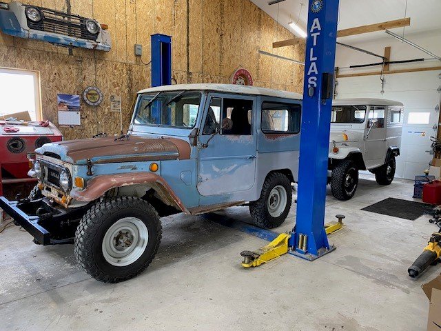

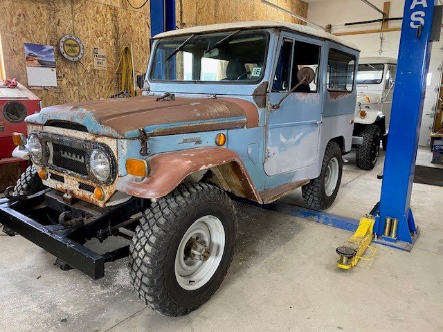

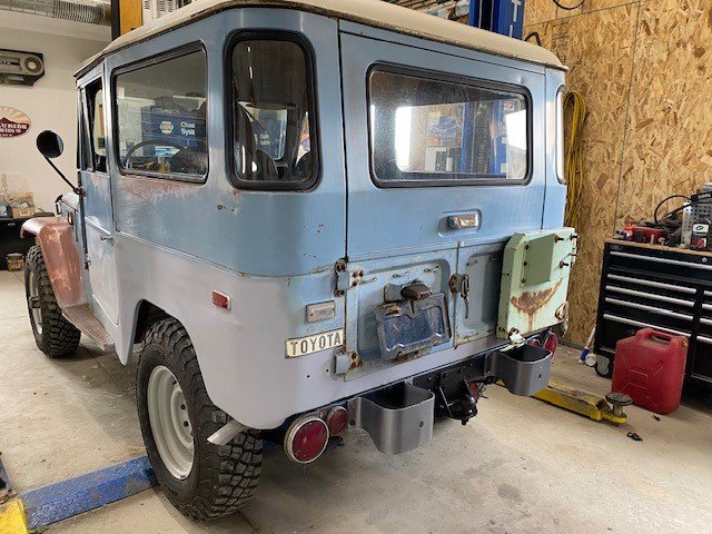

Spent a chunk of the day tuning the 1970 FJ40 that I am going to give my Daughter to start her in the hobby. I bought this 2 years ago as part of a 2 truck deal with the intention of getting it running and reselling it. It had been sitting in the PO's driveway for 20 years due to dodgy brakes, rough running and the usual 40 series rust. I have replaced the front axle with a disc brake axle from a "76" 40 and rebuilt the rears with all new parts. The rough running was no more than just a good tune and a carb rebuild. I cut out the rust and welded in new steel and primered. Now I get to try my hand at matching the patina on the rest of the rig. Still need to put a clutch in it along with a new rear main and T-case seals. The PO got this from his dad who purchased it new and gave it to him in 1982 as a wedding gift. Cool story with cool patina I could not bring myself to sell it, so it is going to my daughter for her 30th birthday.

LOVE this. If your daughter needs a crusin' buddy, I am her woman. 😍😍😍
