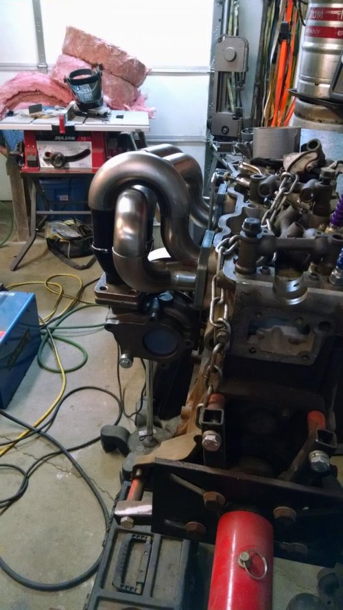

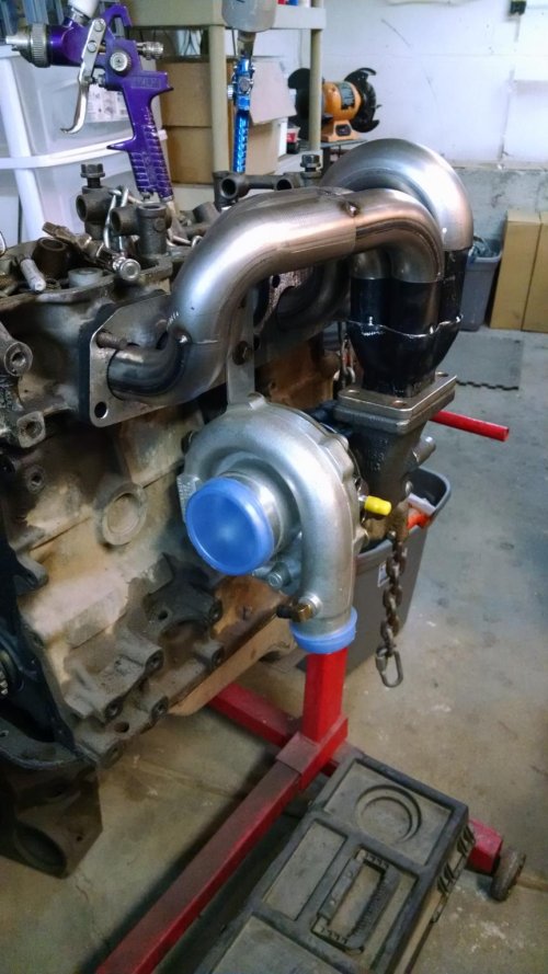

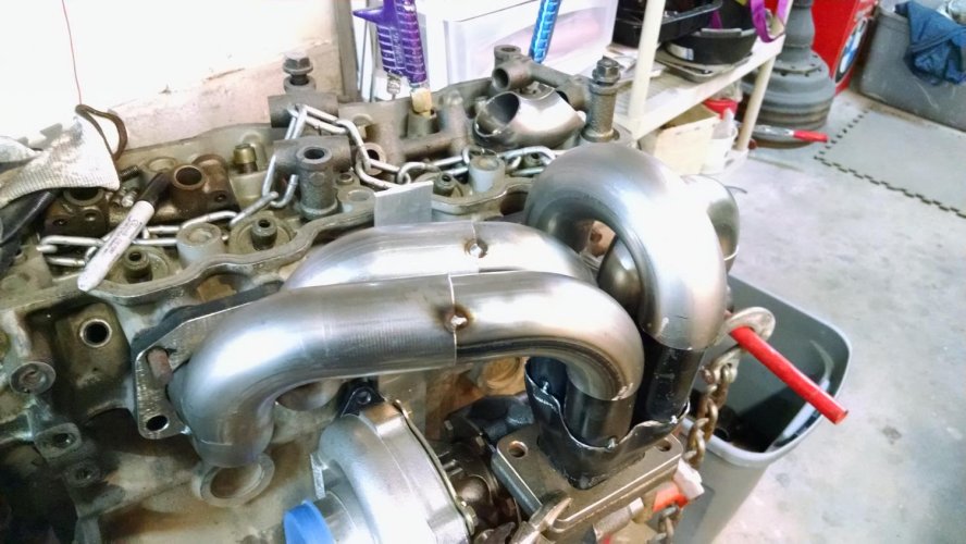

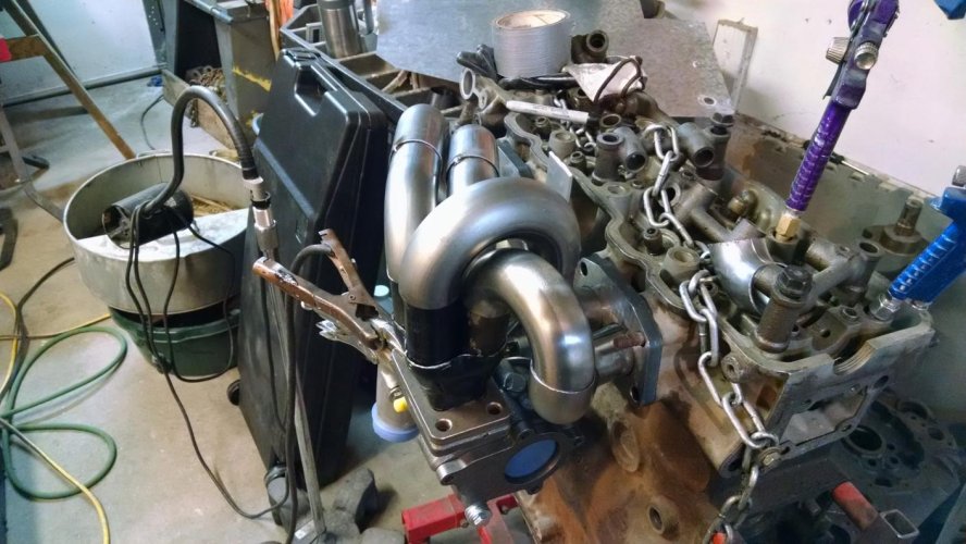

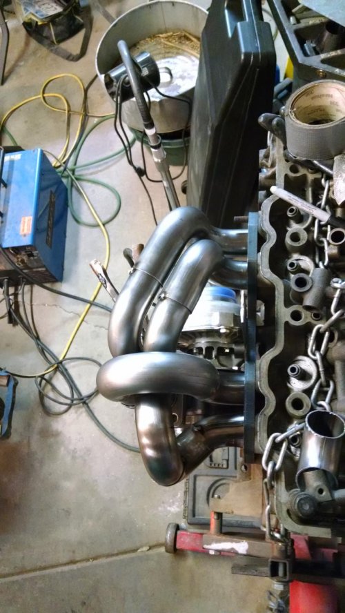

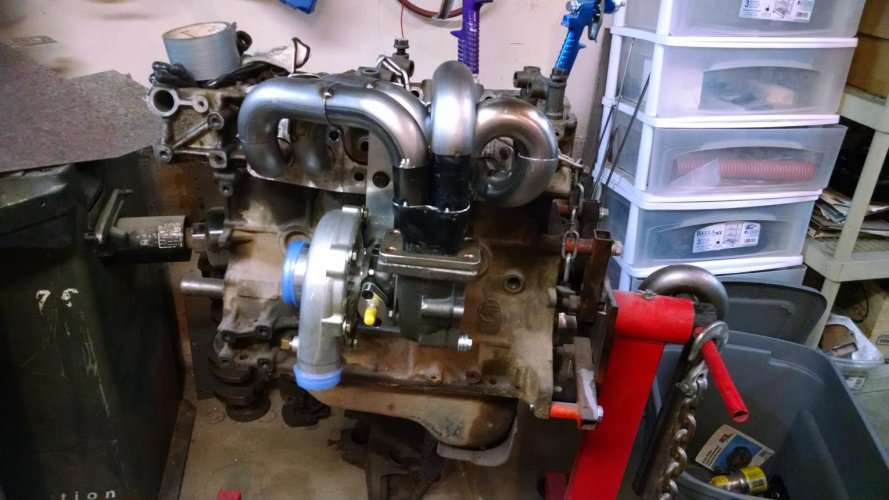

I finally decided to start building my own custom turbo header for my 1st gen yoda truck's 22re. Two hours of work and this is what I came up with.

Nice work! That's going to be a fun one to weld up

It won't be to bad, every pipe can be welded on the bench then installed into the flange and collector. It looks like it will be mostly easy... Note I say "mostly"

This needs it's own thread - a lot more than "I rotated my tires" today LOL! Looks really nice!
9,580
two hours is pretty quick work for that, looking good!

There's really not a lot of work in it right now. 3 of the 4 tubes are simple 90 bends, only #4 required any real amount of thought and trial and error. Of course its only tacked together right now. The real work has yet to be attempted

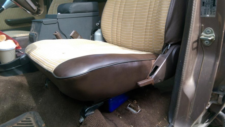

Fixed the big hole in my seat!
