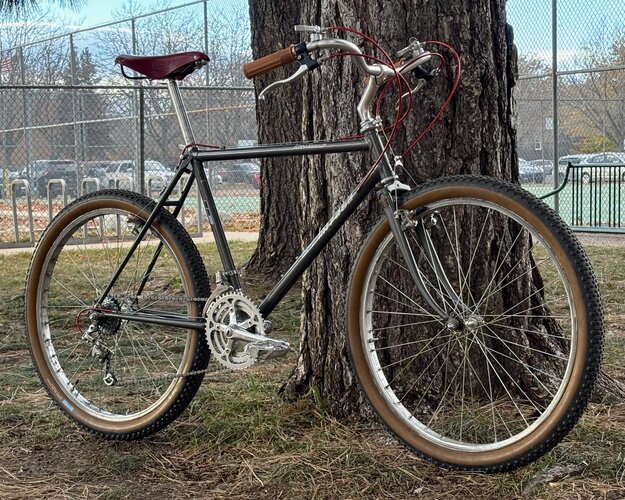

This is probably just boredom talking but I find myself thinking I need to build a vintage MTB dropbar. Think gravel bike on classic rigid 26" MTB. Anyone go down this path? My thoughts lean towards a late 80's full rigid steel frame/fork. Something kind of unique or special in my heart from that time when I first started working in a bike shop. I've got plenty of 26" wheels laying around. Choosing between a vintage drivetrain or something more modern would probably be the hardest decision. I'm trying to visualize what I've got laying around. There should be some old school S-Works cranks somewhere. I had a set of Cooks Bros on my old townie but I actually broke one arm a while back :mad: Believe I've got some original series Shimano Deore brakes (NOS condition) Plenty of quilled stems. Some old Mavic hubs but that would force me into a 7 speed freewheel. (I have plenty of those) And some Sach Quartz 8sp drivetrain stuff. I'm sure there is more kicking around the attic. Campy road stuff.
Colnago MTB build I found online. That appears to have some vintage Mavic drivetrain goodies :cool:

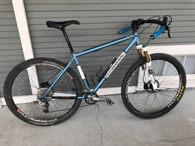

Another cool looking build. I don't recognize the frame set.

The cool aqua fade frame is a Shogun. They would put the model on the downtube and if I was to further guess it's a Ground Breaker or maybe a Prairie Breaker, around 1990 or so. There was a period where they did triple triangles like GT but I don't know if the trad style dates before or after those.
This is what I do for a quasi-drop bar gravel/tourer/whatever. I'm no stickler for vintage or authentic, just collection of parts. It's a modern(ish) 2012 but with the throwback geometry (71°/73° suspension-corrected straight outta NORBA, 1-1/8" HS, etc) adapted for 29'er in the English panels paint job Gunnar was doing special that year.

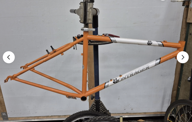

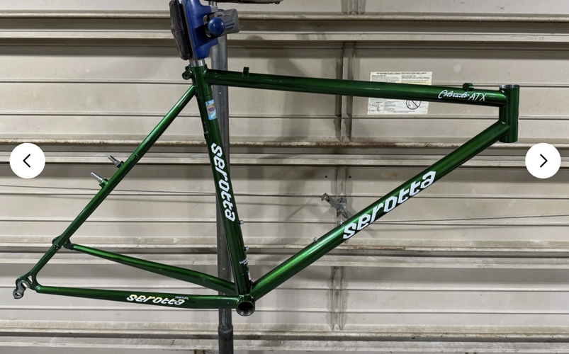

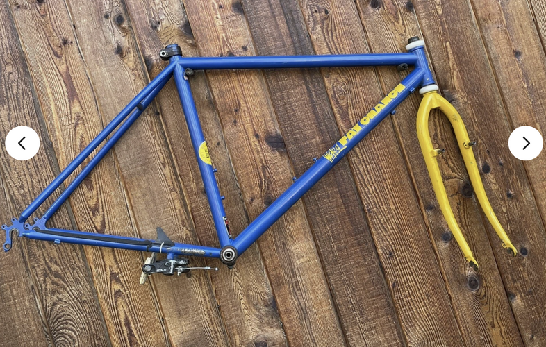

Some other interesting frames.
Kind of partial to these as I was working in a Schwinn/Trek/DiamondBack dealer when this came out. I ended up with a Trek 990 at the time. Would just need to figure out shifters with that sweet vintage XC-Pro.

I'd have thought it would be guarded love for Jacquie since her WTB bike (she named it Otto) was a welded straight gauge aluminum frame. Very against the grain, non-Zen, from the mythical perfection of lugged steel.
Bontrager, too, did TIG welded steel with tons of gussets and he got plenty of grief about that. I respected (still do respect) the heck out of him, he has a degree in physics from UC Santa Cruz. His non-traditional ideas were not random, he brought data.

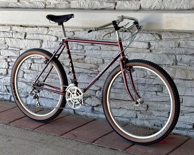

@Corbet I’m going to disagree with Wes and encourage you. Riding an old bike is still viable. In fact I think the fun:dollars ratio is super high and one of the best value propositions in bikes right now. And fun is all we’re after, right?
I built both of these bikes this year, and Karen & I have ripped around on lots of gravel & singletrack. Are we doing the most technical terrain? Absolutely not, and that makes for a good excuse to own another more modern bike. Are we having heaps of fun? Absolutely yes. Every time we’re out, spandex-clad dudes on high dollar long travel modern mountain bikes always stop and tell us how cool our whips are. Follow your dreams, even if they seem kind of stupid.
Hers: Look at how SLACK the geometry is!
Mine: Yes, 50.4bcd TA Cyclotourist cranks. Super wide chainring spread. Took lots of fussing with the RD to shift with a 52-48-22 crankset and 14-32 freewheel but it does it!
Both got new freewheels, chains, bottom brackets, Nitto stems, bars, cables & housing, tires, and the hubs, derailleurs, & brakes rebuilt. For under about $350-400 each, they’ve brought us LOTS of fun.
