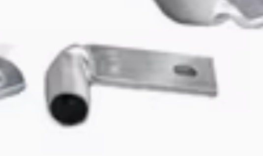

I’m in need of a unique terminal lug for 4 awg wire. I pulled this image from a Chinese source that probably only sells them by the metric ton. I only need one. Plus there was not any real info there.
But anyway. I need a 90° tab. It’s easy to find them with the bend on the other axis but like this seems to be difficult to source.

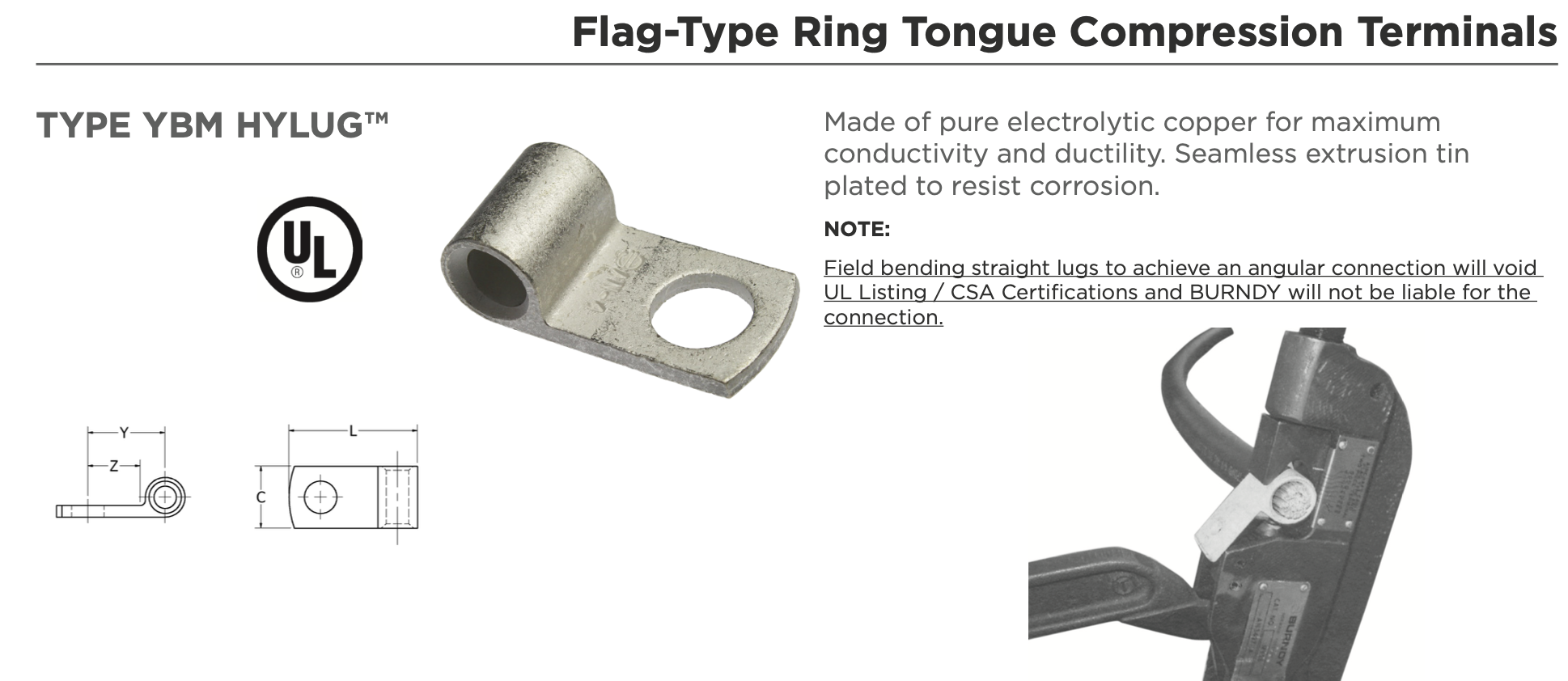

"Flag terminal" is probably going to get you in the ballpark. Check Mouser and learn to navigate their search functionality!

Those Burndy-type flag terminals are commonly used by the utility guys and a little less so industrially and commercially. They take a slightly different set of dies than more common compression terminals. Whenever I've used them I've had the right tooling but admittedly this is exceedingly rare, it's usually the RE (Real Electrician) and not the EE (Electrical Engineer) doing the work that would require them.

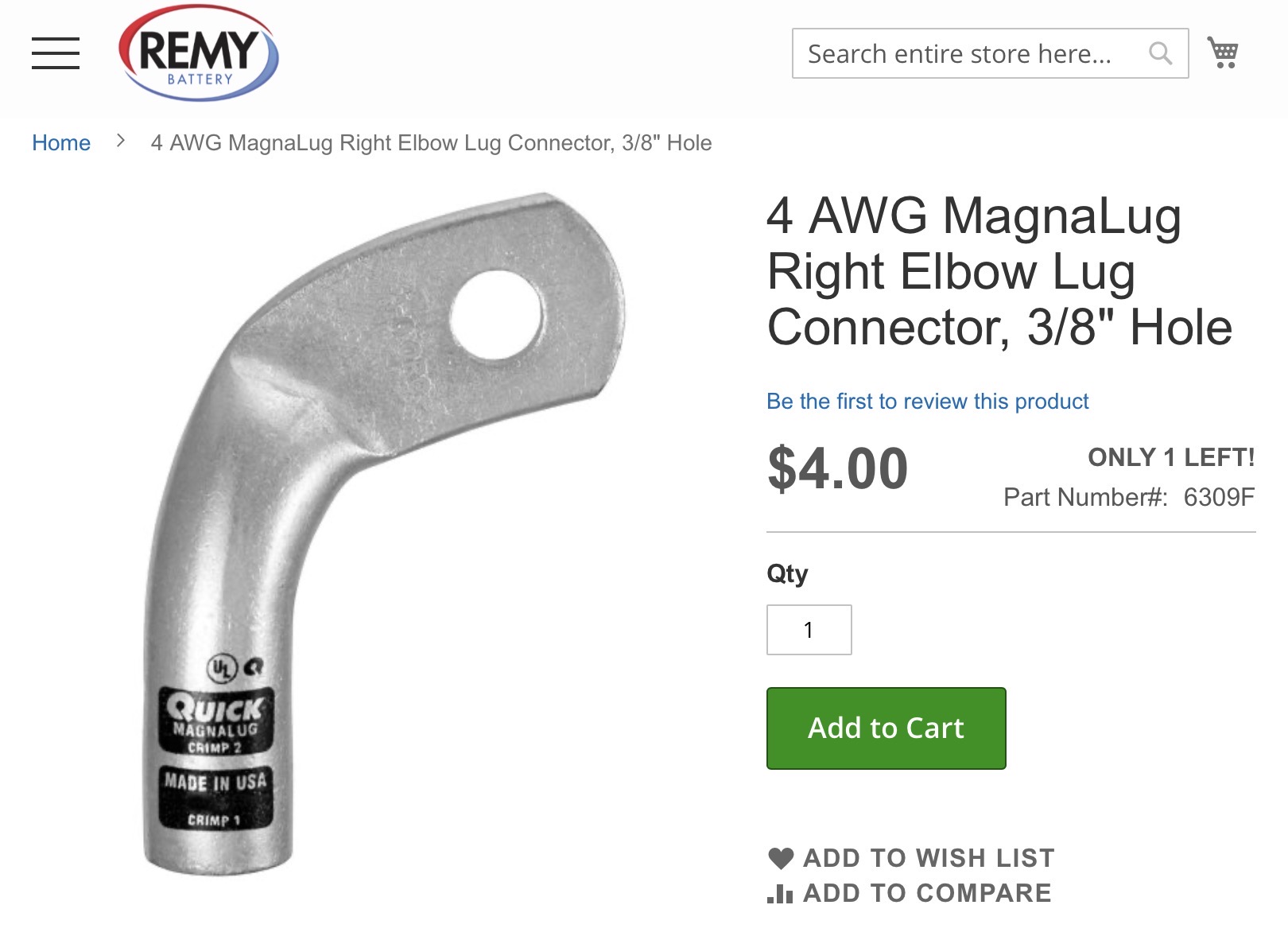

Never tried one in the set of tri-form FTZ crimpers (designed for the MagnaLug type crimp) I have personally. Might work, might not. No idea.

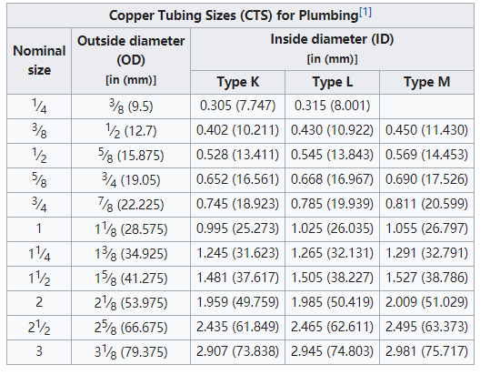

Some dimensions for hard copper plumbing pipe.
Also for the soft refrigeration copper tubing you get in coils.
