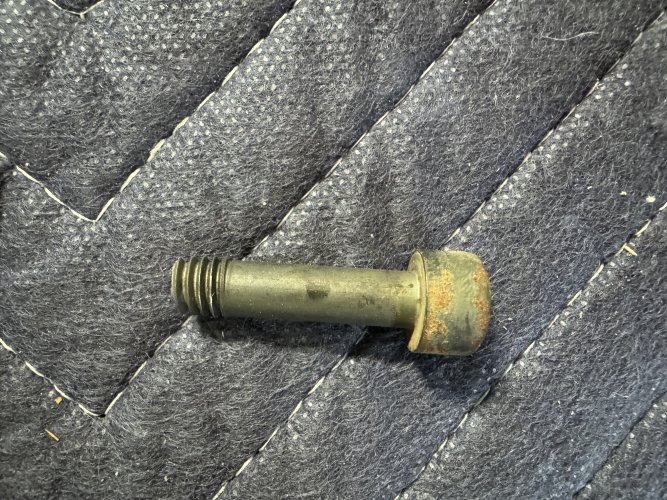

Damn it. Not only is that bolt not reverse threaded, it’s now broken off. Fml

yeah. I got it out- guessing the shock of the bolt breaking knocked it loose? I was able to turn it with a vice grip 1/8 of a turn... and then the broken end was just finger tight. Wild... I thought I was gonna be super screwed here.
I was literally bending my allen wrench 20 deg trying to get this free... in both directions. I moved up to a 6mm socket adapter, which felt like finally broke it free... well it broke it alright. Anyway, time to walk to the auto store to get a new bolt.

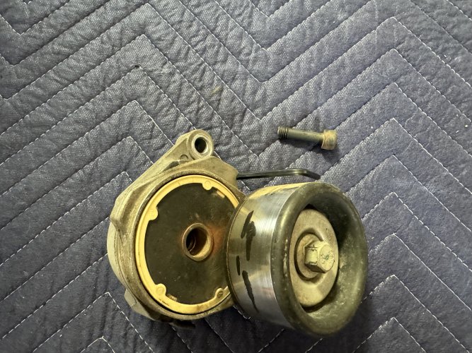

Oh that one might be, I dunno... no need to remove it as the new thing comes with that idler already installed. I thought you were talking about the allen wrench before... well now I know. :doh:
old & new tensioner.. even comes "pre pinned"
