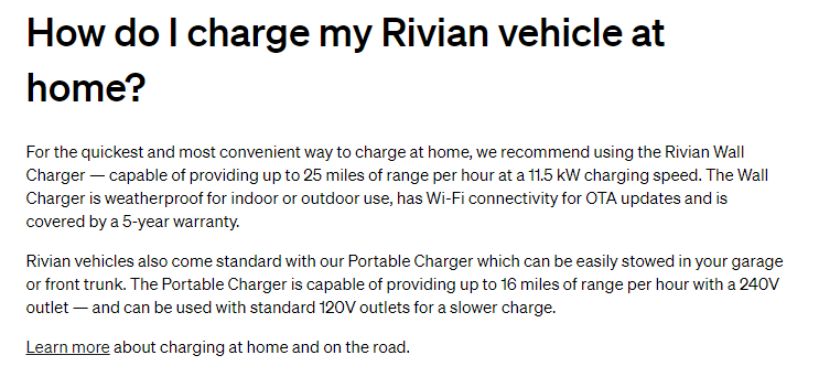

@DouglasVB to get 250 miles' range with those requirements in a pickup truck...you won't be able to fully charge it overnight. Just realize that. Every one in this thread has a house with maximum 220v 50amp service "dryer plug." That's 11kw maximum. That means over 10 hours you can only put in 110kwh to the battery. That's enough for a Tesla but the new models like Rivian, Hummer, Cybertruck etc that have 130, 150 or even 200kwh batteries....not going to cut it. Drive your Hummer down to 10% charge and it will take two days to charge it back up!
Of course you could use public chargers that are faster or upgrade your house service for thousands of dollars.
That's partly true and partly misleading. For one, Tesla and Rivian sell wall connector that offer higher charging speeds, but they are $500-$700 plus the cost to wire them up which can be expensive if the panel doesn't have the capacity. But once added, the Tesla wall connector offers up to 44 miles of range per hour of charge, and the Rivian option offers 25 miles of range per hour - mostly due to the fact it's going into a bigger pack and heavier vehicle.
If one just uses 220v, the speeds drop to 16 miles of range per hour charged on the Rivian, but there's where the slightly misleading part comes in. Most people park their car for more than 12 hours a day at home, so if it was even on the lower charging speed, that's 192 miles of range added in 12 hours. How often do most people drive more than 192 miles in a day? How many people do that every day? It's exceptionally rare because that would translate to over 70k miles put on the car every year.
The reality is the vast majority of use cases are well covered by people simply plugging in every night when they get home, and in the not distant future, many people will be able to charge their cars while they're at work or shopping or eating - often for free.
14,137
The Tesla charger you show is the $550 11.5 kW/48A (e.g. their "Wall Connector"). There's no NEMA outlets larger than 60 amps defined if you want a plug-in style.
You can install larger breakers in many service panels but you'd need to make sure. The largest my ancient (circa 1970s) Square D panel can take is 50A.
To do more than 50A you will be supplying a hardwired charger. The largest level 2 charger is if memory serves 22kW, which would require a 100A, two-pole breaker and a 2 AWG branch or 3-phase available to drop from the pole or 400A service where you could make it on site. Beyond 22kW will very likely require 3-phase.
So the point Jimmy is making (if I may presume) that if you intend to go beyond 11kW make sure you have planned the distribution circuit to handle it. It's not gonna be using a dryer outlet as an after thought.
