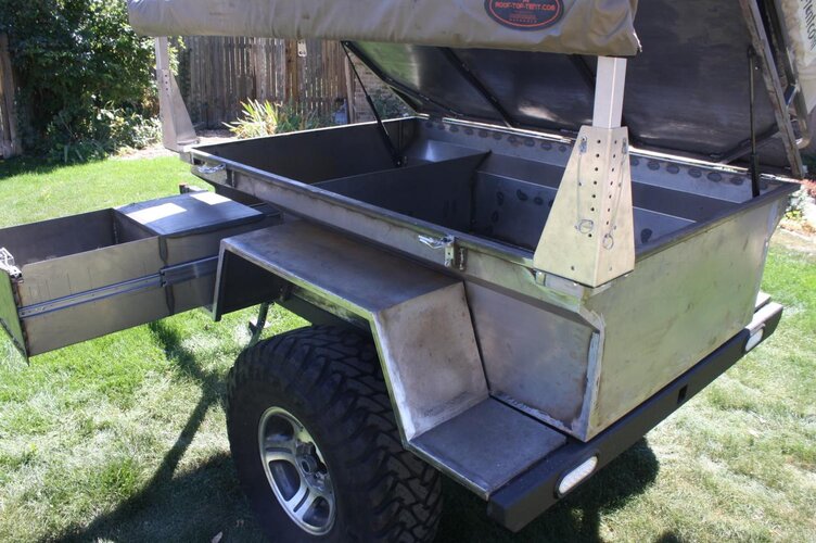

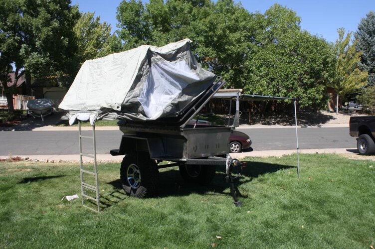

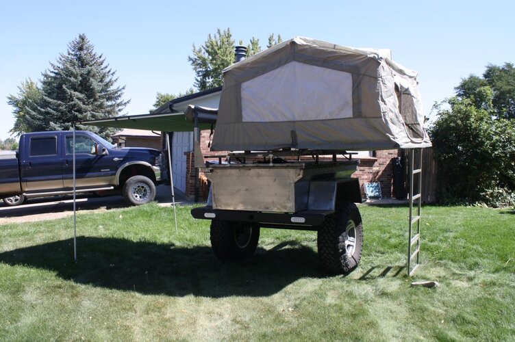

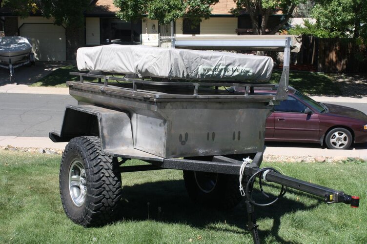

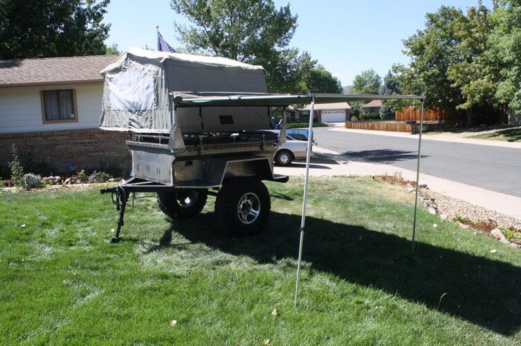

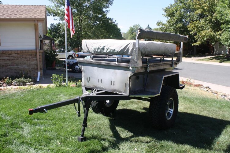

i finally got the trailer finshed up. there are of corse some touch ups needed here and there. but the fab is finshed.
i pulled it out and stretched its legs, so to speak :hill:

any sort of stabilizer at the rear of the trailer (trailer to ground)? i'd be afraid it'd tip while i was sleeping in there;)
SteveH
Aug 10, 2006
3,147
Colo Springs
There are many cool stabilizers in the pop-up camper world - either crank down or flip-down. Some are stouter and better engineered than others.
TIMZTOY
Apr 7, 2009
1,914
Yea. Jeff has it.
I was just setting up for photos.
And it's pretty stable w/o it. But it did tip a tad when the wife was inside and I jumped in. :)
