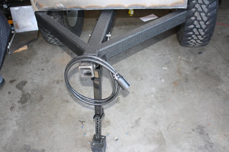

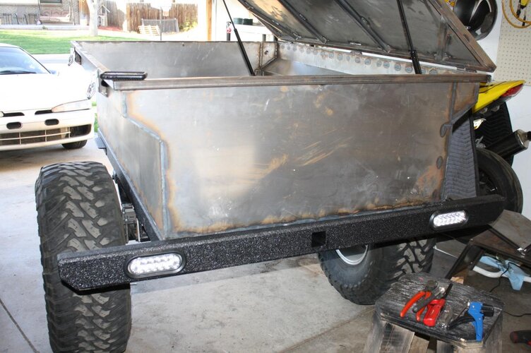

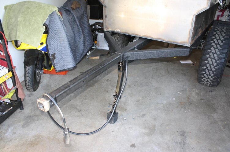

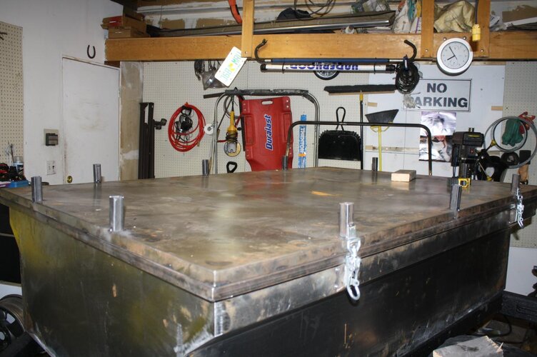

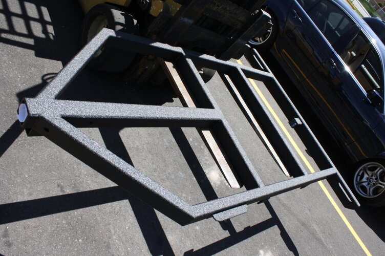

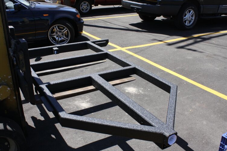

well finally some more updates.. I have actually not really worked on it at all in quite a while.. just kinda here and there, at first i finshed up the tail lights, (thanks nathanial) then dry ran the electrics. then the next day i took the frame over to B&T bed liners after cleanin up a few welds.. while the frame was out, i cleaned up the tub. ground down all the welds on the out side. set up the shocks on the lid a little better ..

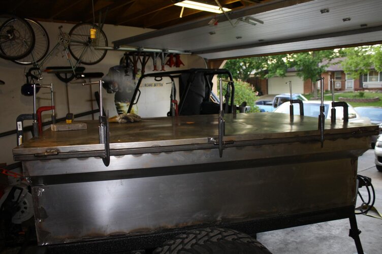

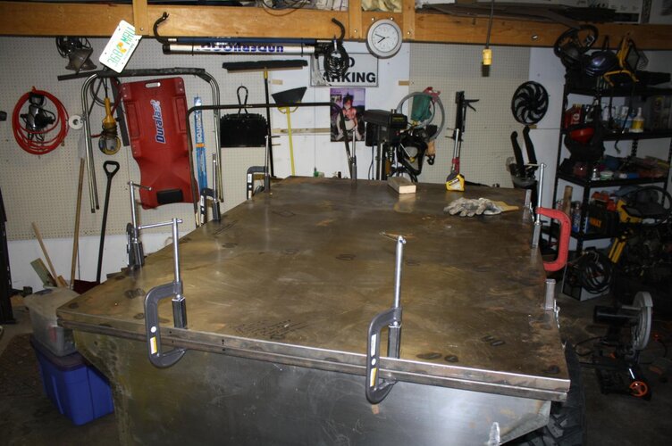

more pics

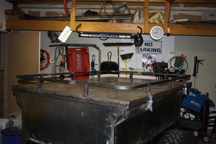

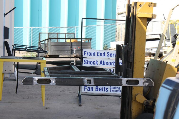

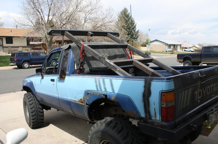

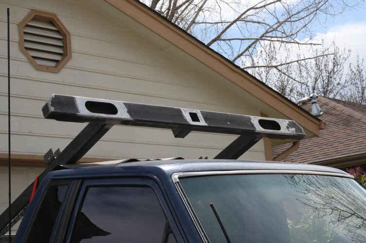

yesterday evening i drove the trailer up to marco's house in boulder, trailer towed perfectlly. with Marco's help and his tubing bender i was able to bend up the 1" tubing for the roof rack, being as it was my first time bending, and marco was rusty we didnt get the length's perfect. which is 100% ok to me because i was planning on it not being perfect anyways, and having to cut them down.. i do have to say that we almost got it perfect on the second bar.. only a 1/4" long overall ..

Will there be cross posts on the rack for say attaching a RTT to or would it attach to the outside bars somehow? :)

Looking really good! How did you get the holes for the tail lights so perfectly symmetrical?
Laser cut pieces from nathanial on a 4"x12" ish piece of steel that I grafted into the rear end. The bumper was to thick to acomidate the gasket.
I don't know how your tent ataches, so I was keeping it like you see it. Because I can always fab up 2x cross bars that just bolt in.

my only feedback is around the wiring harness. Do you have the ability to pull the wiring back out, enlarge the hole, then grommet it? you may not think that point will wear, but....
yes i have the ability to do so, and i was going to do that initinally but couldnt find a gromet that i liked.. but thank you though

you can make your own. take some 6mm high pressure fuel line and slit down the middle. I have had good luck with the ones from mcmaster out of their assortment. There are firewall specific ones too.
