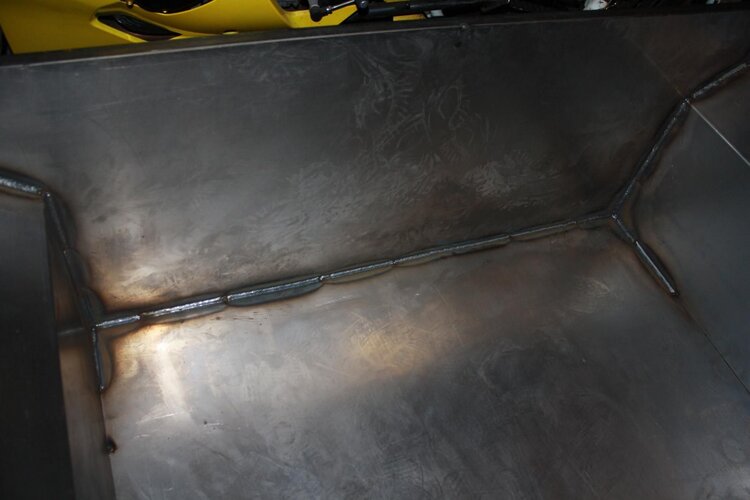

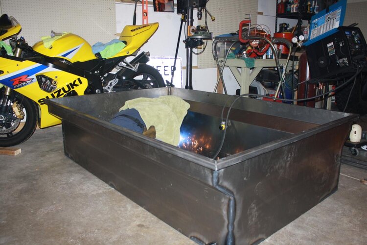

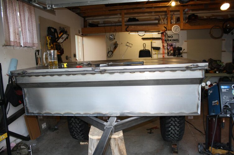

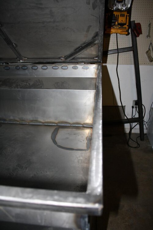

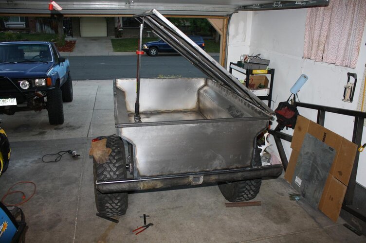

i got the axle moved back 2" which was a good thing, because it made the toung weight from about 10lbs to 45lbs with the toung inwords and about 35lb extended. actually i gotta give props to my roomate, he actually did the grinding and welding while i was at work. :D:D
also got the tub compleatlly welded togther. all i have left is to finsh the 1" tube around the tub..

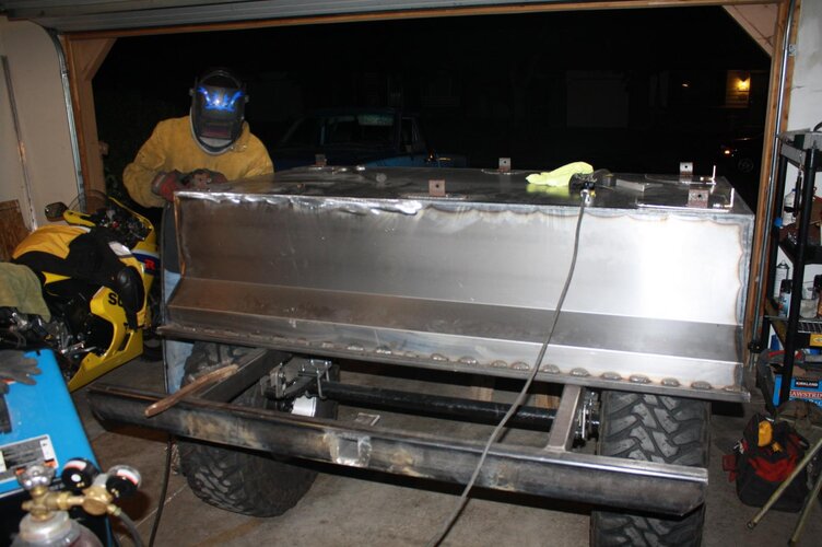

i also got my rear bumper finshed up.

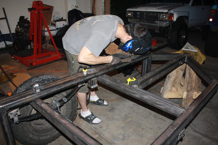

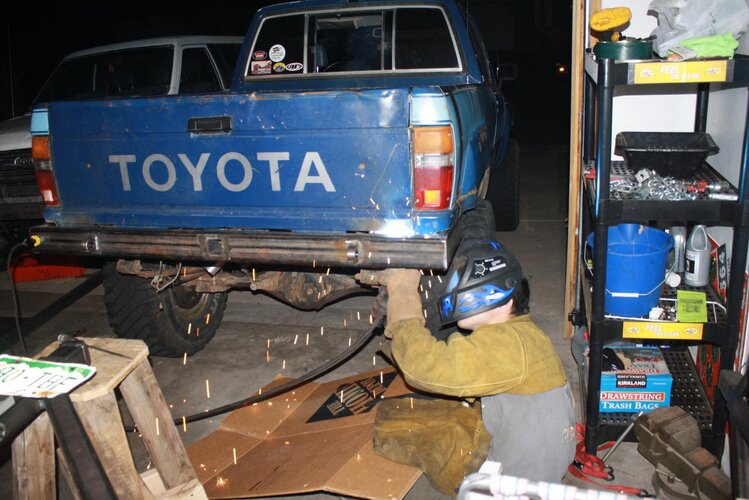

nice work. I love the welding in socks and sandals.
yea we were laughing about it.. thats why i tool a pic of him doing it.. :lmao::lmao: and no :beer: was involved that day.. out keg ran out.. :mad:

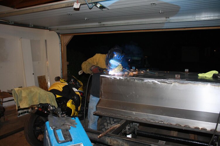

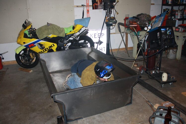

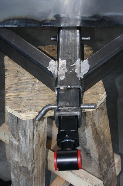

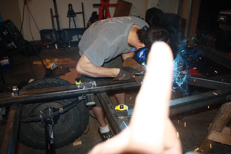

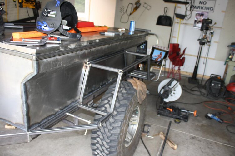

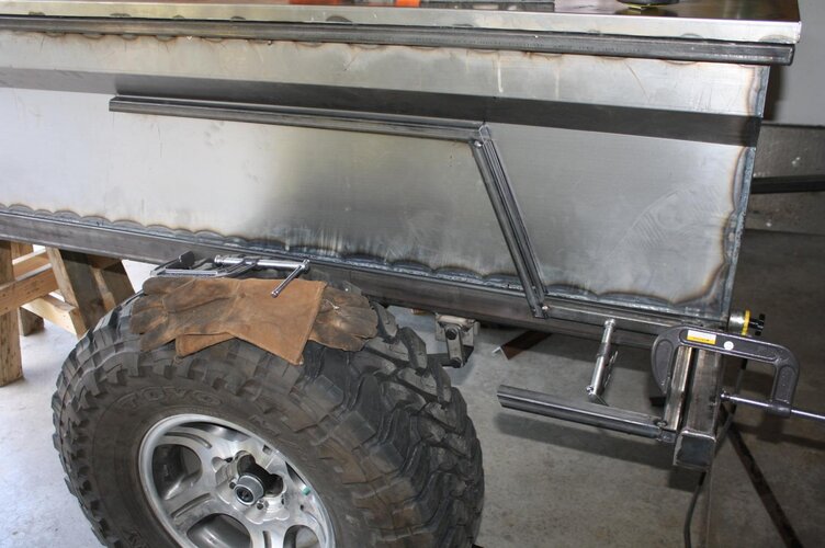

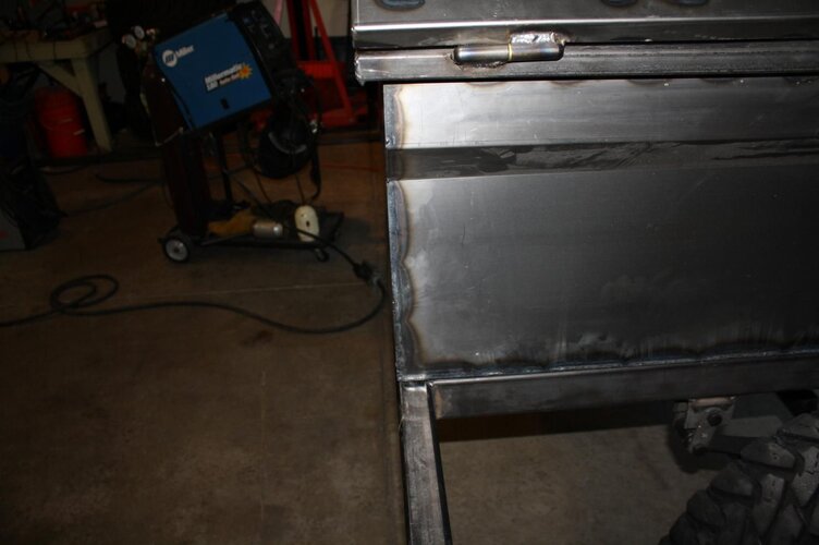

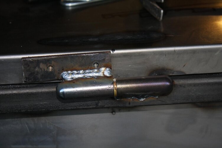

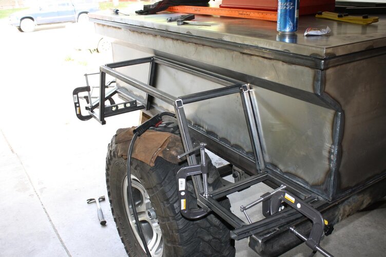

more updates
the first two are of us welding on the tabs and supports for the tabs.
the others are us welding on the barrel hindges

What about putting another hinge at the back, and then hitch pins through the tabs? That would make it really easy to clean out, plus you could use it as a dump bed :) :weld:
TIMZTOY
Apr 7, 2009
1,914
i am putting a 3rd hinge on the back , i just need to make it removable (bolted on) and have it face the opisite direction, other wise it could just slide off when opened. you could easilly just flop the trailer on end, and its virtually stright up and down, and because its almost perfectlly ballanced about 60lbs of toung weight, the wife could easilly put her back right when emptied. :cheers:

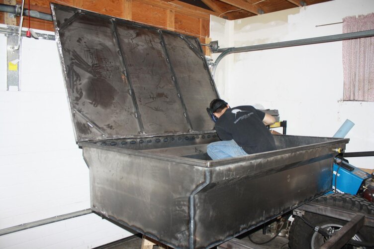

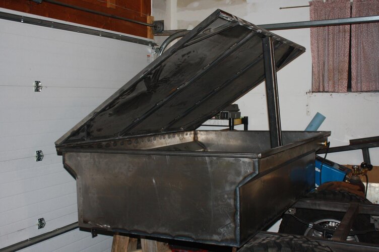

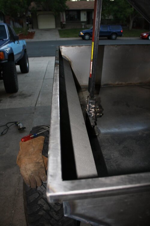

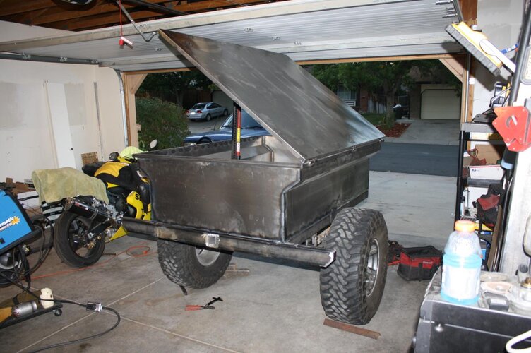

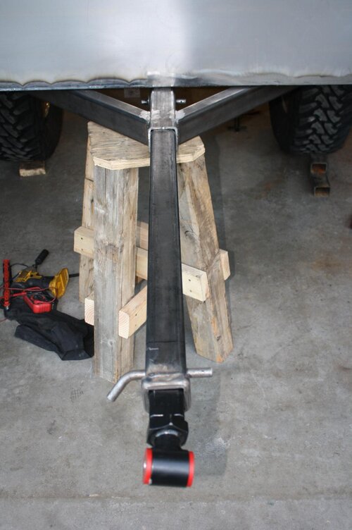

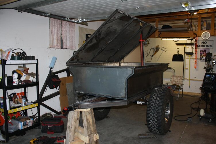

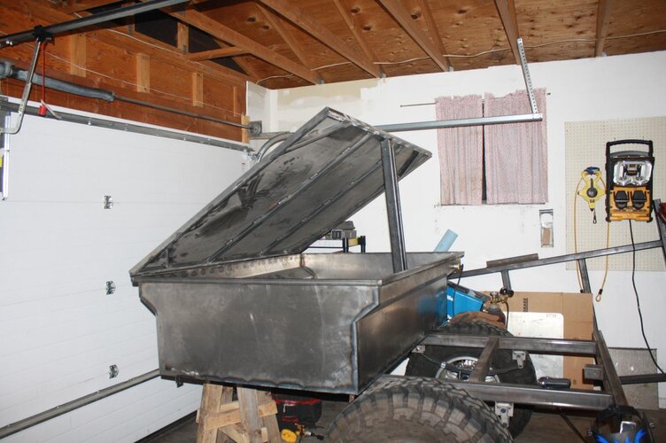

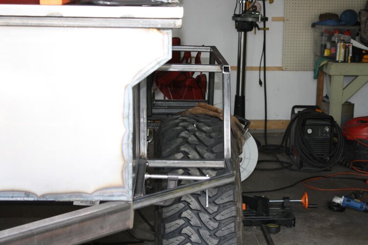

cupple more pics.
i got the third hinge mounted/welded.
then showing the trailer's telescoping toung.
and just pics as it sits now. started on the fenders , only got 2 pieces cut.
