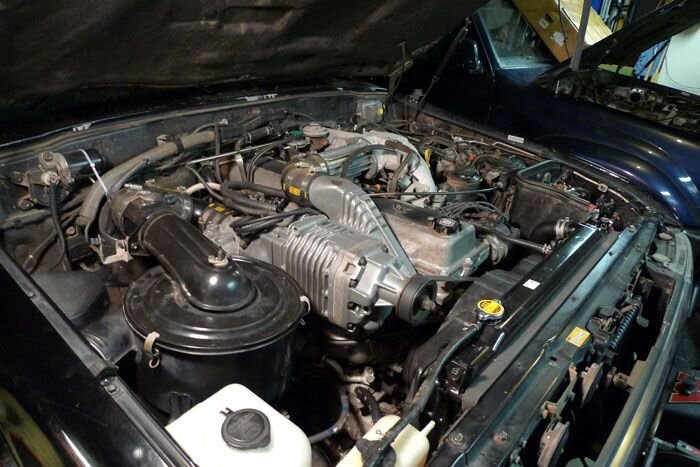

Here's the "after" photo. :)
It was interesting that some of the things that I was worried about were relatively easy, like the crank bolt removal and re-torquing to 305 ft-lbs. Other things were much more of a PITA, like lengthening the TPS and IAC harness wires, swapping the radiator (not required), and getting the 3" hose over the MAF sensor housing.
I'm glad I bought a serpentine belt tool. I ended up grinding off about 0.25" of the socket so it would clear the fan clutch. Once done, the serpentine belt install was very easy.
I'm glad to have my 80 back. I drove the 40 to work everyday for 2 months.
