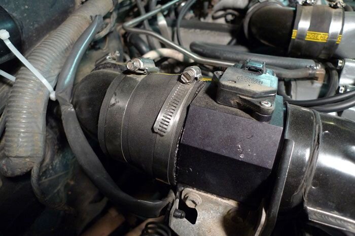

Could be because it's cold. Warm up your oven to say 125F and put the hose in their for a bit
Ken, thanks for this suggestion. I heated it up for about 10 minutes, and that made a big difference. It was not super hot -- I could still pick it up by hand.
Finished result:
