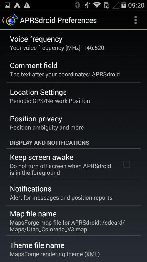

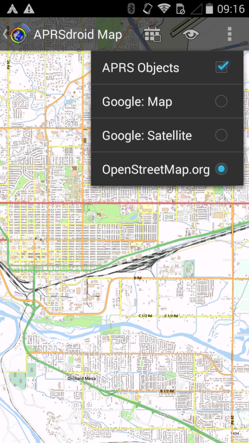

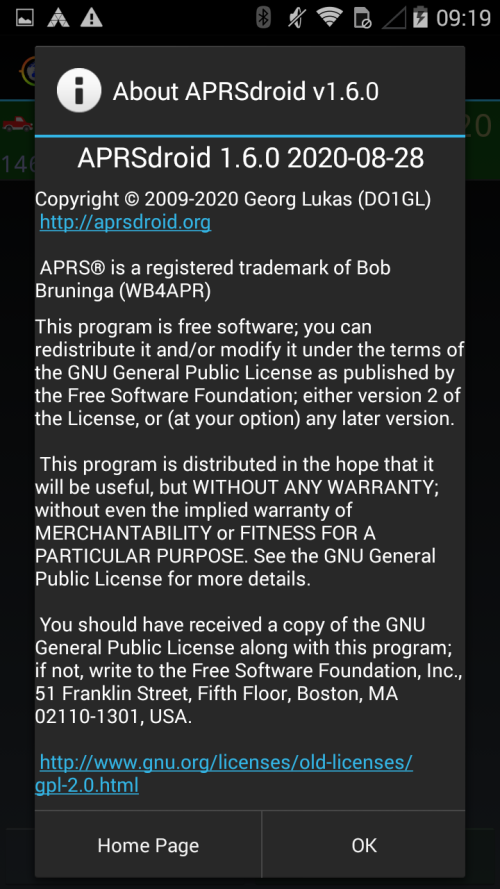

You don't have to use that old 11/18/2018 special OSM version anymore. The main release has an option to use OSM maps now. It still requires Mapsforge v3 (which is limiting) but at least the bug fixes and any new features are rolled in.
I'm using v1.6.0 downloaded directly as an APK loaded on an ancient Motorola Droid MAXX running Android 4.4.4 on it. Seriously ancient. I'm pretty sure there's no difference between getting it through the Play Store and loading an APK directly as I've done.
Click the 'eye' looking icon and it'll bring up what map source you want to use.
If you use openstreetmap.org it'll look for the local file.
Oh sweet! I did basically this, thinking I could just update the map location to my downloaded map but it wasn't working, so maybe it was from not checking that openstreetmap.org button. I'll give that a try later, very cool! I'm assuming if the map I made from BBBike was working on the old version it will work on the new one right? I'll give it a go and update back.
