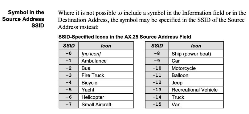

Second question. Mobile is fine but it might or might not get you an exact filter. It could be based on the SSID you put on your callsign, e.g. the dash part of K0NAK-9. There's 16 core SSIDs and a ton of extended ones. But what they mean isn't universal.
For example the standard for APRS identified the main 16 as this. The only undefined was dash-zero, which is the assumed default (e.g. no SSID means -0) and that represents a home station usually. It was intended so the APRS client knew what icon to assign to a station.

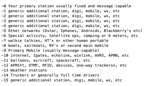

However for every rule there's an exception.

So my point would only be to say that if you filter on mobile you may or may not miss packets. It'll probably include -9 and -7 but would almost certainly exclude -0 or no SSID, which I see a lot of 4WD hams use. That's probably just a lack of deeper understanding of the APRS conventions.
You will probably also miss non-standard using hams. I think a legitimate option is -13 for RV and Yaesu might exclude that if they follow the standard that says this is a WX station.
Basically you'll have to experiment and you might find all is the only safe option unless you know how every one in your party is configured.

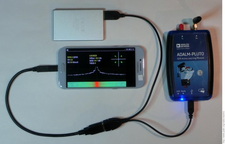

You may look into one of the USB OTG 'Y' cables. OTG = On The Go, which if you're not familiar is a way for a device like a phone to act like a host (e.g. be the computer master rather than the slave device). Phones can't supply power to the USB device that you're trying to use like a real host, usually a USB thumb drive, so they have to use the 'Y' do it.
This isn't an APRS device but it's showing a radio (the PLUTO is an experimenting RF gadget) with a phone and a battery. I think you could do something like this with an APRS station.

I wonder if a USB-serial adapter with the OTG 'Y' *might* work.
