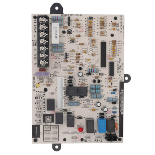

Both HK42FZ027-3313 and HK42FZ027-3715 seems to point to the same thing via web search. The board has seems to have a -3121 extension.
At the same time HK42FZ0273313 and HK42FZ0273715 get no returns for me.
Knowing the exact part number, all characters and groupings, is usually an important detail to decoding it. There's no standard for a part numbering unless one is specifically used, such as with military or government procurement. But even a company's internal nomenclature doesn't have to match external and customer nomenclature.
Anyway, does it look like this? This is Carrier HK42FZ027. I've also come across this board as being called part number CEPL130934-01 and CEPL130934-02

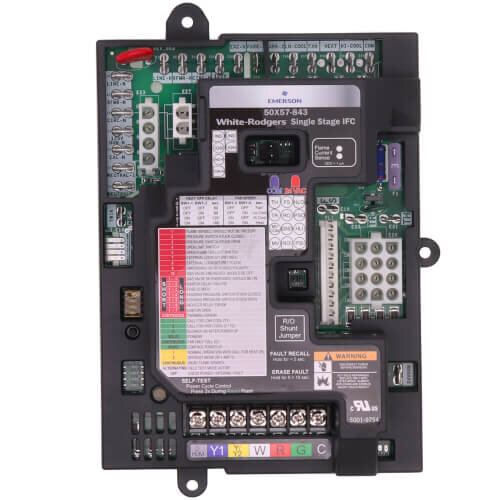

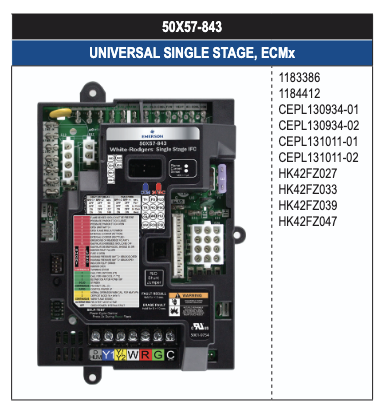

White-Rodgers show a universal replacement, so it must be fairly common. This replacement covers several Carrier, Bryant and Payne boards.
I have not been able to find a schematic, which I'd personally want as a starting point. I've troubleshot a couple over the years but I had schematics when I did them. Haven't found a really good high res photo either.
These furnace boards are usually pretty simple and may not even have a microprocessor. Unless the issue is obvious, like crispy parts, it might not be super easy. Like knowing if a value (although through-hole parts just read the resistor color bands) is drifted or slightly wrong would be more significant reverse engineering. But if you buy a good one to use for comparison there's no economic point to fixing the old one unless you want to keep it as a spare.
There's only two chips that might be MPUs and if they happen to be they would almost certainly be very old 8-bit PICs or something like that to imply there's firmware versions. But I see no obvious indication of support circuits (like a header for debug or programming or more important, a crystal for a clock) that would make me think that's there's one. There's a "PLT" header close to a jumper for test, so who knows? My first guess is those are logic chips, simple AND/OR. That replacement White-Rodgers OTOH I would be surprised if it did NOT have a microprocessor on it, however.
The dashed (as it were) part in the case of lacking an MPU might just indicate board revisions or differences in what's populated. That could be nothing, like they had to spin the board due to a part obsolescence, or important in that they changed circuit function. Only they'd really know. My suspicion is minor changes since these seem interchangeable but that's pure speculation.

Dave, I was able to confirm the White-Rogers part will work, for a whopping $223. The OEM HK42FZ027 will also work, but for $480 from repair clinic. Since I don't know for certain a circuit board will resolve the issue, I opted for the cheapest alternative.
