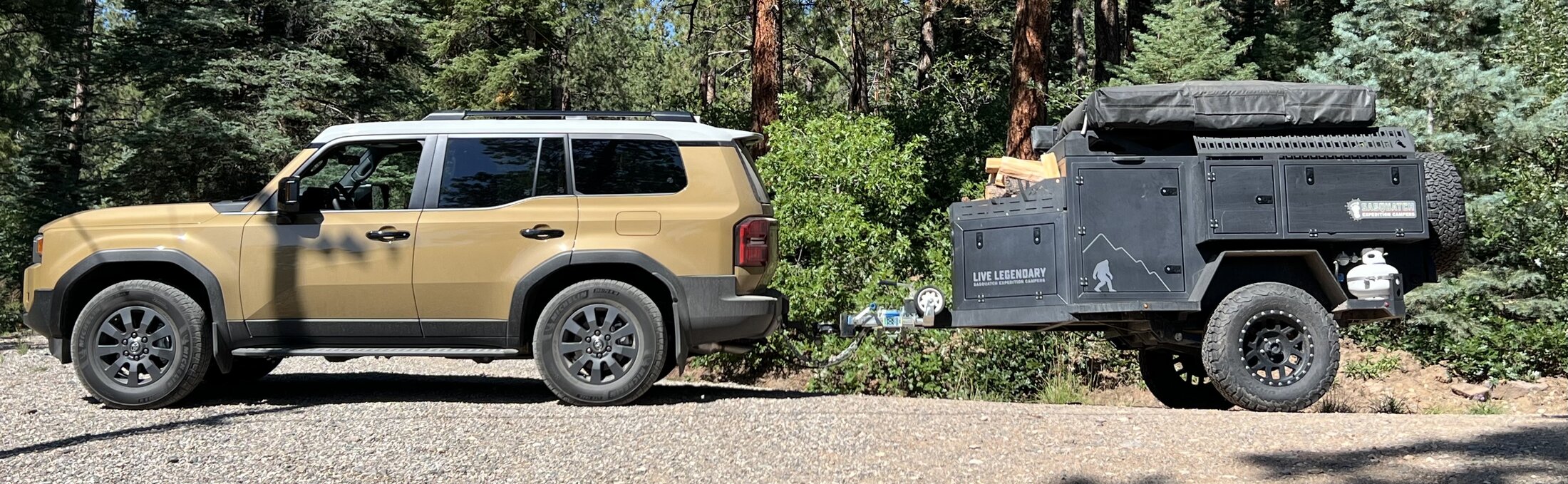

Tried it on the 250 for size. Had to flip the coupler back over, and I need to play with receiver drop height. This is with the 4” drop I use with the 80. Trailer still a little nose down. This combo goes to AK next summer.

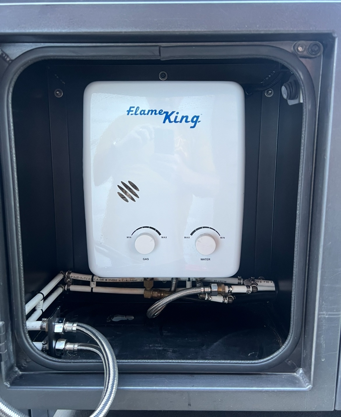

Update on the heater. I replumbed it but there is an internal leak on the heater core. Taking to Sasquatch to have the heater replaced this week.

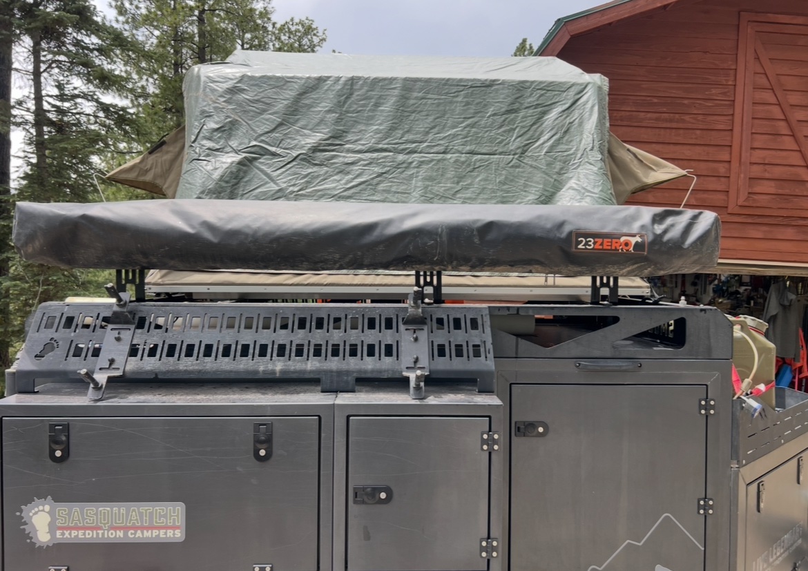

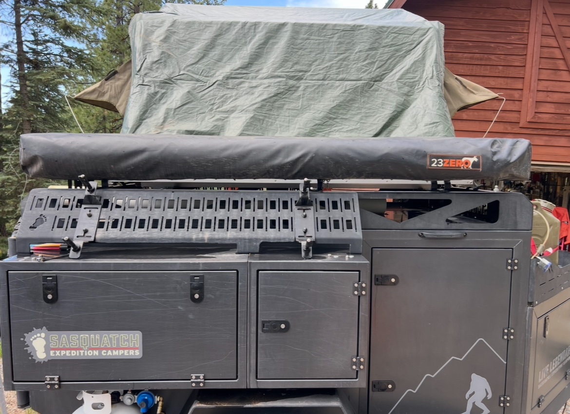

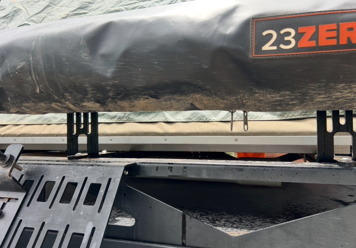

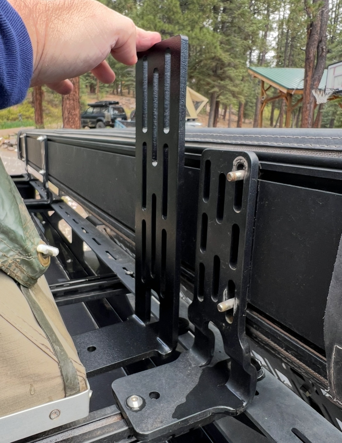

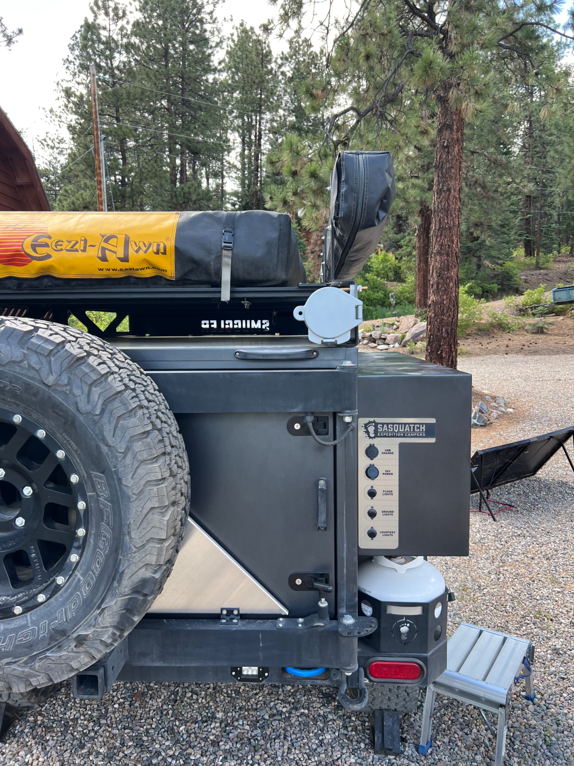

Continued prep for Alaska. I’ve always had a hard time unzipping the awning due to the tight clearance. I swapped in some taller mounting brackets today. Visually I don’t care for how high it sits but now I can get my hand in there. Plus the extra couple inches of height is nice as my head isn’t brushing up against it deployed. New brackets are from 23Zero. Totally overpriced but bolt on solution.
Before
After
Comparison

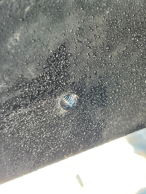

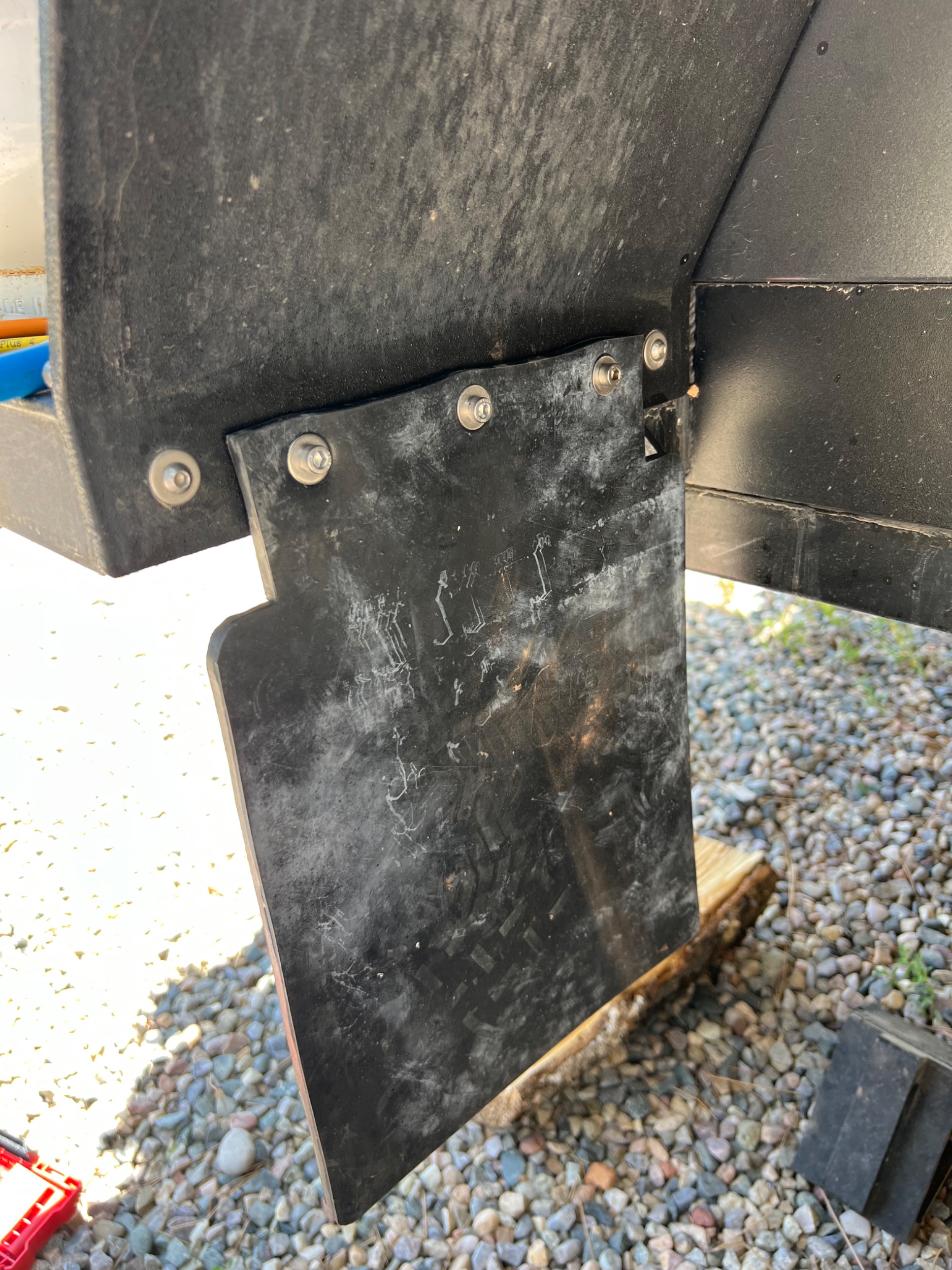

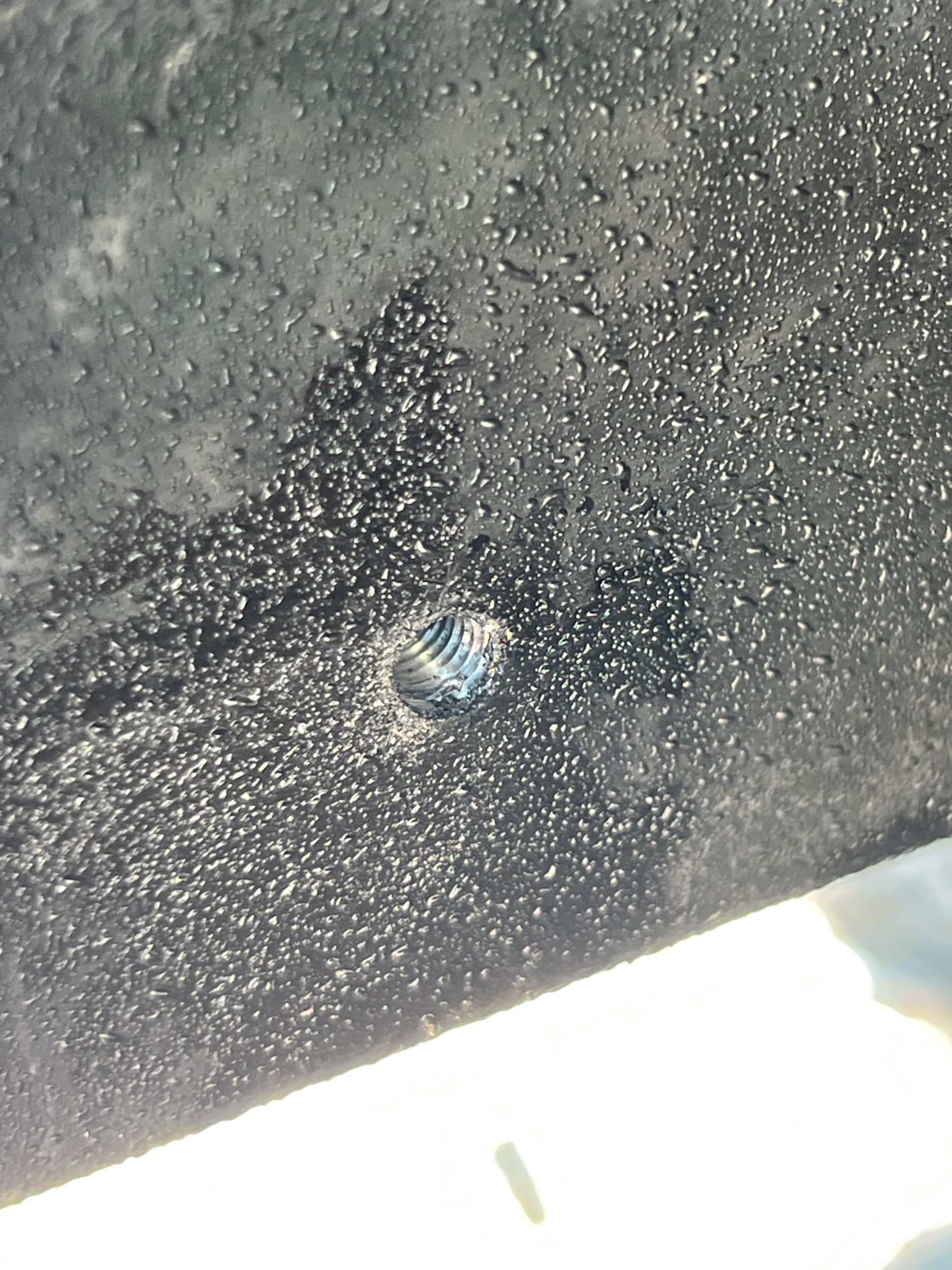

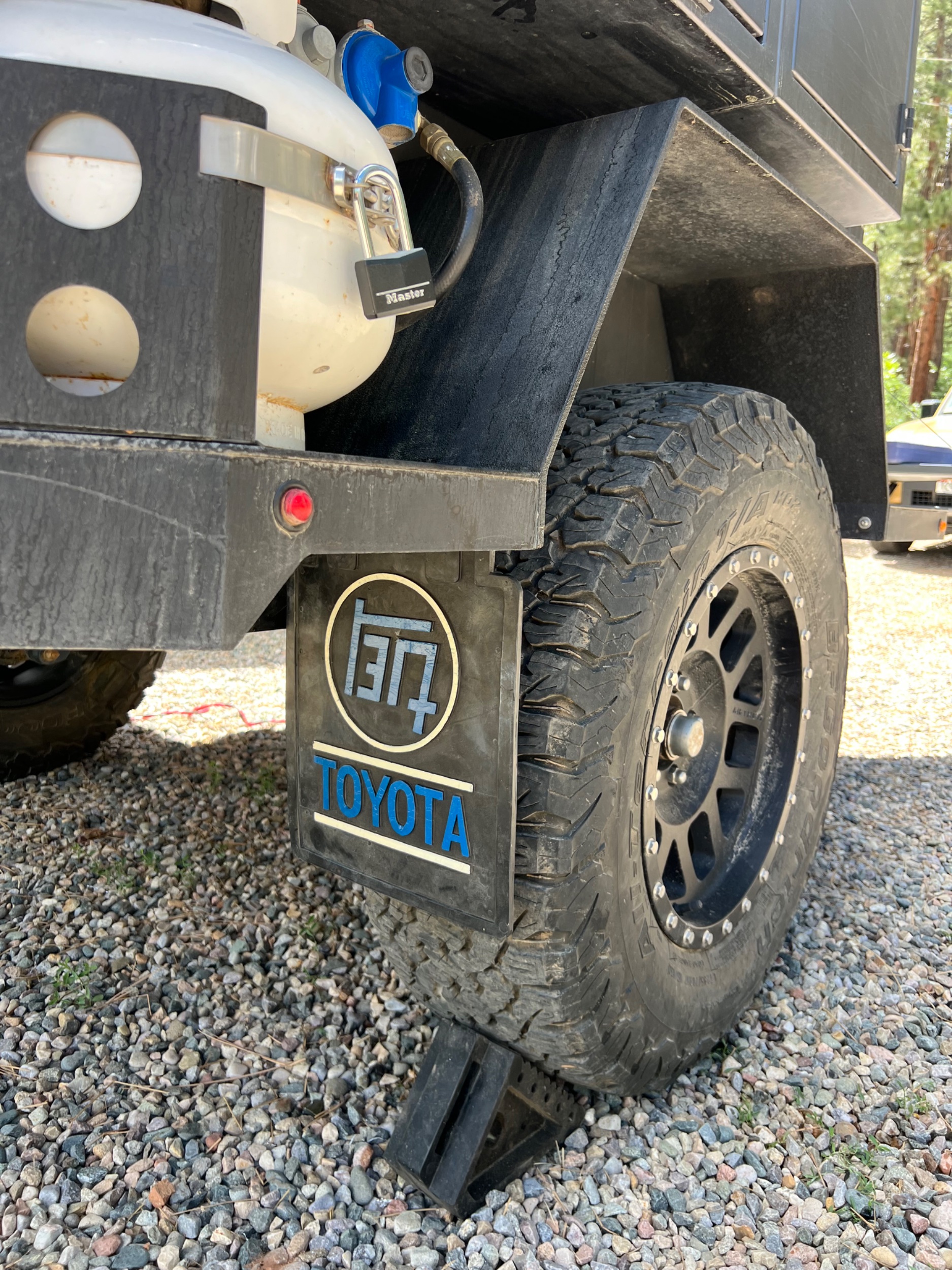

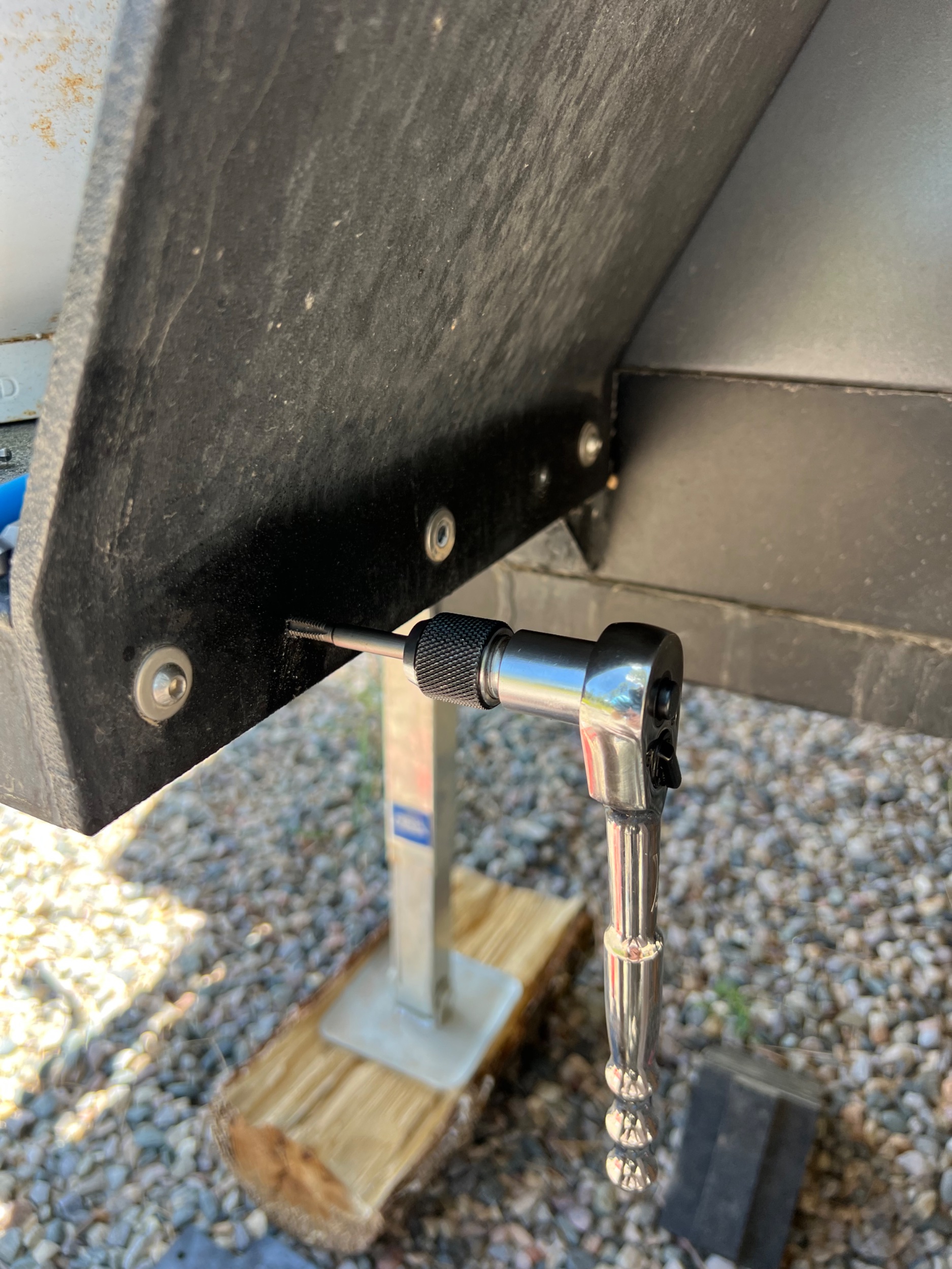

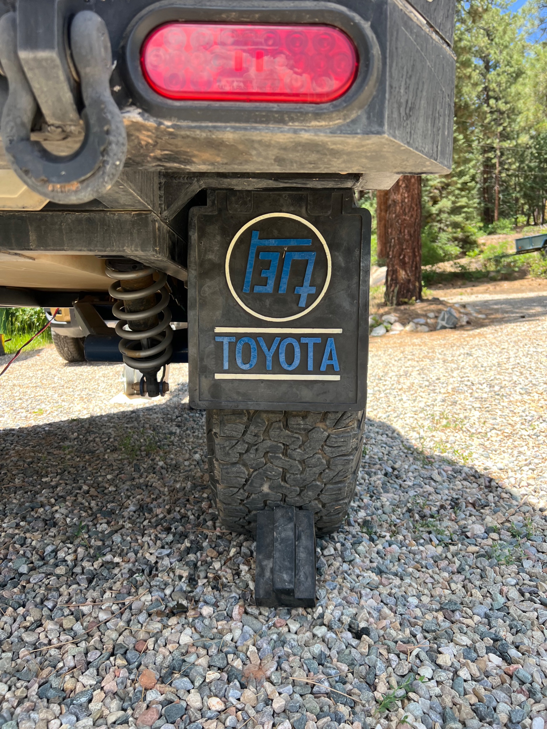

Wheels off today to service the hubs. Took the opportunity to add some mud flaps. Center bolt hole was existing. Drilled and tapped a couple more to bolt up the flaps.
