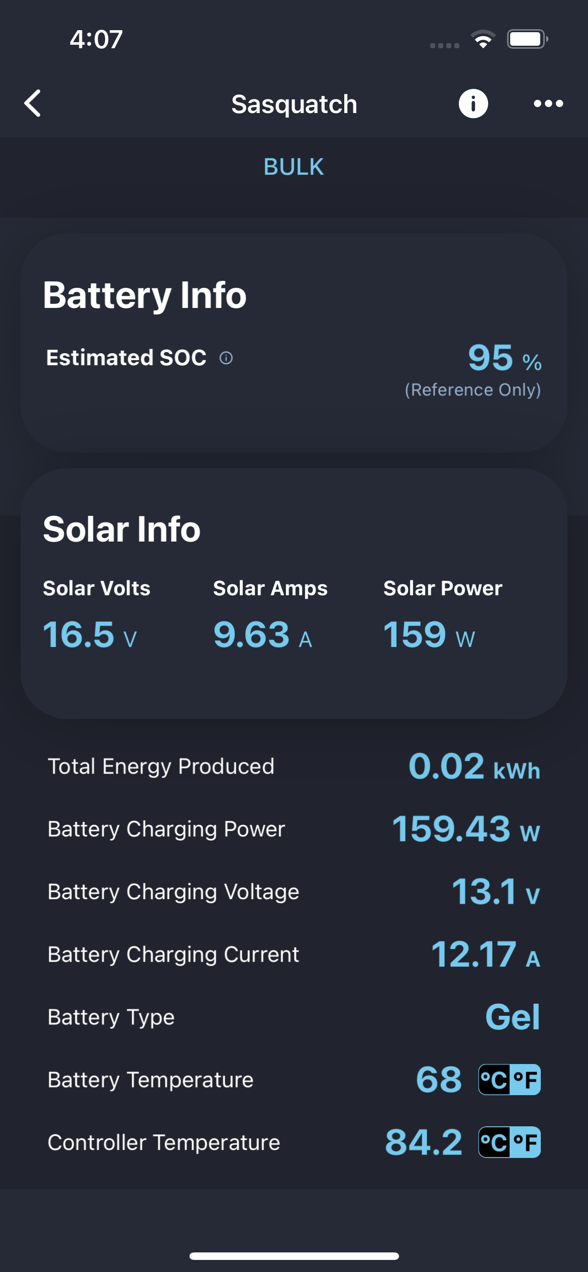

Did some work to the trailer today in preparation for the Train Run this weekend. Finished up my solar power install.
200watt Renogy suitcase panel
20A Renogy River Elite MPPT controller
25ft 8AWG extension cord for panel
BT-2 Renogy Bluetooth Module
This should be enough power to run the trailer indefinitely. Fridge/Freezer, water pump and lights are my only draws currently. I went with a large enough panel in case I decide to add more electronics in the future. Like a stereo or HAM radio.
I could plug in a blender or battery charger for tools/RC cars to the inverter. I’ve considered hard mounting a Makita battery charger. Any of those would of course draw more power.
charge controller in nose cone compartment with other electronics.
200watt panels
Info displayed on my phone app with the Bluetooth connection.

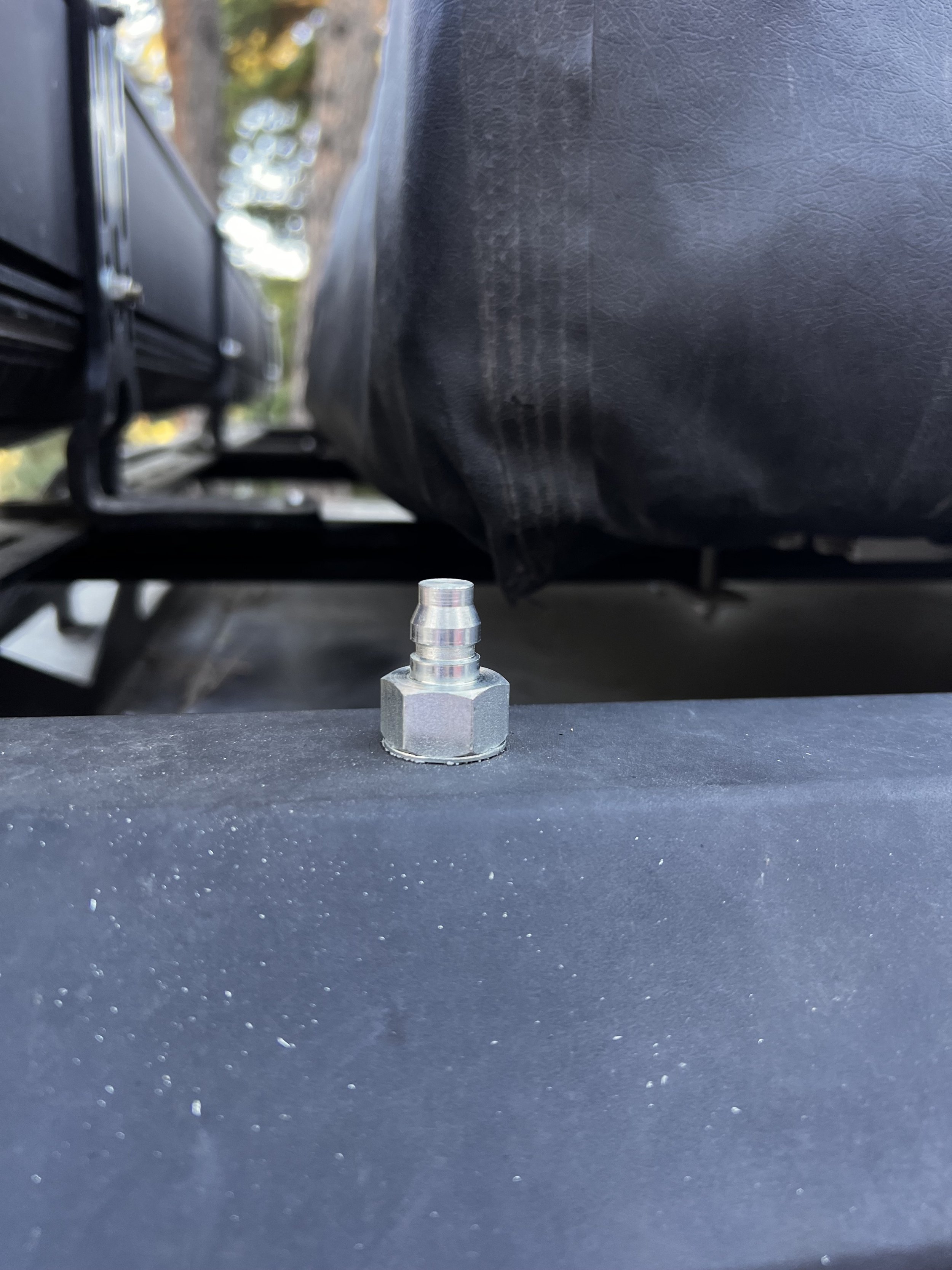

During my Easter trip this spring the fridge plug fell out once do to vibration. It was the standard 12v cigarette style. So I solved that by swapping to an Anderson Powerpole connector.
14,344
I assume you got the connectors from Powerwerx.
It might be of interest to know that the 1331-BK terminals (30A) they sell are the low force, which only means they take 3 lbs to mate/demate. If you're especially concerned Andersen does make a high force which takes 5 lbs but is harder to find as loose pieces. Of course with a ganged two position the force is increased, so it's very likely never going to be a problem.
However, there exists latches and things you can use to lock PP15/45 connectors together for higher reliability. The flush outlets don't allow us to use them but for higher importance connections you can leave a pigtail or something.
I only mention it because it looks like the outlet is pointed down, if so the weight of the cable itself pulls a little and slightly increases the chance that it could vibrate or get pulled out. A service loop with zip ties or velcro to something nearby can be a solution to such matters.

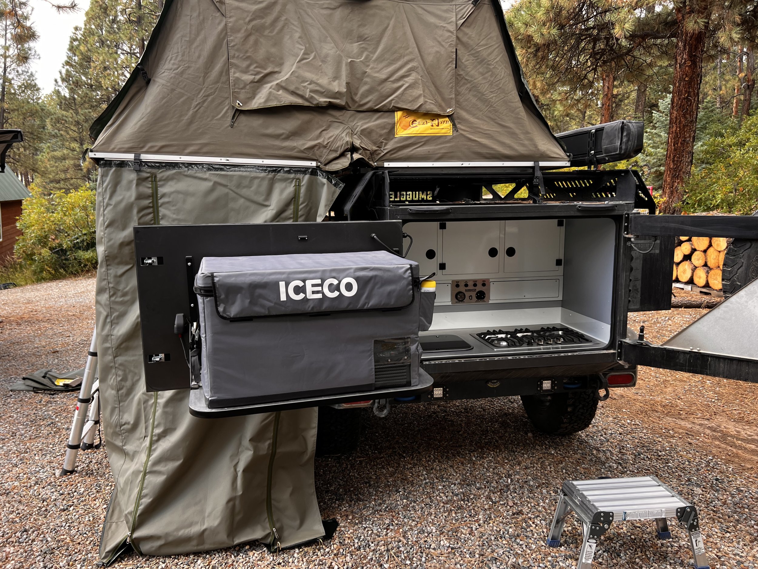

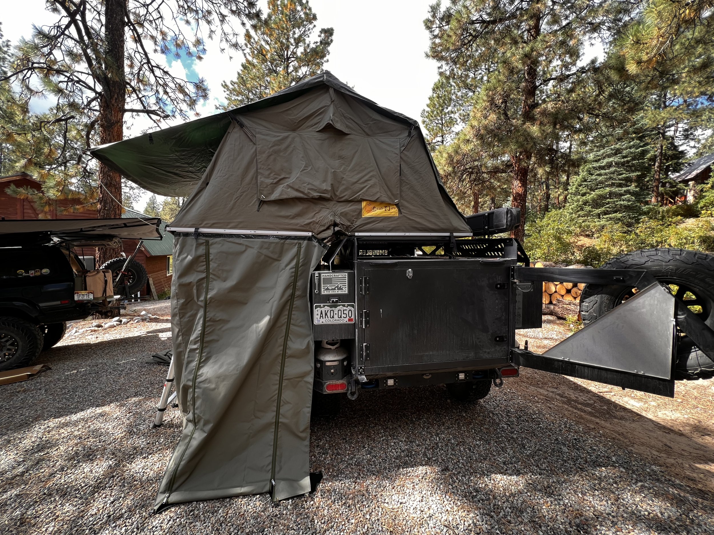

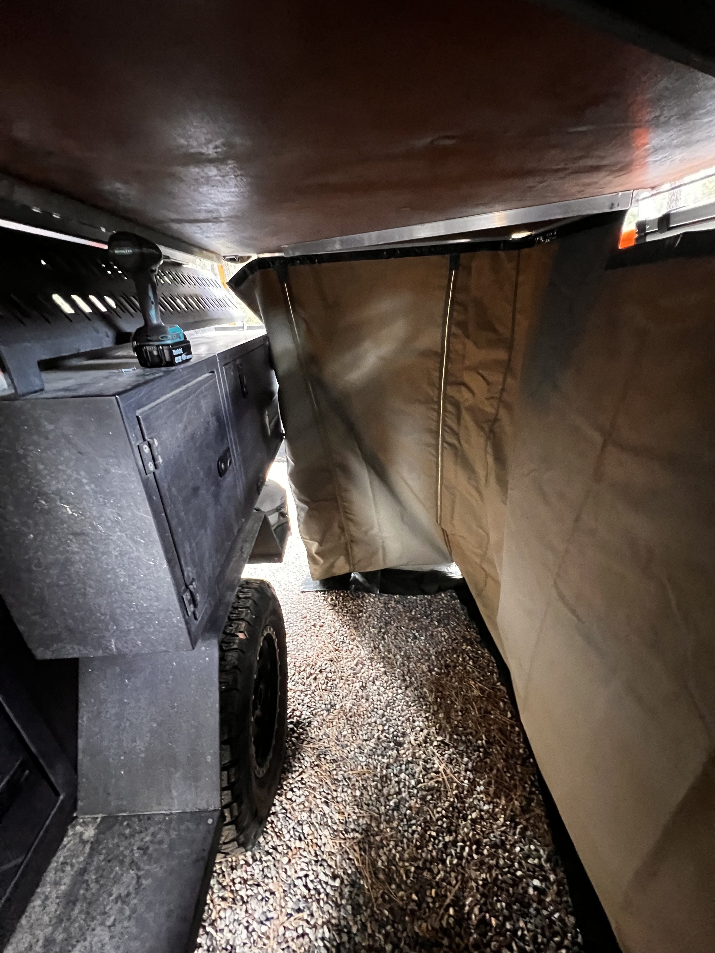

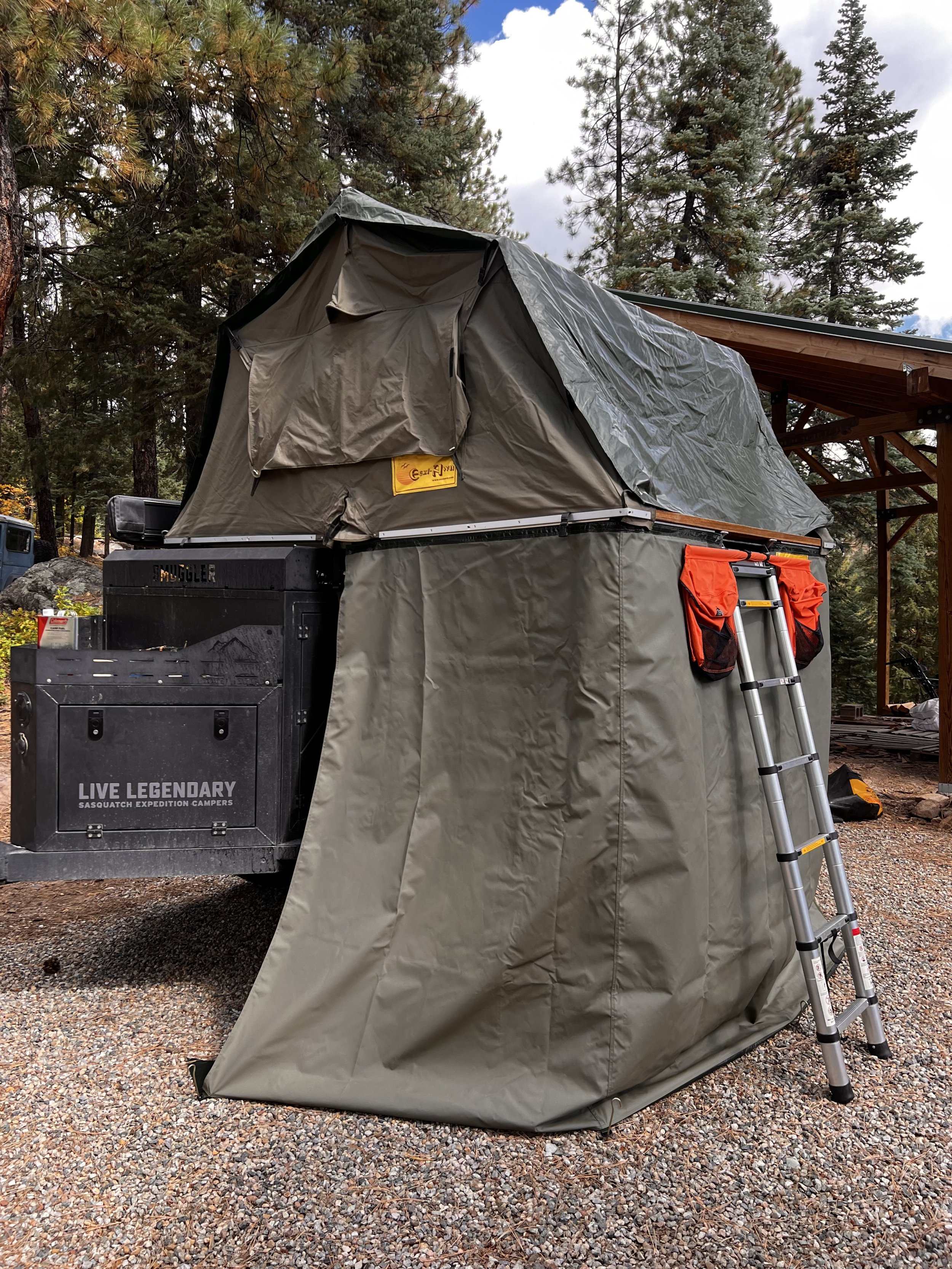

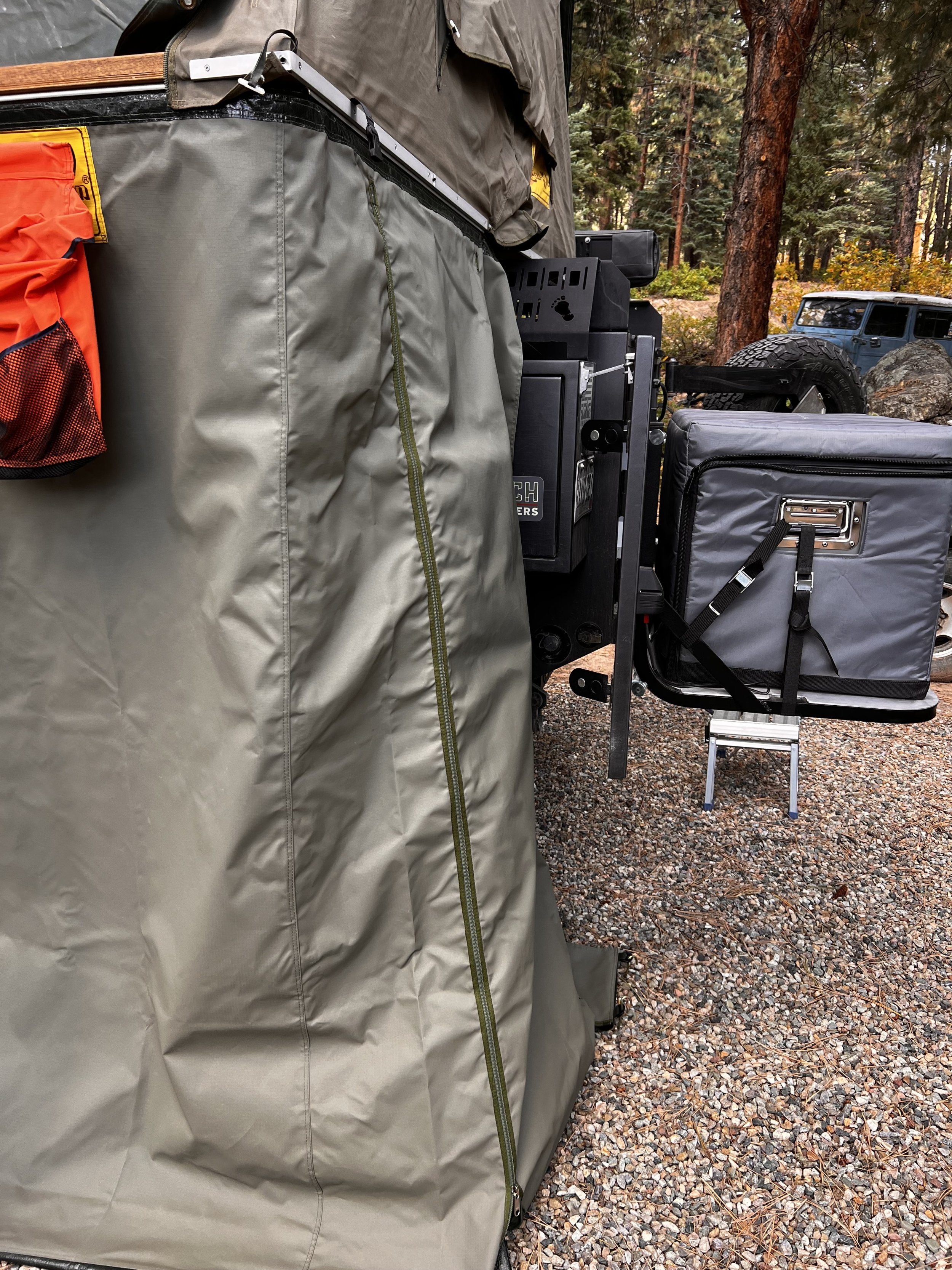

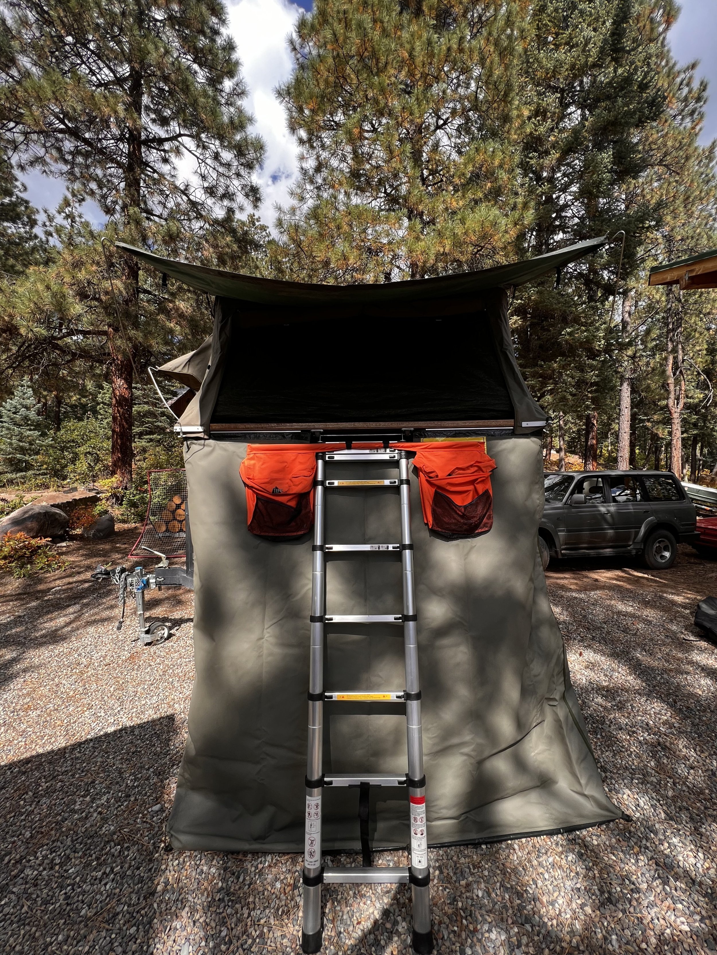

Picked up my Eezi-Awn shower room during Cruiser Fest after a 9 month wait. Eezi-Awn builds these to order so between that and a slow boat from Africa it takes a while. I expected the door to be on the left side based on photos on their website. It works on the right but I’d much rather have the door on the front side of the trailer. Also added my old Tepui shoe bags since my last report. 22 nights so far this year with the trailer.

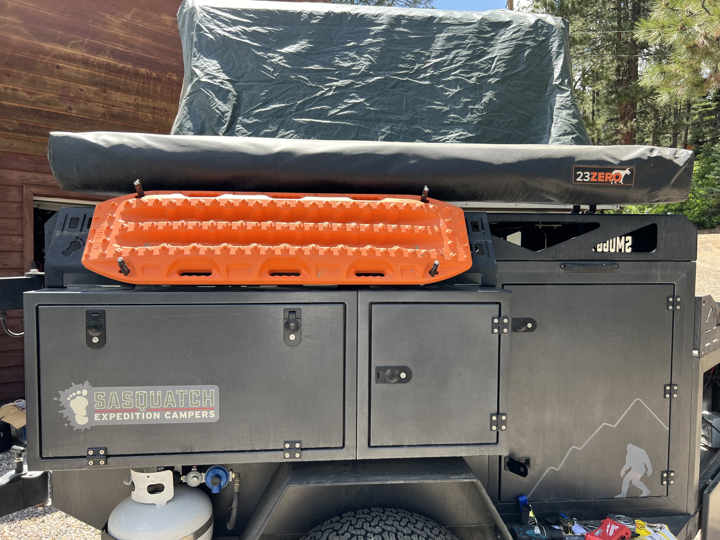

Maxtrax mounted. The pre-existing pattern did not offer a drill-less solution. 89cm is the distance between the pins lengthwise for reference. Used the Eezi-Awn k9 brackets.
