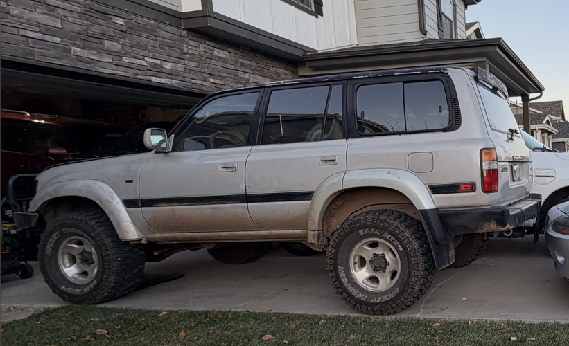

I've put 2 different suspensions on my 80 in the last couple years - first to accomodate 33" tires and then 37's. If I were going to start from scratch, I'd put in exactly what I have right now. Here's where I landed with around 3.5" and 37's:
Dobinsons C97-147VT 2.5" rear springs. Despite the advertised lift, they're still giving me around 3.5" of lift with a heavy bumper, dual swingouts and a drawer system. I like the variable rate in the rear. It's compliant but reasonably firm and doesn't feel dramatically different than a linear rate spring.
OME850J front springs + 10mm spacer. Cheap and effective. I don't notice any lack of balance w/ the linear fronts and variable rears and had heard some people on Mud complain about the way variables springs up front corner on the pavement.
Dobinsons "4 inch" IMS shocks. They're heavy duty and the damping is great. They cost more than a basic OME shock, but are less expensive than the remote reservoir options, which I think is a nice sweet spot. The length provides a nice balance of up vs down travel at this ride height.
2" bumpstop extensions: I went with the progressive Durabumps in the rear and have never felt a harsh bottom out. Some of that might be the heavy duty damping on the IMS shocks, some might be the progressive spring rate, and the then the bumpstops smooth out whatever is left. I couldn't use them up front because I'm running longer radius arms, so I extended the front factory bumpstop that sits inside the coil w/ a spacer from Slee.
And then I went w/ Delta 3L radius arms, a Delta rear panhard bracket, adjustable front panhard, adjustable rear UCAs, and longer brake lines. That plus some trimming of the fender flares and a BFH to massage the wheel wells allowed me to fit 37's w/o rubbing on a relatively low 3.5" lift. You definitely don't need more than that for 37's.

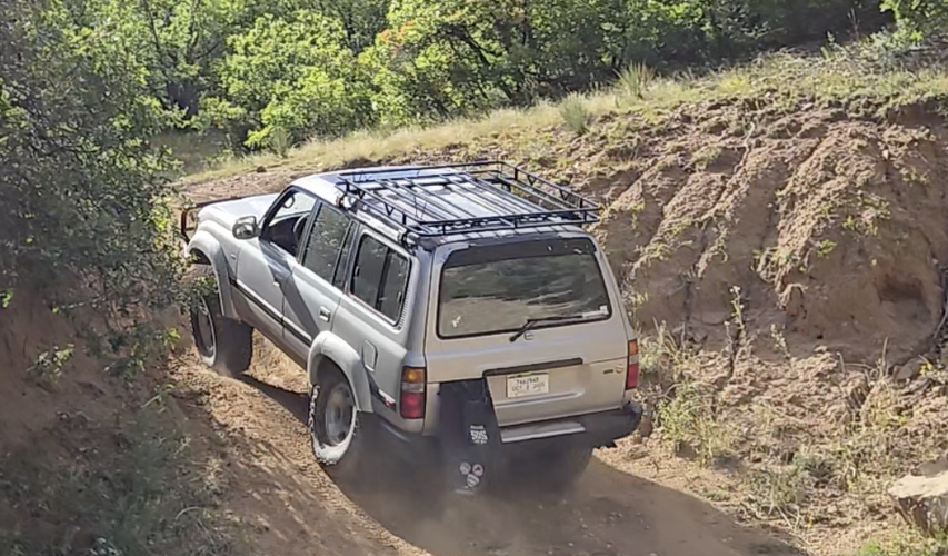

When I swapped in my LS, I decided to do a suspension refresh at the same time. Went with the Dobinsons 3" "flexi" coils front and rear (c59-612v/c59-613v) and Slee/ADS 2.5 shocks. In no way would I say I was disappointed by the change, but, I will say that it was much less dramatic of a change than I expected. I have quite a bit more body roll, a bit more flex (it wasn't really a limiting factor before...) and the ride quality is... similar, maaaaaybe better? I don't know. It's also quite a bit taller in the front, which I was not expecting (the engine/trans is a bit lighter) The shocks really come into their own on a long, very bumpy road though, I've never had them fade out on me. The old, non-reservior 2.0 fox shocks, would get soft after a while, you could actually feel the shock fade. The 2.0 resi's never really had the issue, but running the non reservoir rears I could start to feel the rig porpoise a bit (for lack of a better term...) after you beat it up on a very bumpy road. The 2.5's just don't in my experience. It always holds up. Even in the sand, which absolutely beats on the shocks and bumpstops with a big rig like these.
One change that I made at the same time that I can't say enough about is adding Perry Parts bump stops. These things are amazing. They're about 80% of the performance of a hydro bump, at a much lower price point, I really can't find a downside to them. If you want to spend the money and don't mind the noise, a hydro is awesome. But, if you want some of that performance in a traditional bump? These are the ticket.

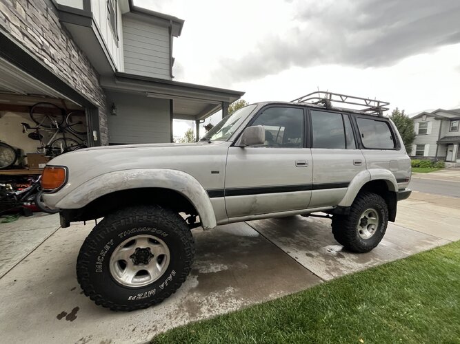

C97-146VT (65mm-2.5") Heavy Load
C97-147VT (50mm-2") 400-500lb Load
MS59-60687
IMS45-60912
2-2.5" is a CONSERVATIVE measurement as @Johnny Utah said to say the least. Honestly, didn't want this much, but we shall see how it looks with the new 315/70/17s and wheels. They are very compliant, flex a ton, but stink bug more than I want, even though the fronts say a 2.5 vs a rear 2"... In their defense, the winch, and ARB hanging off the front may not have helped the stink bug, plus dont have big ol rear bumper or carries either... One pic is no bumper and the other with one. (Sorry, I dont have better pics.) Also added the 80s run trip with all those guys lifts...
Pictured with the old Mickey MTs 315/75/16s
The shocks are a game changer. They EAT UP WASHBOARD. The best money I ever spent on a vehicle, plus they are rebuildable if you ever get to that point.
Like you, I was trying to stay 315/75/r16 but there were roughly 5 tires I was even considering, so I toyed with the 17" idea and the tire selection opened up quite a bit more. Happen to find some clearance Coopers I loved before, so went with those (plus Im cheap).
