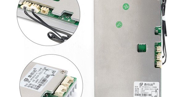

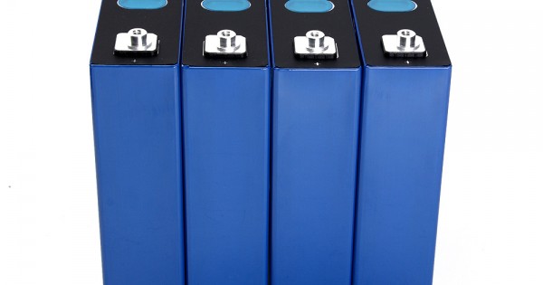

I came across this company the other day. As I understand it, they are one of the big importers of lithium batteries. Less than $600 shipped for a 230Ah battery with high and low temp protection and a built in optional heating pad port. The BMS allows for 200 amps so you could easily run a 2kw inverter. Seems like a pretty good deal. Weight would be about 40 lbs depending on the enclosure that you choose. These batteries are getting pretty amazing. At this price, the battery cells alone are about $158 per kWh of storage. It would be easy to build out a 30 kWh storage bank for a house for less than $6,000!
