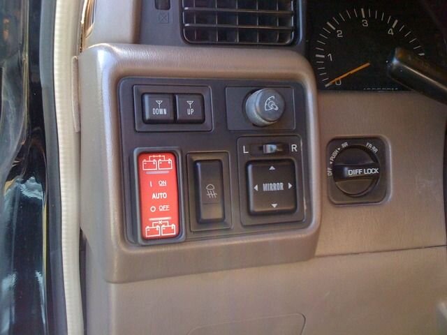

Marco,
Blanks on the left, ARE YOU KIDDING ME?
The antenna switch is actually the winch control via Slee's setup.

15,241
Man nice work on filling up the switches, you may have to just upgrade to a Land Cruiser center console after all, trade that little speaker in on 4 more.. :D

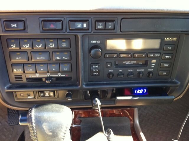

No more blanks :-(
My last blank position has been used for the 3 way selector. Gamiviti did not work for me because at the end I did not want to loose the JDM cap holder. So I installed the digital display in the ashtray. I can close the ashtray at night if the light bothers me.
I needed a 3 way rotary switch for the digital display since I am monitoring the two batteries and the digital filterminder yet to be installed.
All the wiring is done. I really enjoy seeing the voltage information. I can see how my ham radio affect voltage when transmitting, I can see how it drops when I start the car. I can see how the alternator pump 14.3V and then quites down to 13.8.
I really like all this information, but I am weired, I like to watch the progress bar when installing applications on computers. God help me......
