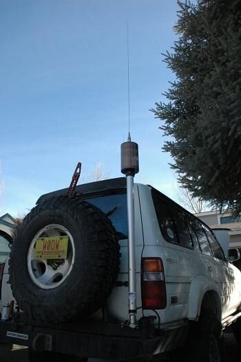

Does anyone know what Bruce is talking about here:
Bruce Miller said:
I hate to see any antenna mounted to the swing out tire thing or the rear bumper where the antenna is behind the truck. That's like transmitting inside a tunnel.
But in the attachment, I see a rear bumper mount. :confused:
