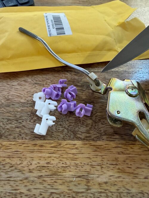

Been experimenting, refining the technique before I plate for @justcruisin. Apparently, if you spray it with sulfuric acid after the zinc bath, rinse, and yellow chromate, you end up with a better finish and adhesion, and it won't rub off easily. We shall see.
