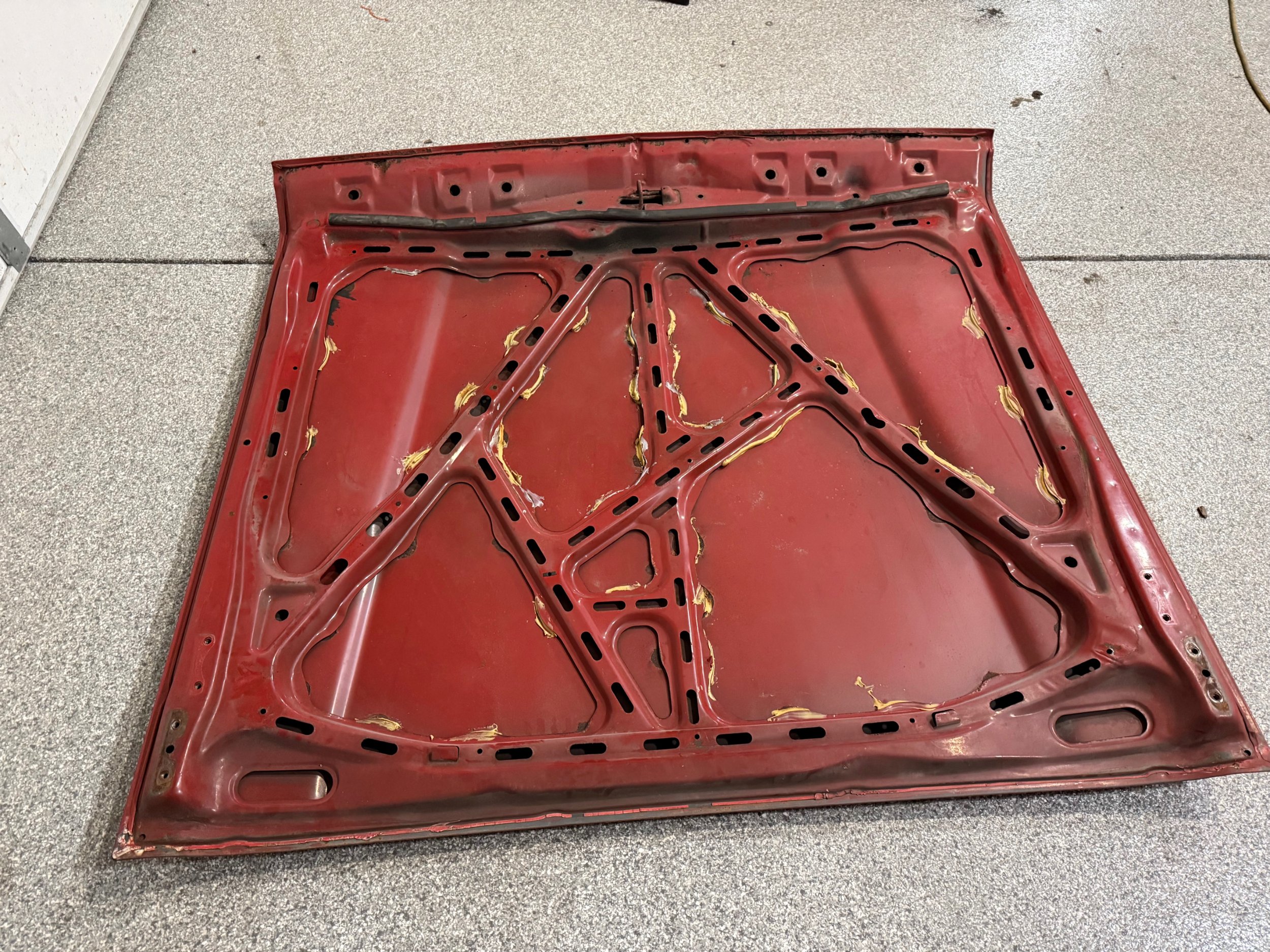

I would take the time to do it. The seal on my 80 is busted and the top of the hood vibrates a bit.
Just dont have too many beers before like I did. Mine looks awful.
Also the white roof looks badass with the paint job!
Ayye, I just saw your post on Mud. What material did you use? I got the Eastwood seam sealer, but also bought 3M 08365 Beige.
RDub
Feb 9, 2021
513
Boulder, CO
Maybe get a look at another 60 hood first. You like to keep things looking factory.
IH8RUST
Jun 13, 2024
552
Found it. I think they had one too many beers.
IoN6
Sep 2, 2019
1,398
Liquid nails!?
IH8RUST
Jun 13, 2024
552
Found it: 3M Flexible Foam 08463
Factory matching based on the online notes/images/car community posts, including one of our own on YouTube.
RDub
Feb 9, 2021
513
Boulder, CO
I thought the sealant gets applied prior to paint at the factory. Do you have touch up paint to color match after applying it? I know it will be under the insulation pad and out of sight…
IH8RUST
Jun 13, 2024
552
Same. Seam sealer goes on after epoxy, then the paint. My old hood had it on top of the paint and nothing stops you from applying over the new paint, just looks ugly.
I’ve got about a quart of the red, can buy more locally since I have the exact code and brand as well. That said, the foam isn’t paintable, so I’ll just apply conservatively and not fuss over it once covered.

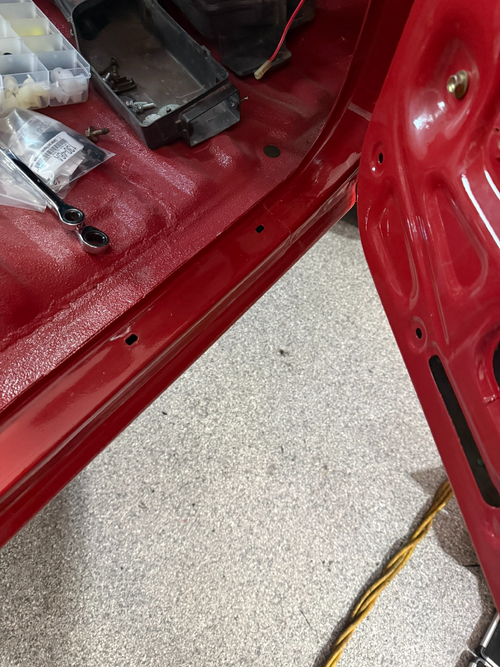

I truly wish the diagrams were just a tad bit better, so I wouldn't have to ask. I used a caliper to measure, went online searching, the kit didn't include a fit, kept searching on the parts websites, nope, can't identify, I feel dumb.
Gave up, asked on Mud. Part number for the grommet is: 90189-05012

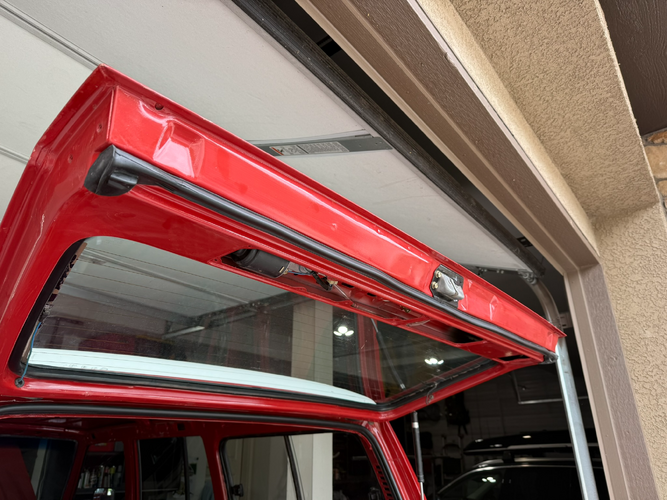

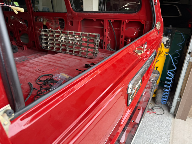

Bought all new sets of rubber seals. Slowly putting the pieces back together. Decided the lower liftgate could use a seal on the lip, turned out pretty decent, it'll help avoid paint chips. The upper liftgate has two parts: the bottom and the top. Doing the top seal while it's mounted is a bit of a chore. Also, ended up replacing the 12mm mount nuts all the way around. In hindsight, it made sense to replace before painting to maintain consistency; lesson learned.
The cool part is that when I shut the gates, there's a smooth, closing sound.

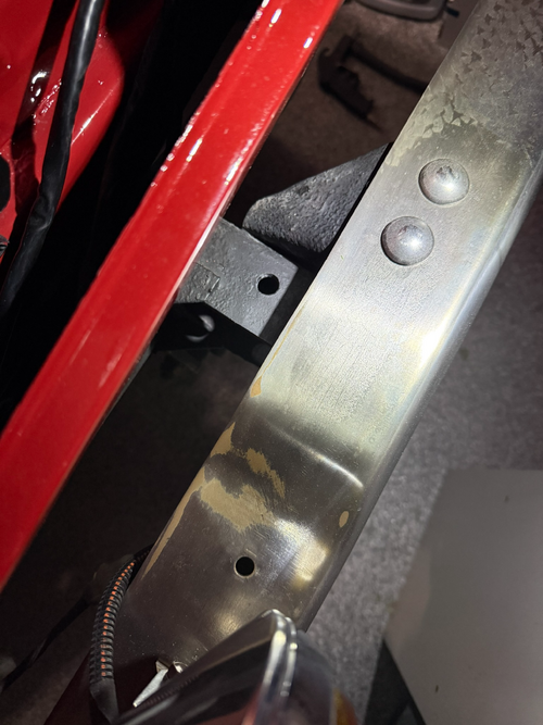

Just noticed the upper liftgate latch is all dull and grey, can't have that, time to bust out the plating kit.
