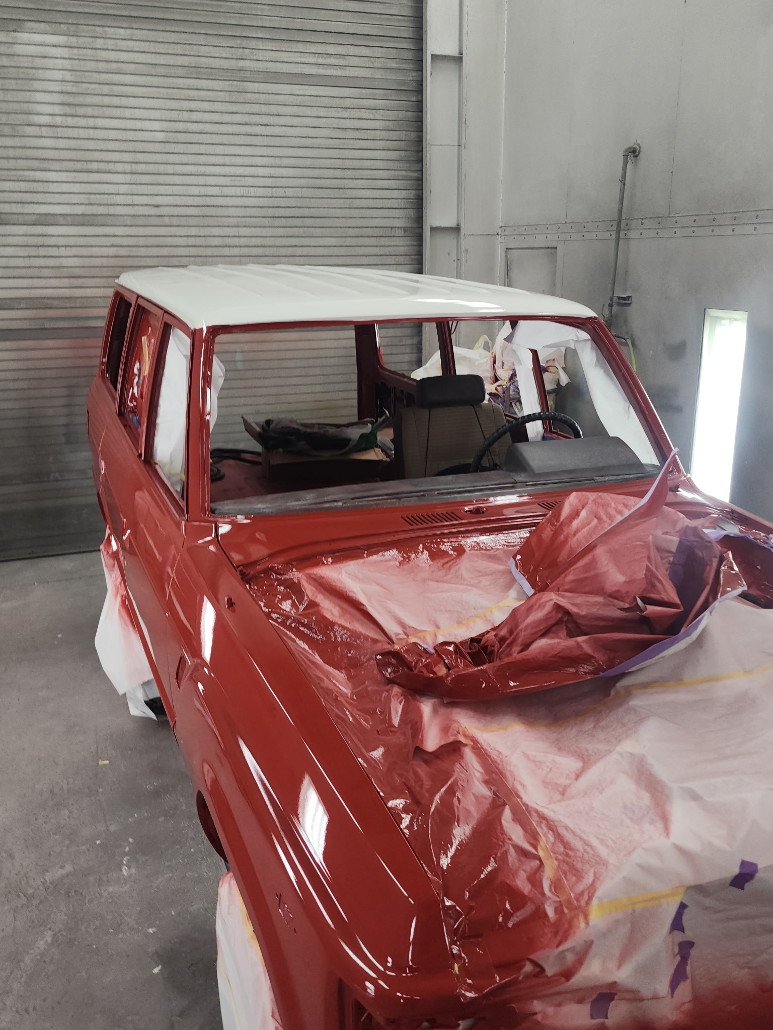

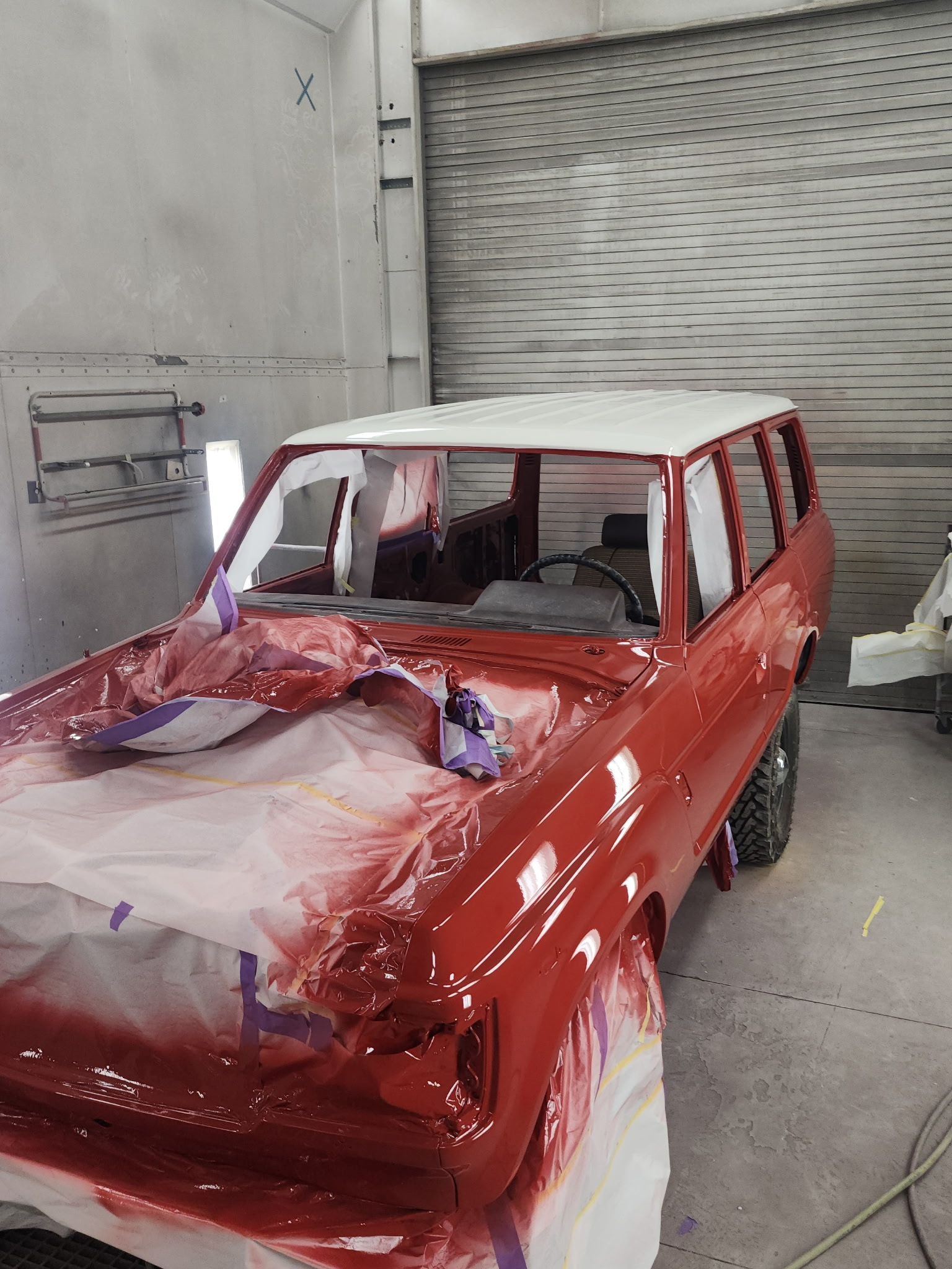

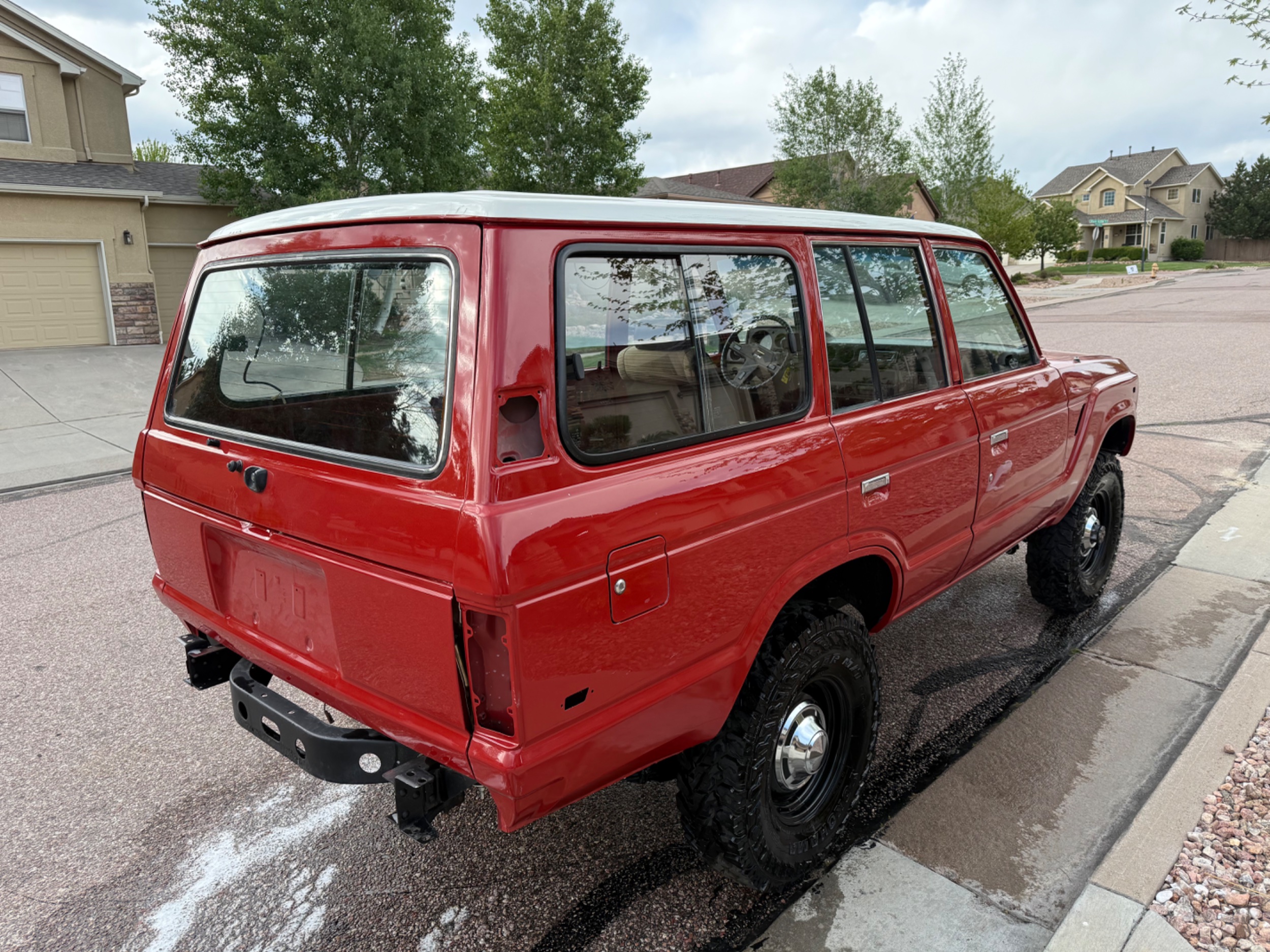

Lemme introduce you to my source of inspiration, Alton Brown's former FJ60: https://www.motorcarstudio.com/vehicles/775/1982-toyota-land-cruiser-fj60. I couldn't relent, had to have the white roof.
Let's celebrate when I get the Colorado Pin Stripping.
IH8RUST
Jun 13, 2024
551

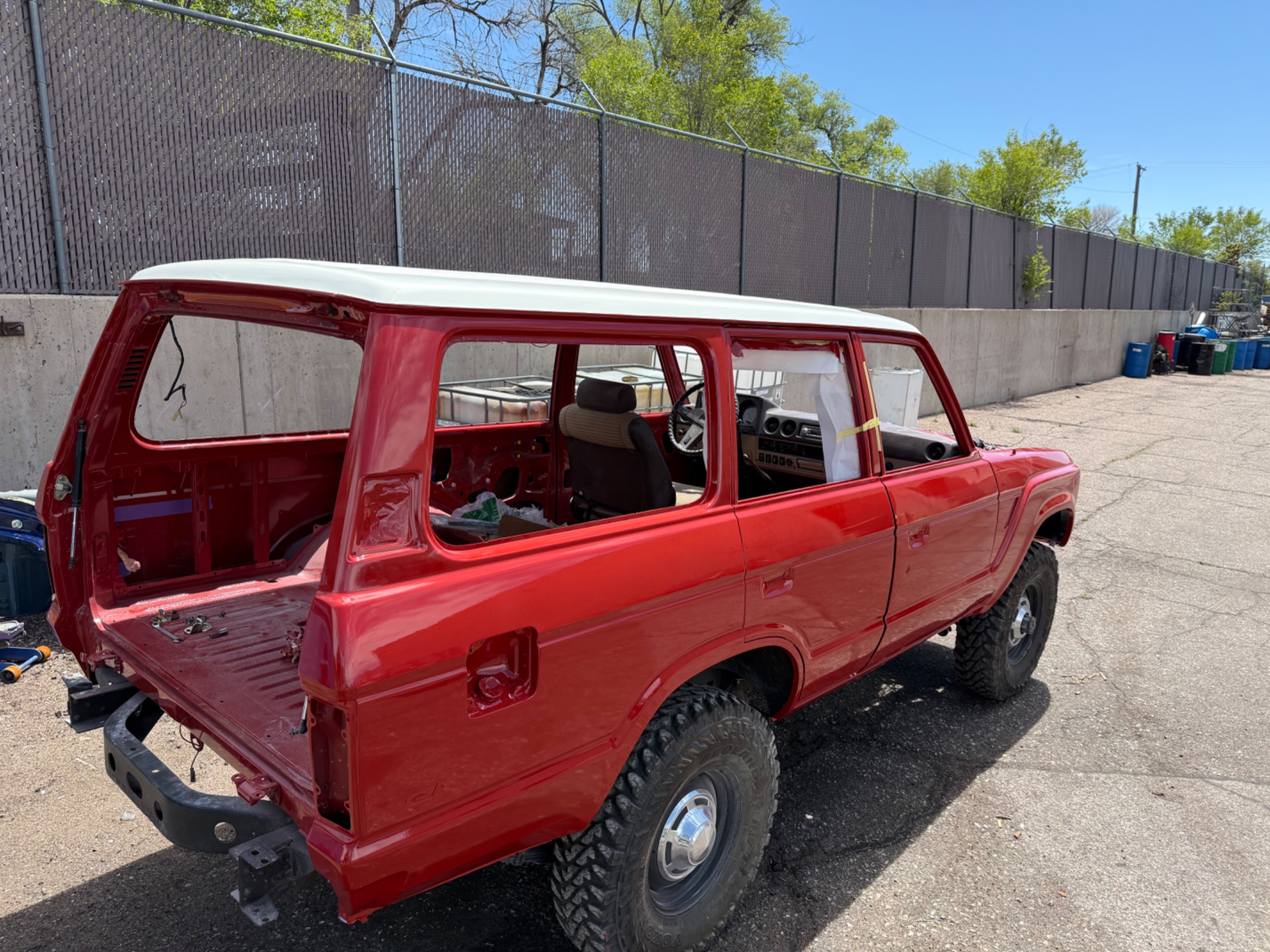

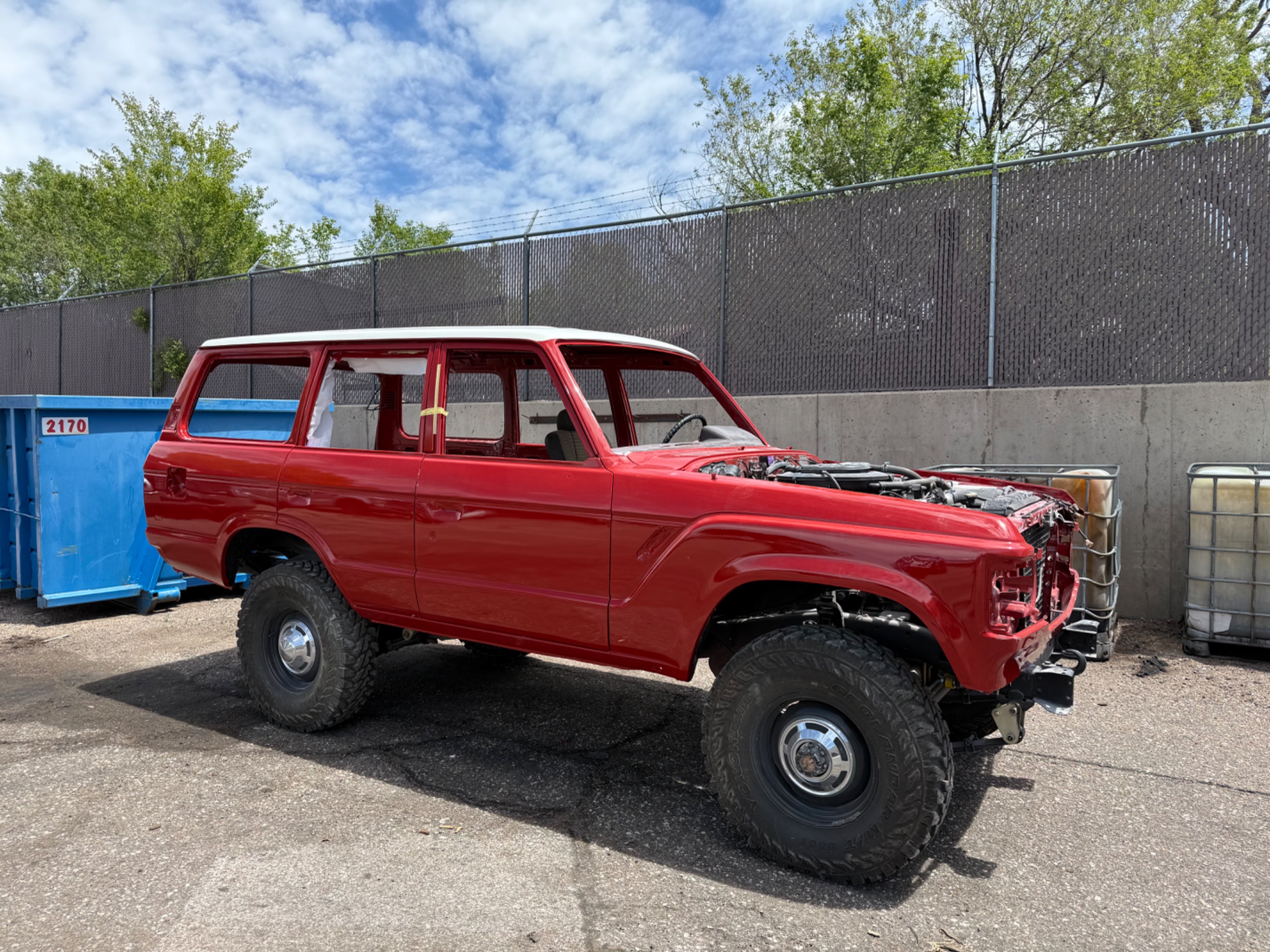

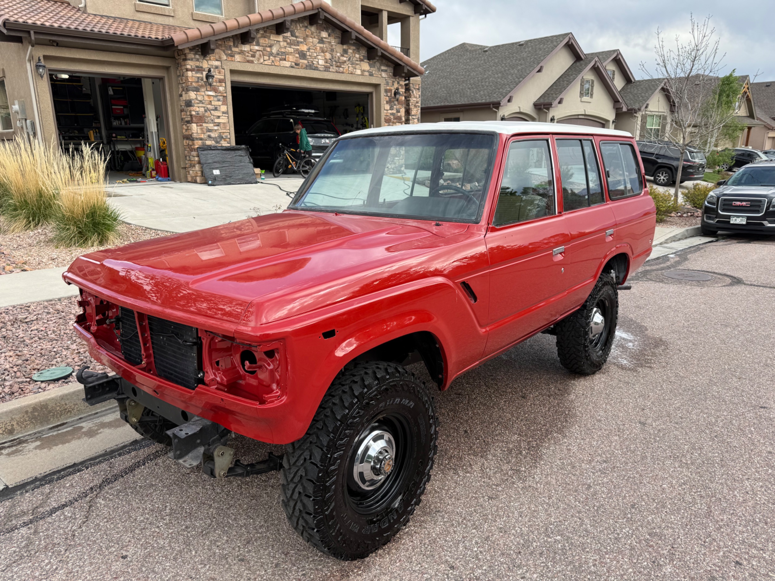

Here we go. A white roof.

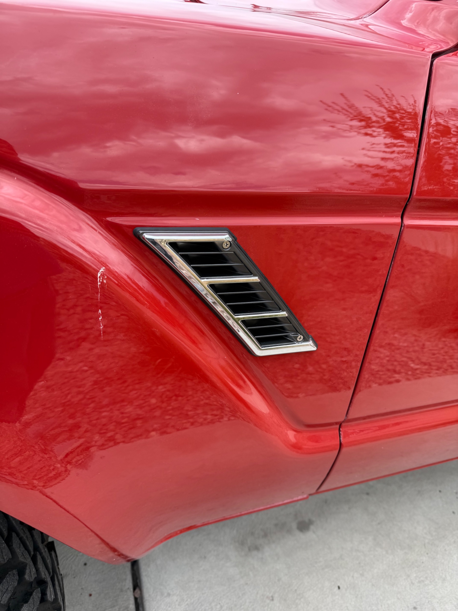

Aussie edition, @Capriblue45 inspired me.
Nice, i have the SOR version. Love them, but i did get a little leak which trapped moisture and caused some rust which I'll have to deal with. Would like to try another type and see if they seal better.

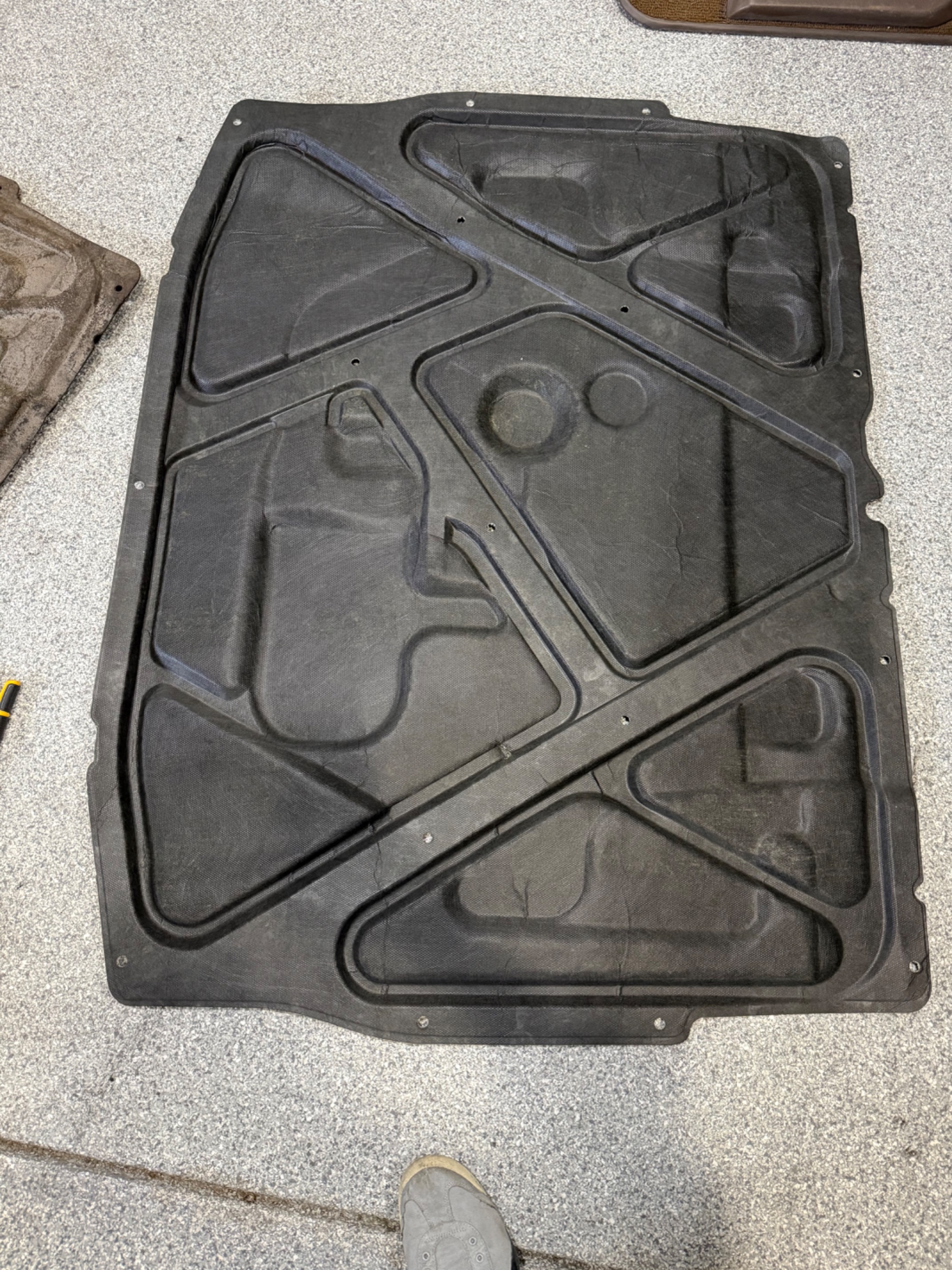

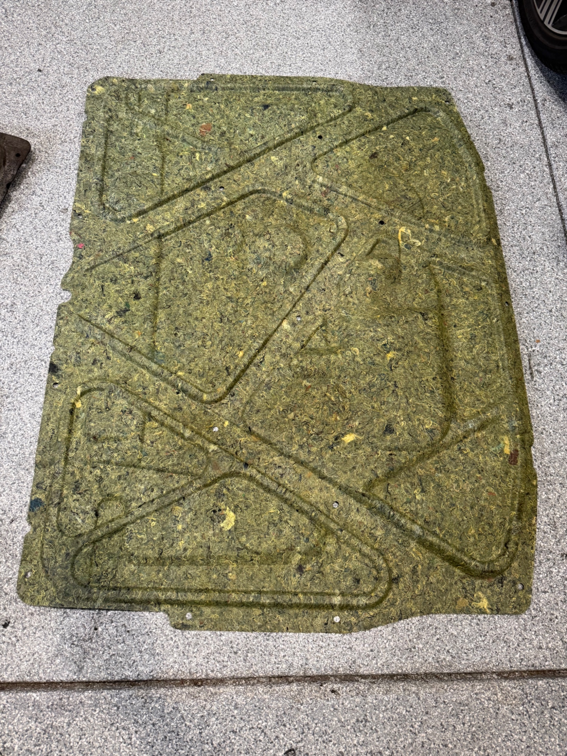

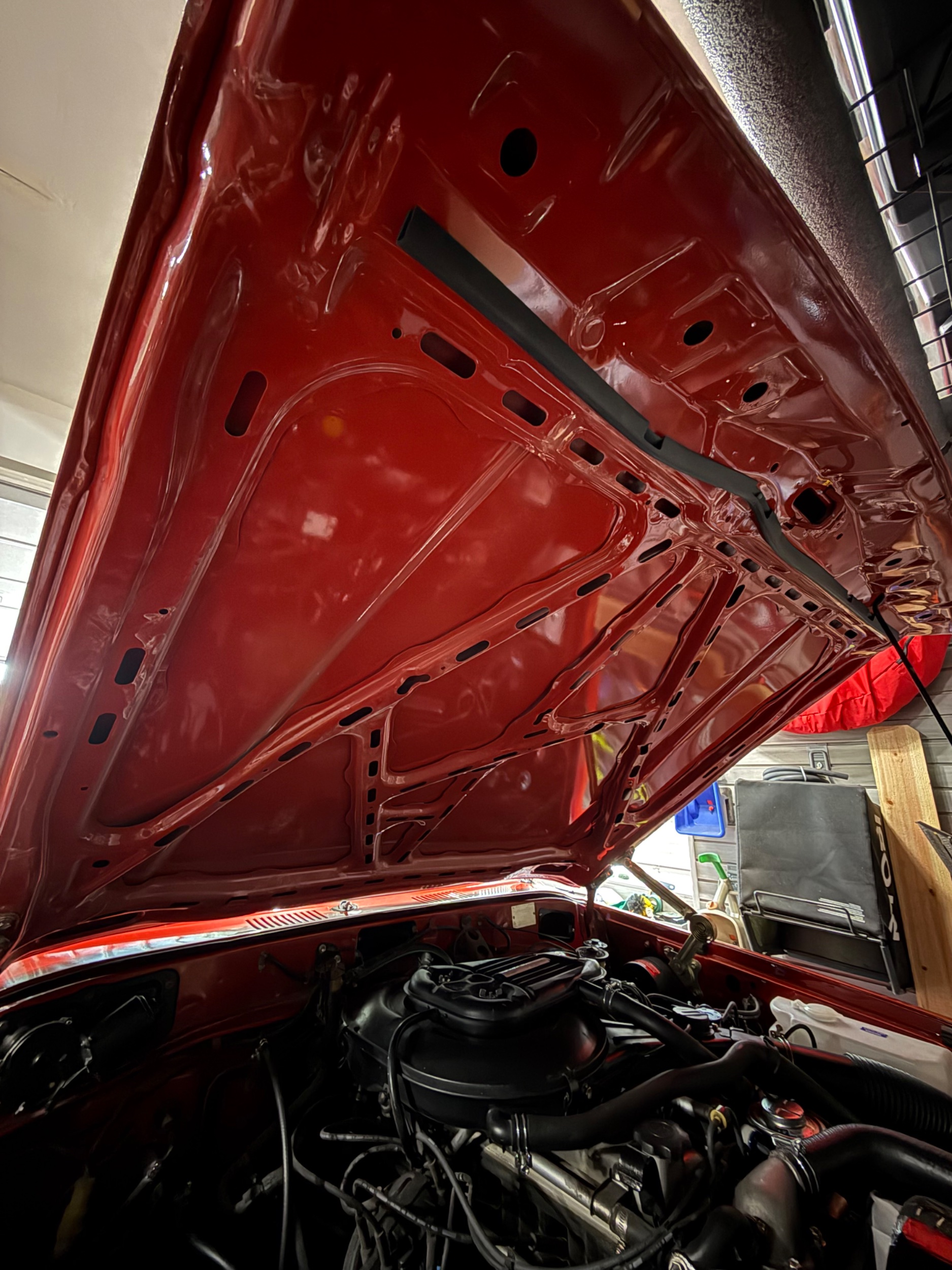

Went on to put on the new hood insulation, I distinctly remember sealant on there that’s not in the new hood. I didn’t imagine that right?
RDub
Feb 9, 2021
513
Boulder, CO
The hood support structure should be stuck to the hood skin with thick lines of sealant/adhesive that is applied in several places. Is that what you mean?
IH8RUST
Jun 13, 2024
551
Exactly what I mean! OK, sounds like I need to use a seam sealer on those.
KC Masterpiece
May 4, 2019
2,148
I would take the time to do it. The seal on my 80 is busted and the top of the hood vibrates a bit.
