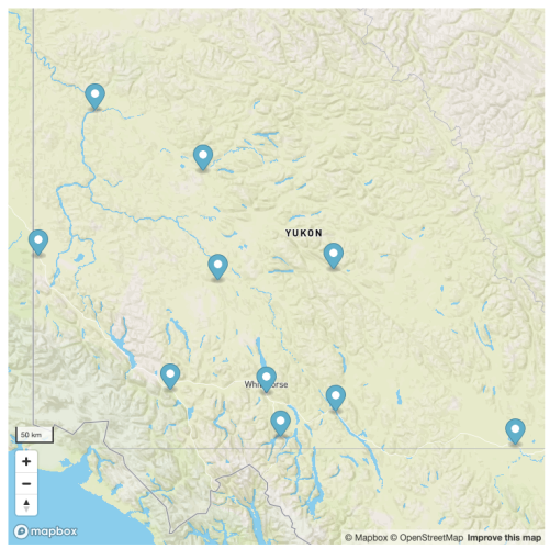

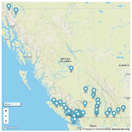

You're familiar with the Repeater Book?
https://www.repeaterbook.com

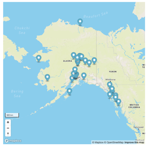

There are 114 amateur radio repeaters in Alaska. Many are in towns but not all. Same with B.C. and Yukon. It's likely everywhere you might drive or camp on your trip will have a repeater.
There are 6 GMRS in Alaska. They're clustered, two in Anchorage, one in Fairbanks, two near Palmer and on in Ketchikan.
