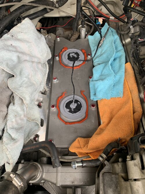

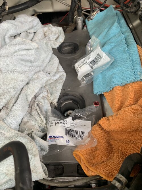

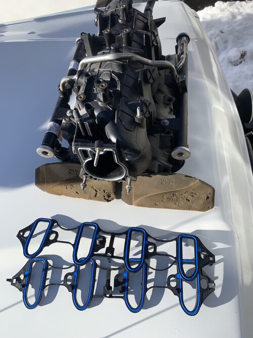

Ok, now I installed another set of knock sensors and very specifcly to torque specs. Meticulously cleaned The throttle body and intake manifold as well.
No change in code, just the same. Limp mode continues.

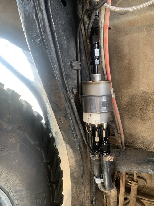

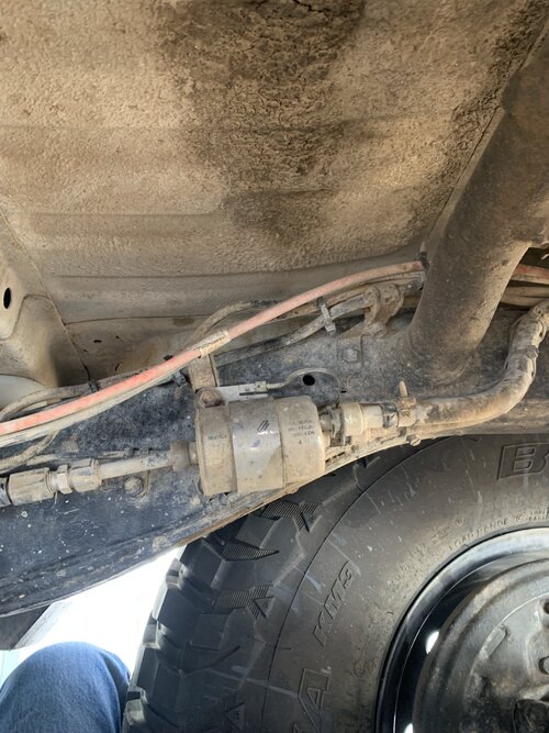

Well, the fuel pump running at 64-66 psi vs normally at 58 and recommended/ normal for this engine. Put in a new fuel filter and 58 psi regulator with AN6 connectors (lol, sounds easy doesn’t it). It has not changed a thing.

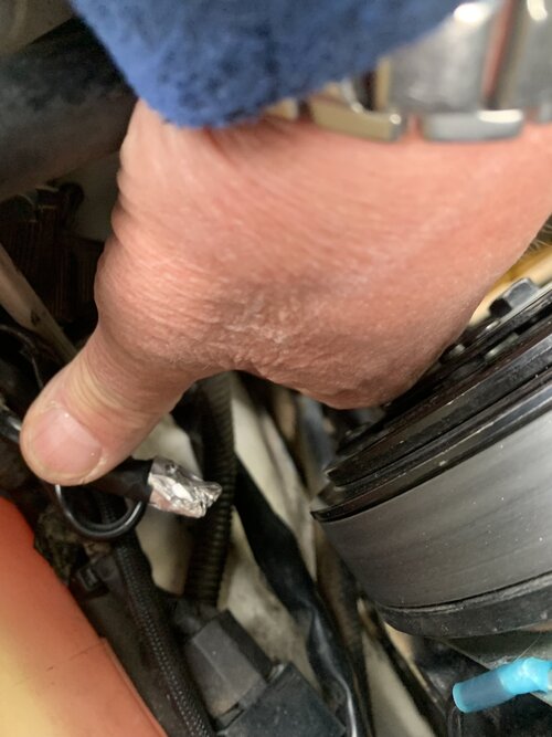

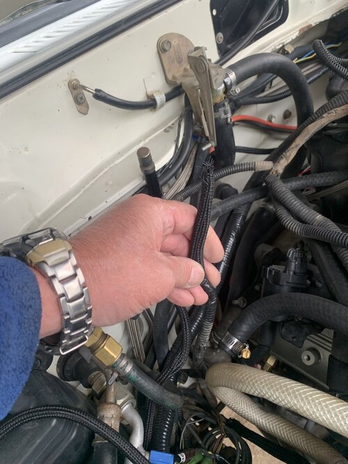

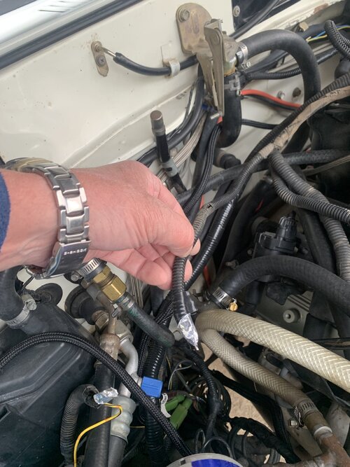

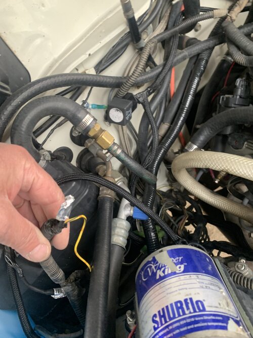

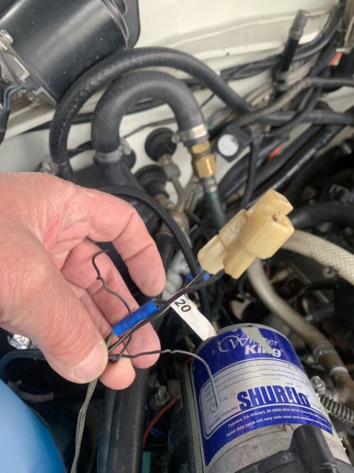

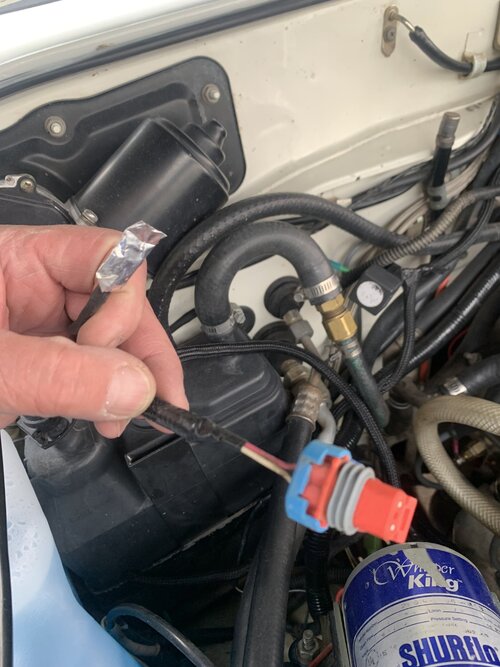

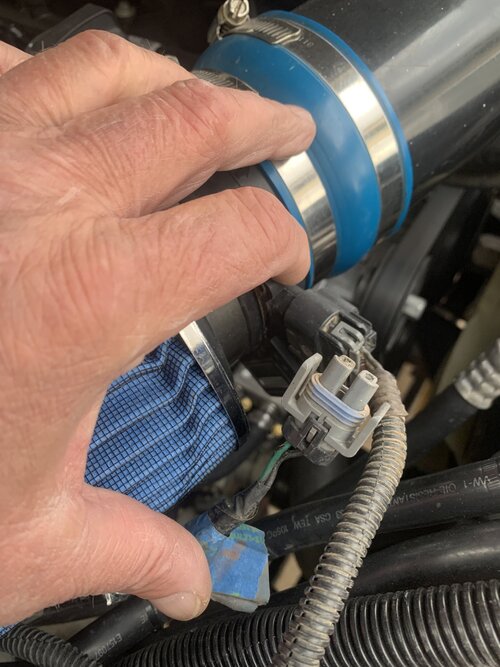

I can connect + to + and - to -, sums up my el skill level pretty much. Here is examples of wires I found cut. ECU 1 cut with a new connecting wire.

It’s almost like you have to start the wiring over again. The only part that looks familiar is the red plug. I think that went to the evap purge solenoid that had the little foam filter after it. Look around the charcoal canister. Is it throwing codes that you can read? That might start to clue you into what circuits are compromised.
Marco, your input is always very valuable to me, thought there was a connection loss. Reading build thread and my silly research, thought the Red plug was for a deleted VSS but properly wrong.
Been looking in to a Stand alone harness, but that is so stupid confusing to me. As I believe it's related to Transmission, type of Intake Manifold. I know I have a drive by Cable and the ECU connector is the Blue and not the Green version and that it is an EFI. That's where I am completely lost, I know if I could do that or get it done. That would be my most cost effective option.
A dyno tune may not be necessary then, I am only looking at MPG not HP. Cause that sucks right now, it was fantastic before.
Any thoughts or suggestions about harness Idea?

Im not sure what harnesses are the ones to get anymore but I feel like that setup may have been cut and diced so many times now that it may be a good path. The VSS is no longer used? Did the person that stuck the new motor in delete that?
Sorry on being non responsive just been busy and a bit absent since the 80 is a mess. Trying to get another cruiser and get my balance back. Wondering how you’d get a harness installed.
Does it show any trouble codes as is? If so which ones?
Cut and diced sounds about right, now even more. I did not learn about the VSS delete until after instal so I doubt installer did, but as cable was not connected likely he figured it out (but taped/marked connectors to MAF, Alternator and other basic ones can't be sure). Oh, I found wiring loom laying on exhaust pipe, opened checked all wires, appeared intact. Me and following a return to place secured it a little better.
Dang, so sorry to hear about the 80 I thought for sure it was up and running again. Yep, I know all about balance back.
Only code I've had is P0327
