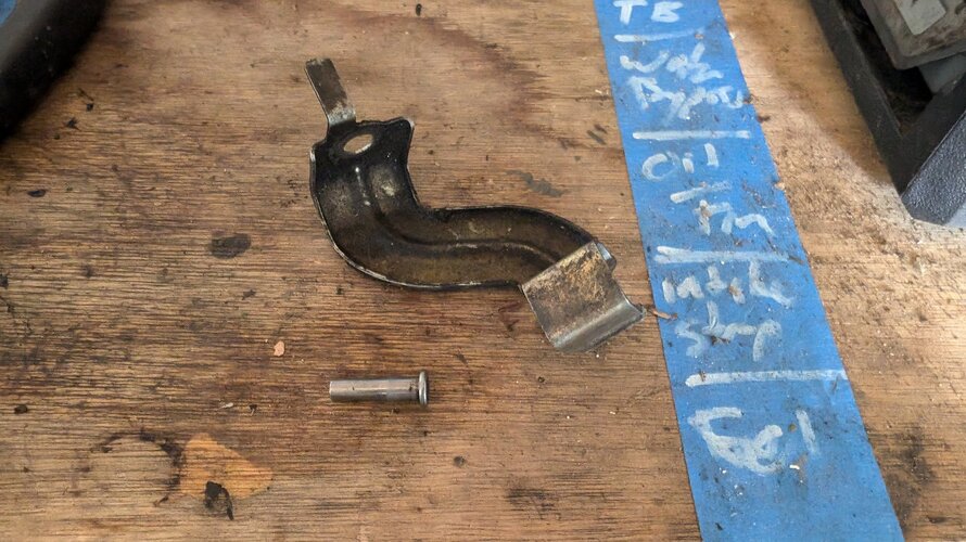

Finally got this this mostly together with only a few panicky calls to Jackson (thanks again!). I found this pin and it looks like it came from the intake somewhere. Anyone have an idea?
