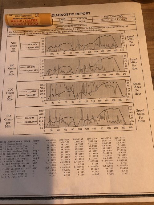

I’m still working out all the kinks slowly but surely. The VSV came in so I switched that out which has solved my p0401 problem. I also spent some more time diagnosing my center diff lock issue and was able to get it freed up. I don’t know if it was the switch I installed or if it broke free from putting it in low and driving back and forth. Either way it works now, so I am happy.
Since those problems were solved I decided to take it to get the emission test done. I half expected it to fail as the carfax revealed it failed and then passed last year. As a recap I’ve done plugs, wires, cap and an oil change. I also drove 30 minutes in 85 degree weather, had a fresh tank of 91 and idled it at 1500rpm while I waited for 10 minutes. As you can see I tested high for CO.
Ive posted in a different thread about what might reduce my CO and theorize it may be O2 sensors or that I need to add heet.

On an engine like the 1FZ using 91 might make your emissions worse than otherwise because the engine is low compression and low performance. You might actually have a significant amount of unburnt fuel because of that. Run 85 and send it.

After failing the last emission test i suspected that one of the 02 sensors was bad. I was able to read the voltage of both sensors with my ultragauge and the rear one certainly didn't seem to be reading right. I decided to replace both anyways and had them replaced with no issues. After replacing them the sensors were reading what I deemed satisfactory, so I filled up the tank with a mixture of 87/91 and went to get it tested. Fortunately for me it passed, an so it was determined to be the 02 sensor that was bad and causing me to fail. I find it strange that it didn't trigger a trouble code. Either way I am glad that it finally passed. I then went to the dmv to register it and place my order for the vanity plates. As one would imagine Land Cruiser, LndCrsr, and FZJ80 were taken so I requested 3x lckd as they said it was still available. After waiting a week the plate arrived in the mail and I am thrilled.
