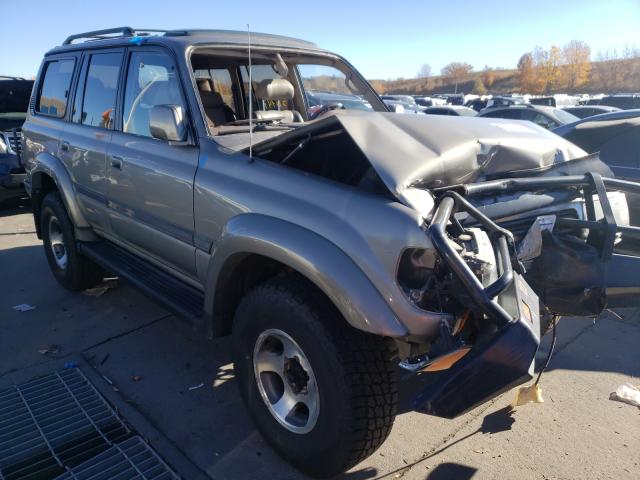

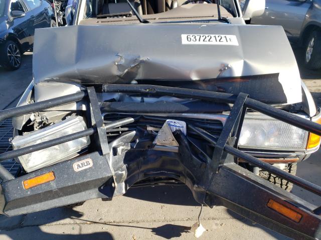

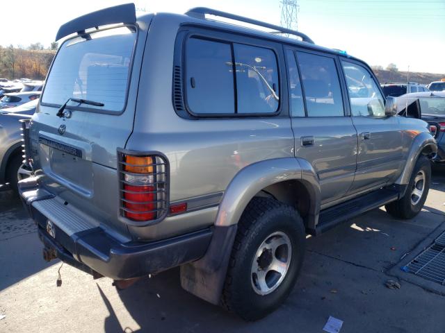

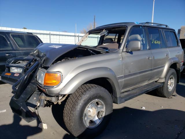

As the title states this is the build thread for my new to me 1997 3x locked 40th anniversary Land Cruiser. Having rebuilt a handful of cars from salvage I set out to find a suitable 80 series for my next project. I ran across this one at the local Copart and knew it was the perfect project. From the auction photos I could tell there was significant front-end damage that would need repair. The few things I was able to determine were: It was triple locked, it had 147 miles on brand new tires, It had a lift of some type, and it was a one owner truck out of Boulder. With these known items I set a price and waited for the auction, after a few back-and-forth bids I found myself the owner of this interesting new project. Below are the photos directly from the auction.. As is visible it is quite the project and I look forward to sharing the process as I dig into this project. The plan from here is to detail the process as I dissect and repair the damaged items.

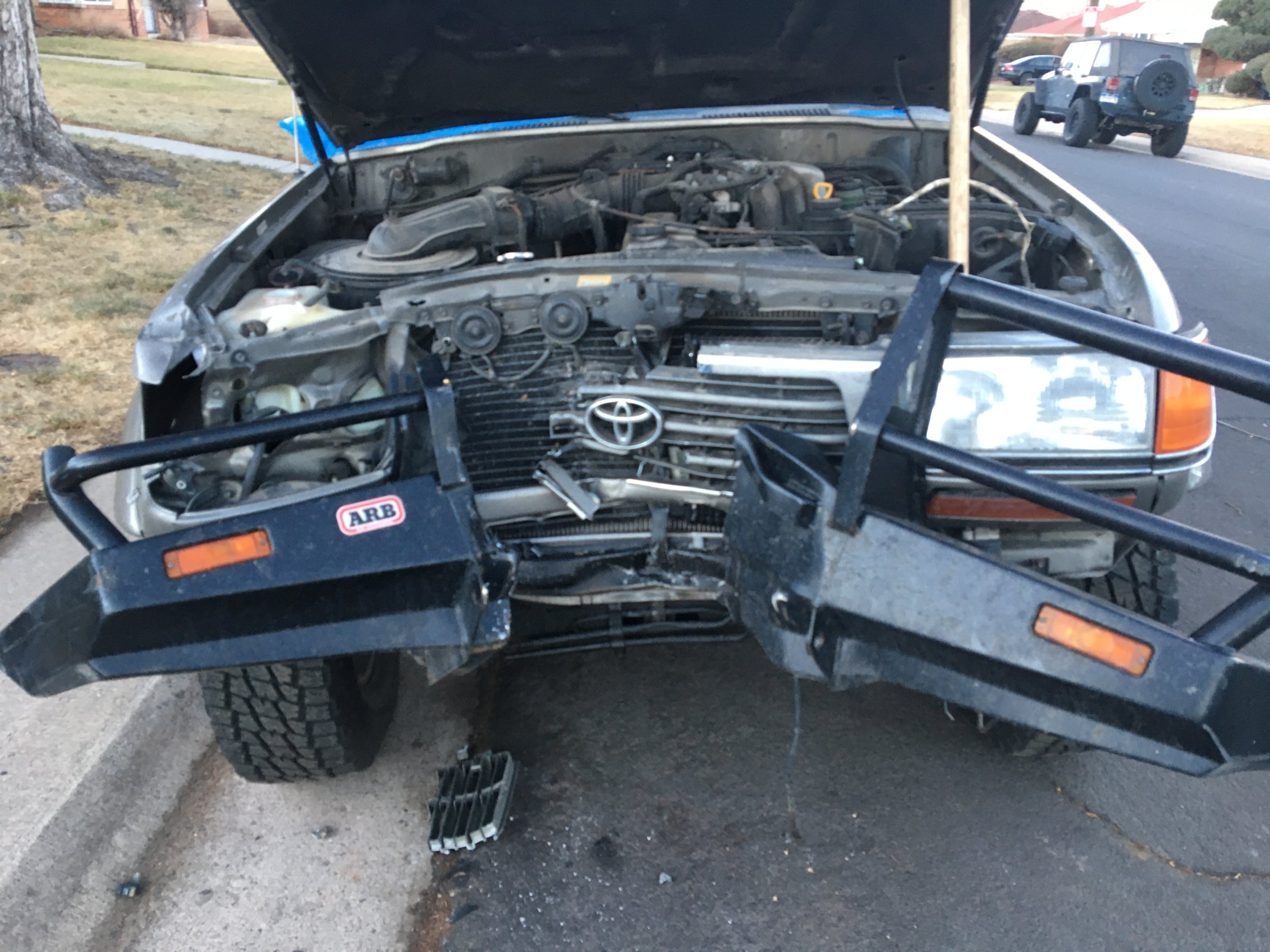

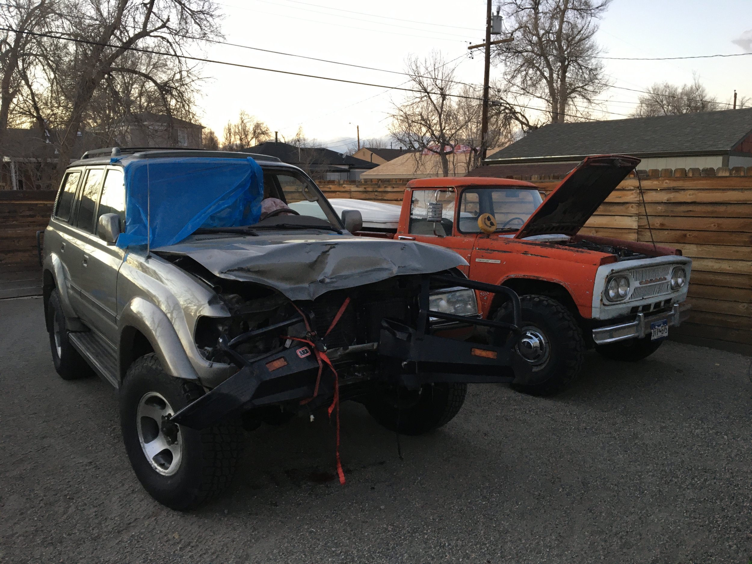

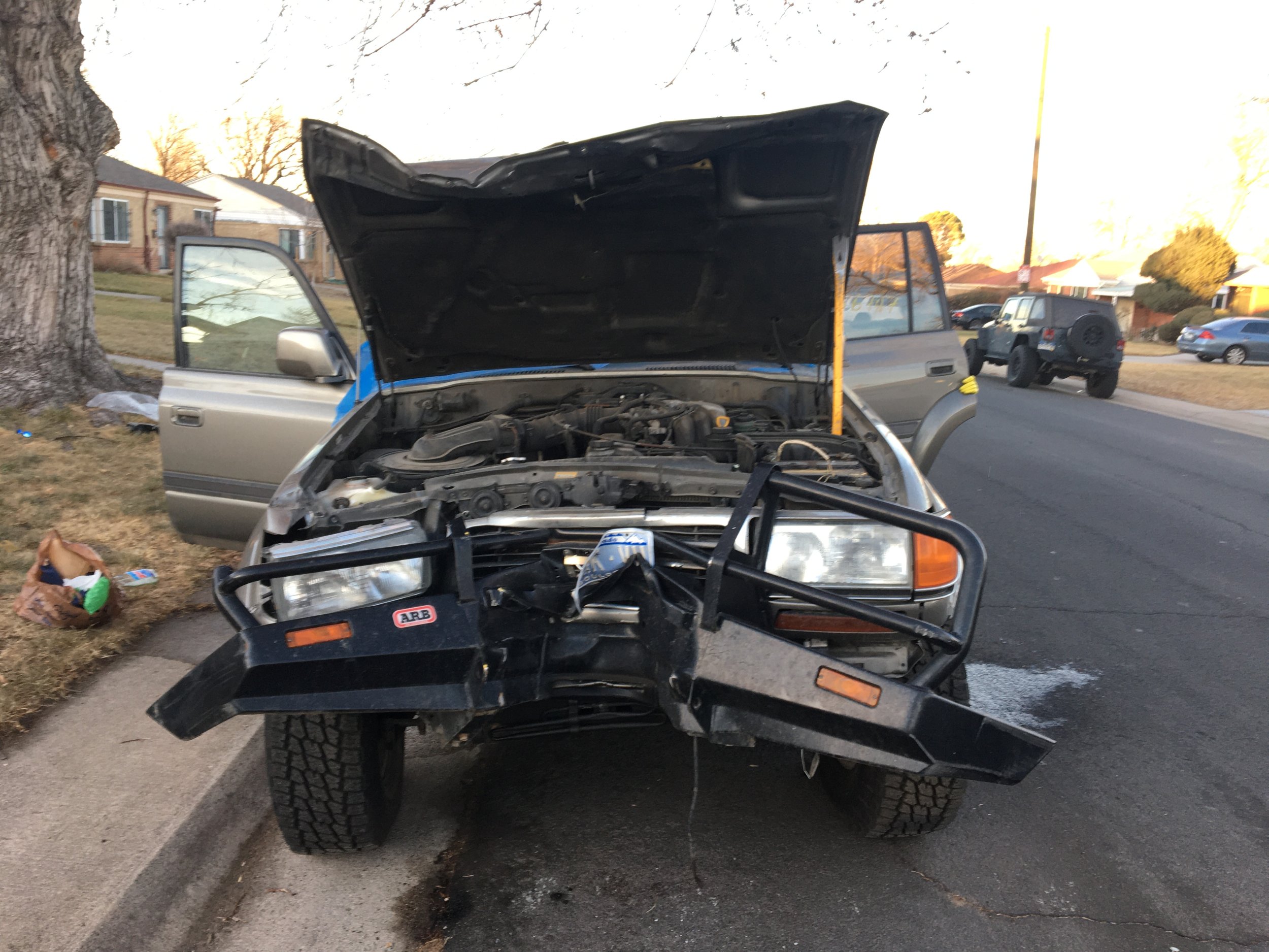

The 80 is now home but currently sitting on the street. My first time seeing the truck in person was at night and only brought up more questions. The priority at the moment is to get it moving under its own power to the back of my house. There are a couple issues keeping me from driving it to the back. After the accident the rear driveshaft was removed, I assume to tow it, I have the driveshaft but they didn't save the bolts and they won't arrive for several days. I am curious about the potential to drive half away around the block with just the front. Any known issues there? Additionally, the accident pushed the radiator into the clutch fan. The only way to open the hood and get the radiator pulled back far enough is to start cutting the arb bumper away. So cut I did. I was able to get the hood open after a few initial cuts but ran out of daylight before I could get it fully off. Until tomorrow.

I jumped on the task of sawing off the arb a bit more and got the center section out. This allowed me to pull the radiator back enough to give the clutch fan some room. With enough room for the fan, I was confident to see if it would start so I pulled out the battery and swapped in a good one from the Stout. Until now I had not powered up the truck and didn't know what to expect. I put the key in the ignition and the dash lights up, turn the key to start and nothing happens. I cycled the shifter a bitas well as the ignition but with no success. Unfortunately, I was out of daylight and time so I could not investigate it further. I theorize it's the fusible link, Nss or a bad starter. Until tomorrow.
