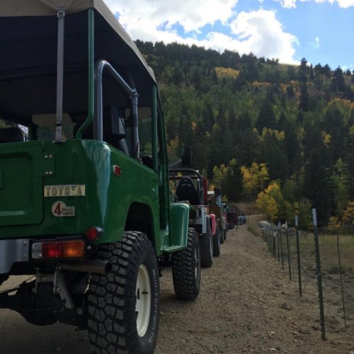

Hey I just noticed in the last picture of the brochure, the red one, those little round marker lights on the tub. I don't have those, and it didn't come with them. Granted, my tub came with diamond plate there, and nothing but rust behind it, so no way of telling if they were ever there once. But that picture of the red 40 kinda implies I should have those, eh? Are they powered, or just reflectors?
It doesn't look like Adam has those either. Marco, do you have them?

They are just reflectors. We got new ones for Dad's '79. A few years ago.

Yeah tub is drilled and ready for them. Old tub had them on it too. Not the sexiest items but oh well

Black no chrome ring 81910-69026 1/1979-1984
Black with chrome ring 81910-69025 9/1973-12/1978
Same part number for both left and right. We put some on my dad's 40 this year and Kurt had them in stock.
15,680
Ok guess I need to get these then, will call Cruiser Outfitters! thanks all

I put mine on, but might not be in any pictures here, I've attached one. They are still available from Toyota, they are attached through two small holes and bolts that go from the inside of the corner through the hole and into the reflector, not powered.

shoot- did you guys do OEM? or aftermarket? It's like a $50 difference, per side.

I had the OEM ones from the PO, I didn't have to buy them. Whew, that is a pricey part. You might be able to get away with non-OEM on that piece. It's not super critical.

Oem

I got some aftermarket ones. The bracket was OK, but the screws were super small, and weak (like they stripped out trying to snug them down) I put a better, beefier screw and nut in, and its been fine.
