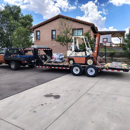

Got down to my client's and picked up a couple more boards. Got them cut to length, sealed the cut edges, then installed them. With all the boards firmly attached, I touched up the paint where needed. Deck came out well. And happy with everything thus far. And will be putting it to the test tomorrow. Need to unload and then install some equipment at a client's who do not have a forklift. So will get to test the revamped trailer with a fairly heavy load.

Awesome work, I’ve enjoyed he step by step progress. Did I miss something, what happened to the fenders?
Thank you for the kind words.
Trailer isn't finished yet, but I need to use it, so the removable fenders are sitting on one of the fab tables, waiting to be completed.
First heavy haul went really well. And I got 2 compliments from different folks today about it. Both said it looked brand new. That made me smile.
