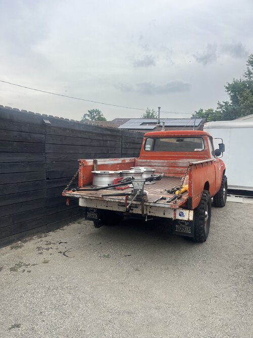

Back at it again with some other maintenance and non maintenance items. The belts were in obvious need of replacement, , so I tackled all the belts. It was a one banana job. So far, the 62 has been the easiest and roomiest Land Cruiser chassis I've worked on.
I also have an opportunity to buy some 40 series wheels, so I decided I'd take the ones off the Stout and see how they look. While I was there, I replaced one of the front sway bar end links.

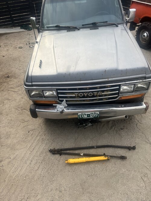

I've been driving it as my daily for the last month and I can report that the trans now shifts fine from 1-2 everytime. I started paying even more attention to how it shifts and when and it appears that I have a flare up, or so I guess that's what they call it. Its minimal and hardly bothersome, however, soon on the agenda is a trans cooler and the "Rodney" flush as suggested by @Crash.

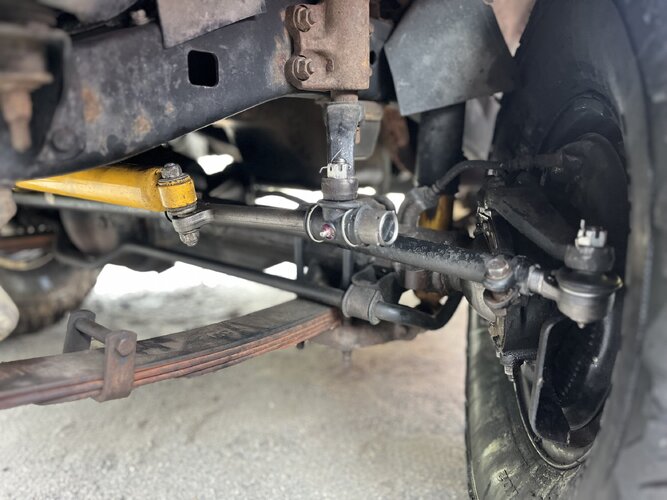

I spent one weekend and pulled the entire front steering linkage and replaced all of the end links with new from Cruiser Outfitters.
The Stout served as the perfect work bench for this effort.
It drives great with the new component's and was honestly not as bad as some linkages I've delt with in the past.

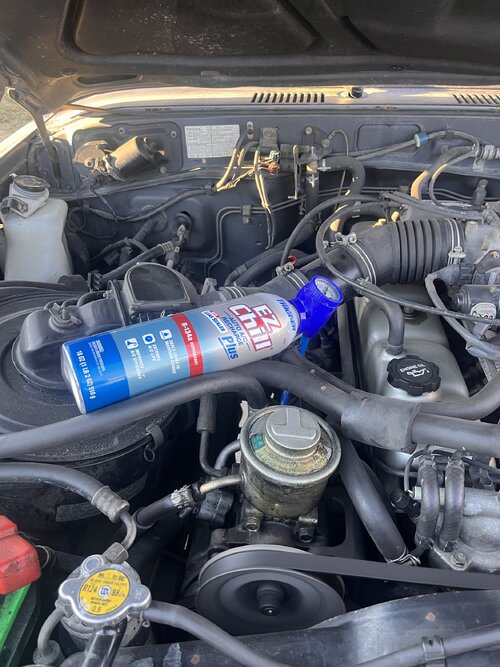

Next order of business was the ac. 6 months ago I ordered some 9 dollar r134a fittings for the ac compressor. I got them on my compressor and then decided I’ll just make sure the low pressure fitting is tight. Of course, I end up breaking the fitting off the top of the compressor. I’m glad the system was empty, but it left me needing a new compressor. Fortunately @Crash had one and offered it up. So I ordered the fitting I broke off and got to changing the top of the compressor and it went by smoothly, however, by the time I got to it the ac was not a priority so, I made that a future me problem. Since I had plenty of time to think about it I got thinking, I wonder if I could refill the system with one of those cans from Walmart?
What do you know, it worked. And just in time for a March heatwave.

@HDavis - you will have to evacuate the A/C system before filling it with refrigerant. And, per the Car Care Nut, don't use any of the 'R134a with sealant' products (might be what you show in the photo).
HDavis
Feb 13, 2019
1,482
Luckily It was already evacuated, before I traded Tim for it.
That’s first I’ve heard about not using the stuff with sealant. I’ve used the same stuff before on my 80 when it was low after I had it refilled at a shop. That was 5 years ago and it still works fine. Hence the reason I figured why not try it to fill the 62 system from empty. I guess we will see how it impacts a system that was filled with it from empty.
