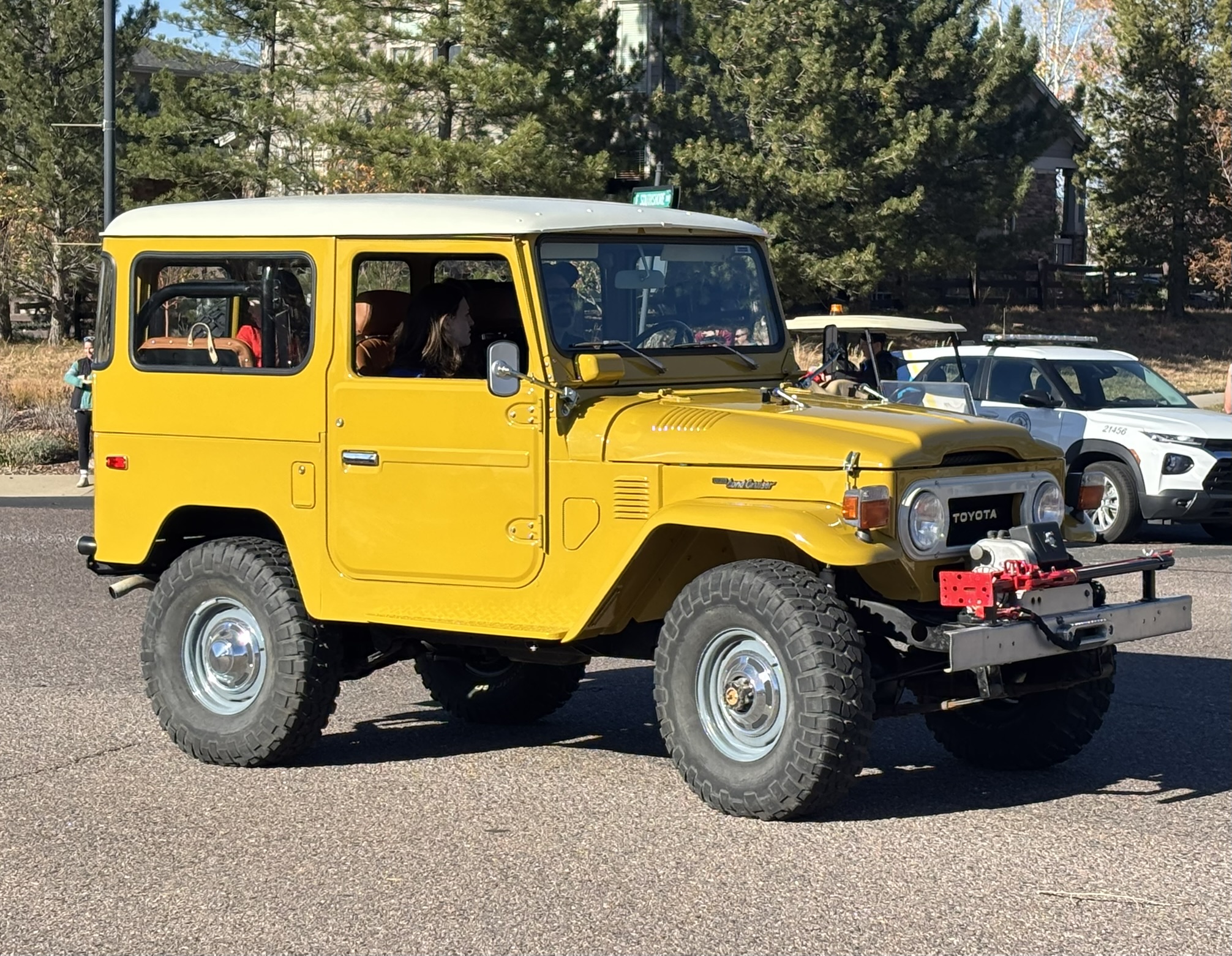

Sorry for the hijack @Cocarlisle but I think this used to be yours... IMG_1307 (2).JPEG

that used to be John Denver’s
Yes! The John Denver FJ40. I was told it was Jason Carlisle that saved it from rotting out in a field near Aspen. And honestly, it had almost zero rust when I bought it earlier this year so either it never rusted or Jason did some serious alchemy on this rig.

Yep that was mine !!
I didn’t do any of the body work and it was in the plans but had to sell when a company I worked for decided not to pay me 250K
Still upset about that but had a family to feed
Excited to see it and meet Justcruisin to share the story
I even have a copy of the Title with Dushendorffs name
