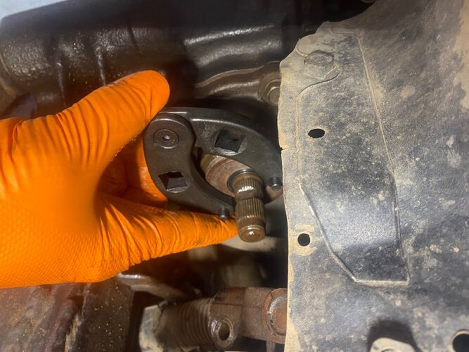

I got the two different types is spanner wrenches needed for this job off of Amazon.

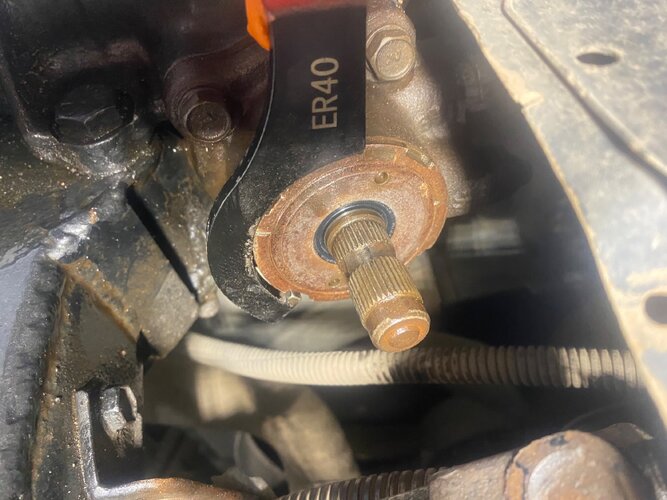

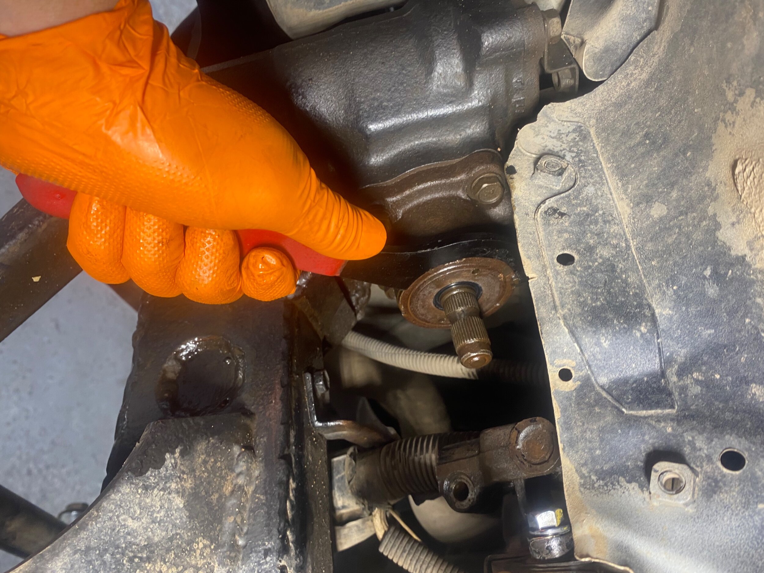

First this typical spanner wrench to remove the outer ring nut.

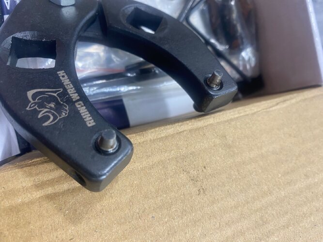

And then this pin spanner wrench “for gland nuts”.
The smallest pin size in the kit was still too big for the holes. But I liked the overall design and heavy duty nature of the tool, so I decided to keep it and I turned the pins down to fit.

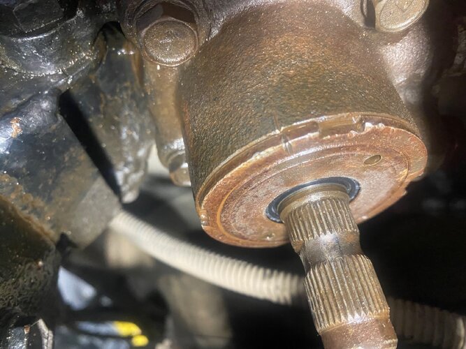

The first step is to take a chisel and make a mark that is on the casing, the outer ring nut, and the inner seal nut.

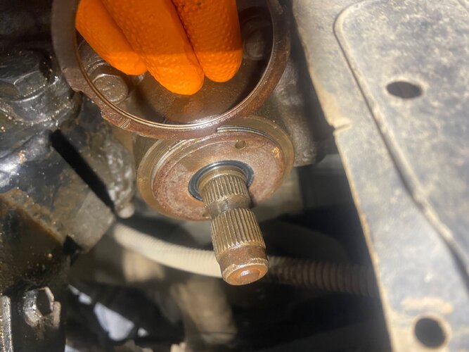

Then, using the ring nut spanner wrench, remove the outer ring nut.

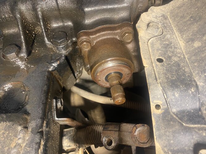

Note that the ring and inner seal nut sit flush with each other. This will be critical later for reassembly when getting the inner nut back down to where it needs to be, rather than counting rotations.
The pin spanner wrench is then used to remove the inner nut.

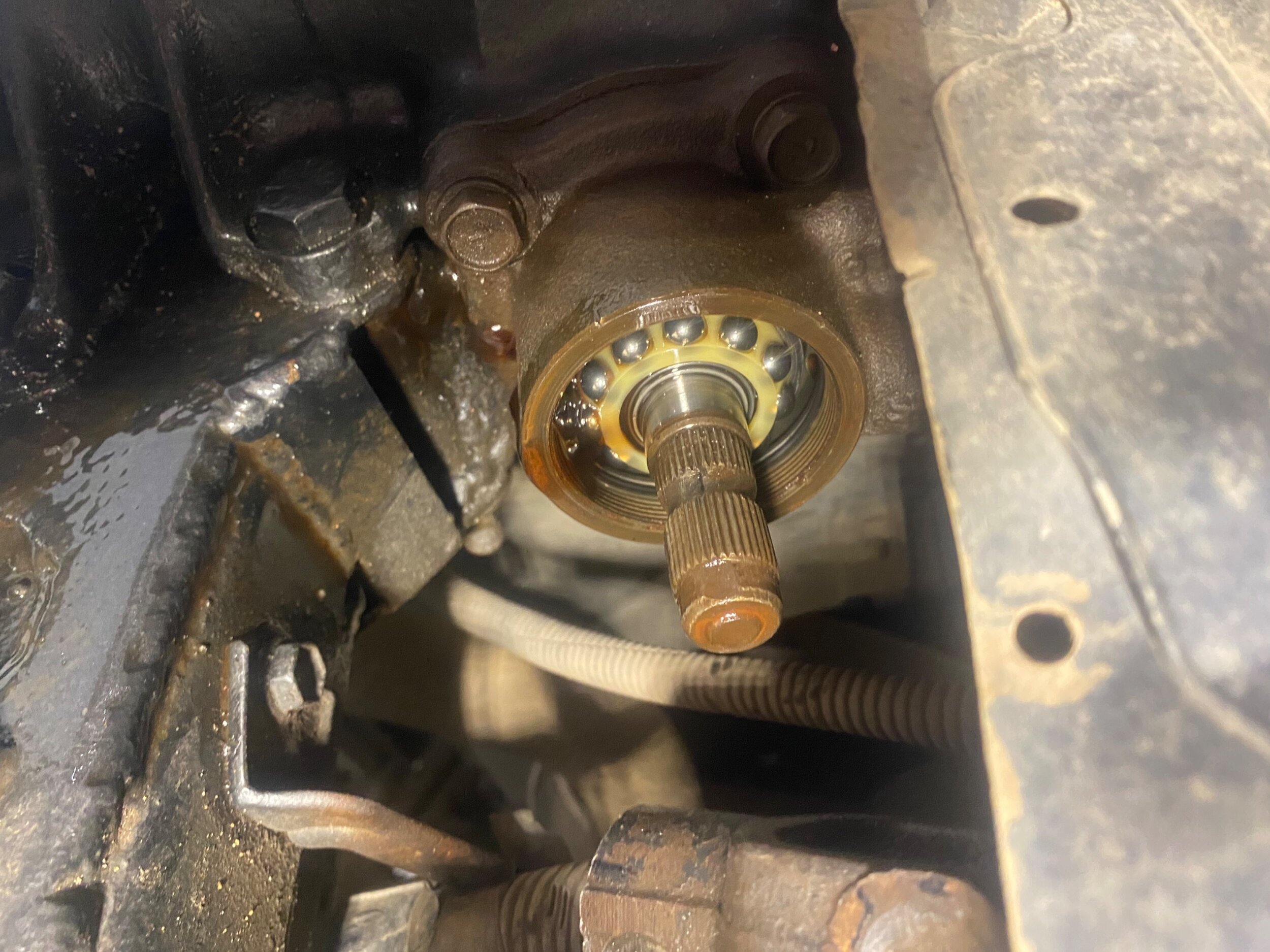

This is where all the power steering fluid starts draining out all over the place. So have a pan ready.
This is what it looks like inside. Don’t disturb the ball bearing.

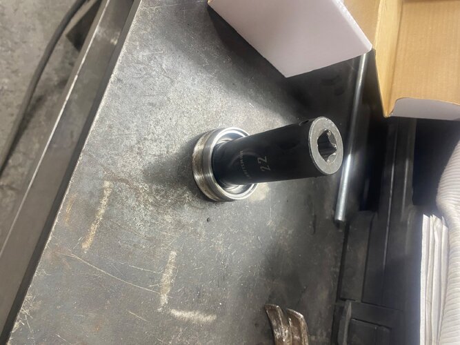

The old seal popped right out. And I used a 22mm socket to set the new one.
