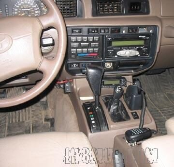

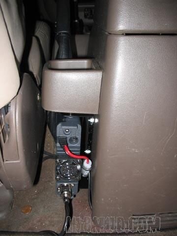

When we were in Ouray last year I could monitor two different frequencies at the same time, and switching between the two was a one button activity. Like Dave said previously, you could tune one receiver to your favorite channel and scan on the other one.
As Matt just pointed out, the 7800/8800/8900 have a detachable face plate which can be nice in the 80 where you have limited space. My face plate is mounted on the console behind the shifter and the radio is mounted on the side of the arm rest and the drivers seat.
If you don't care about the extra features then something like the FT-2800 is a great choice and less money. I found one on Craigslist locally for $100. It's going in my FJ40.
Hope that helps. Here are some pictures of Nakman's setup.
