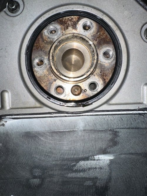

Today I removed and resealed the oil pan with some permatex Great Stuff. Although purportedly you can put it back in service immediately I let it set up for a couple hours while I did some wiring and had dinner. Then after about 20 minutes of idling, all the oil started dripping again. 😞
Tomorrow I remove the exhaust, front driveshaft and unbolt rear driveshaft, unplug everything on the transmission and transfer case, remove the transfer case and transmission, and redo the rear engine plate and crankshaft seal.
Today, I also used a boroscope to look for where could be leaking and checked the oil pressure sensor, which was dry and the camshaft sensor, which was new and didn’t appear to have any oil puddling. There is also no oil coming from the crankshaft sensor.
Good news is that the transmission fluid leak is coming from the front of the transmission pan. Tomorrow after I drain the transmission for removal,I will install a new transmission gasket and use some of the Permatex in the front area.

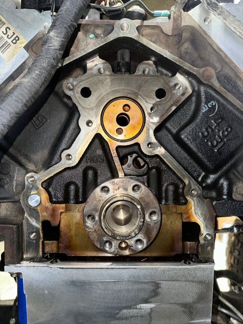

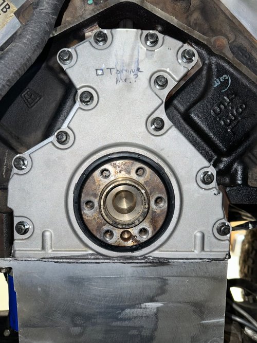

Removed and replaced the transmission and transfer case to get to the rear crank seal. I had definitely installed that sucker too high, which either tweaked the bottom ability to seal or left the gap at the top. Since the oil dripping didn’t start till it was warmed up about 15 minutes, I’m guessing top but don’t really know. Any event, new gaskets and seals in using the alignment tool and confidence is high.

Today finished reconnecting a whole bunch of stuff. Just ran it for 30 minutes and no oil drip. Tiny drip of transmission fluid from the front edge of the pan so maybe I need to buy a new pan maybe this one’s bent but that’s not a big deal so I’m gonna keep putting it back together!
