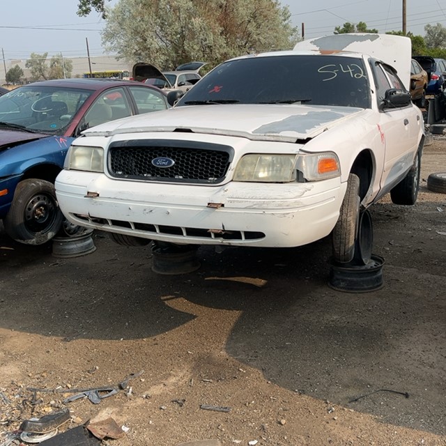

Where was this at?
They got another one
Pull-A-Part Aurora now has a result matching your request at 1370 Zeno Street Aurora, CO
FORD CROWN VICTORIA 2004 Row 305

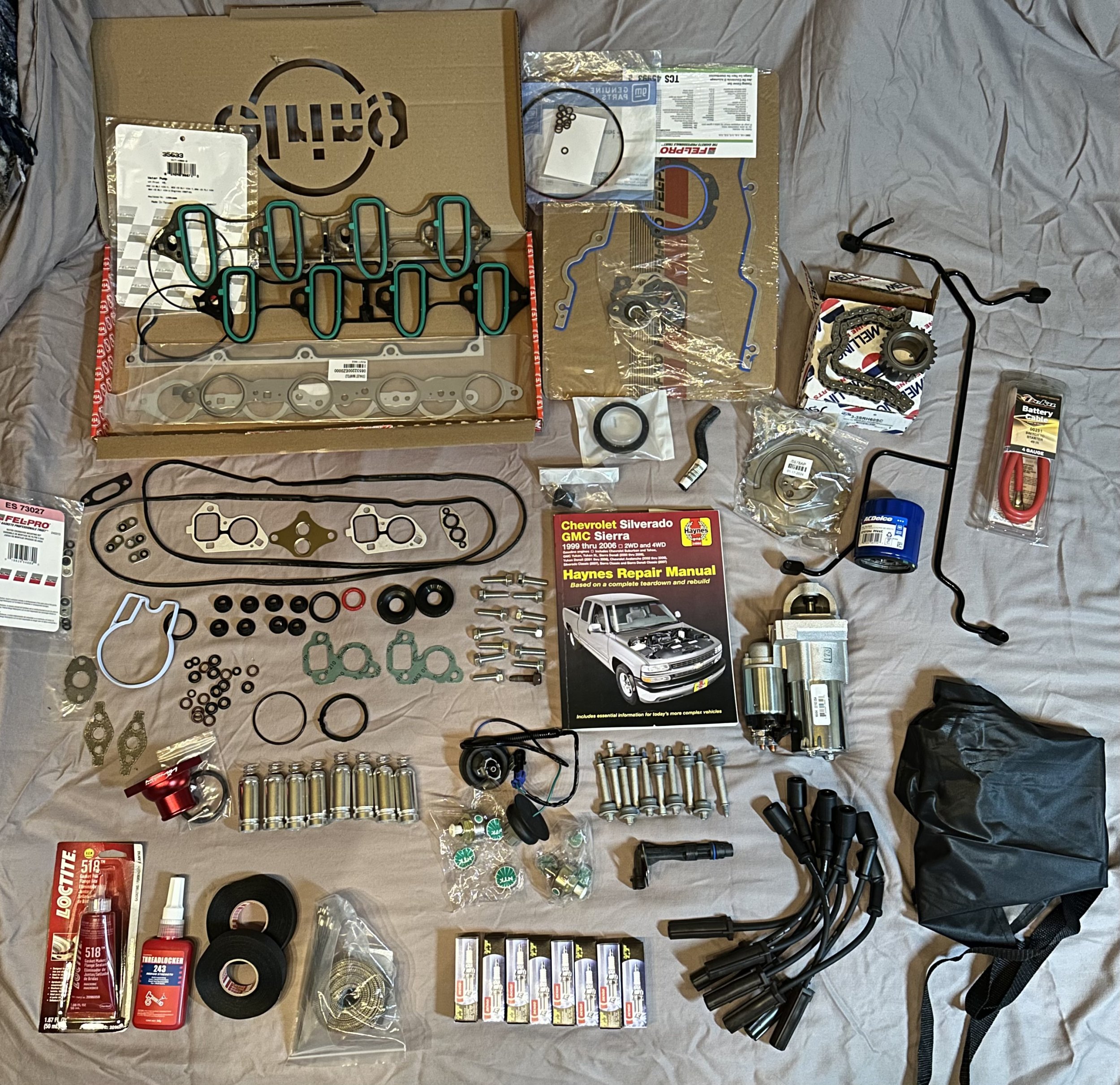

I got parts so start to put the V8 back together, cut some metal, attach a transmission, remove more emissions stuff from suburban, final suburban disassembly and roll it outside for disposal, shoot pool, have a beer, play skee ball

The rear cover I got already has the seal in it. I just watched a video about how to slowly and evenly install and bolt it with the oil pan on.
The front seal I have not watched yet but generally I understand that since the seal is installed in the bolt-on cover plate same issue of making sure the cover plate is flush to the pan sealing surfaces

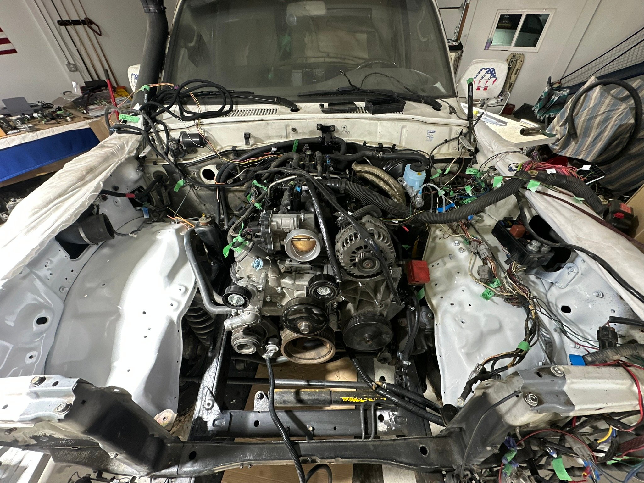

Have not posted for a while.. Busy fall, and much work did not lend itself to me being organized enough to even know what to ask.
Had an amazing Saturday a while back with electrical experts Bill Van Beek, @mikedrom @Cruisertrash and @baileyfj40 . The next few days I wll be making all the connections we laid out.
@Westward Cruiser and @satchel are every present support
With @Westward Cruiser's guidance and welder, we built an exhaust. 2.5 inch SS all the way!
Fuel lines all connected. heater hoses connected. Intake hoses figured, waiting on a few parts. PS all connected. Radiator hoses figured. Fan shroud built from 2 LC shrouds - keeping mechanical fan. Dakota Digital SG-3000 on the way to make dash gear indicators work.
Wires, wires, and more wires.
And a bazillion more things.
This weekend (starting today): connect a lot of stuff, make last brake line, fill and bleed brakes, reassemble dash bits, mount fuse boxes and PCM, wire a lot
Visitors always welcome! text me for details.
