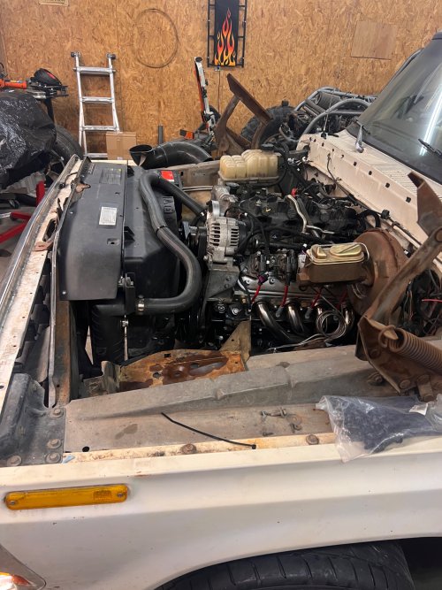

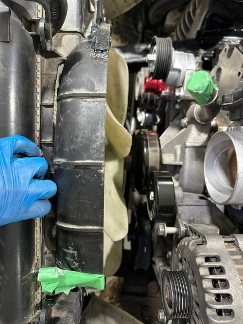

Typically mechanical fan setups allow more free airflow through the radiator than the typical electric fans and shrouds people use. Many folks use pretty flat shrouds for electric fans and they flow like crap at speed so it forces the fan to cycle a ton even though there is a bunch of airflow over the front of the truck. Anyhow the bigger deeper shrouds for mechanical fans usually allow there to be better natural cooling at hwy speeds since they are more open and allow air to flow through them even if the fan isnt spinning hard. Also, electric fans need wiring, fuses, relays, etc and are typically controlled by the ECU (PCM, Computer, Whatever) or an external controller that senses water temp and are succeptible to failures from DIY wiring issues, motor failures, programming issues, and enviromental effects (road salt, water, ambient and engine heat, etc). I'd rather take the mechanical losses from a big mechanical fan than the potential issues from an electric one in a truck.
If you can, make sure the mechanical fan's blades are able to extend like halfway into the shroud and there isnt a ton of clearance with the fan blade tips and shroud. Those two things should make it work a little better than a fan in free space behind a shroud that doesnt extend all the way back. just try and copy the setup in the GM truck you pulled it all from.
J Kimmel
Oct 25, 2005
1,765
Glenwood Springs CO
Please, say more

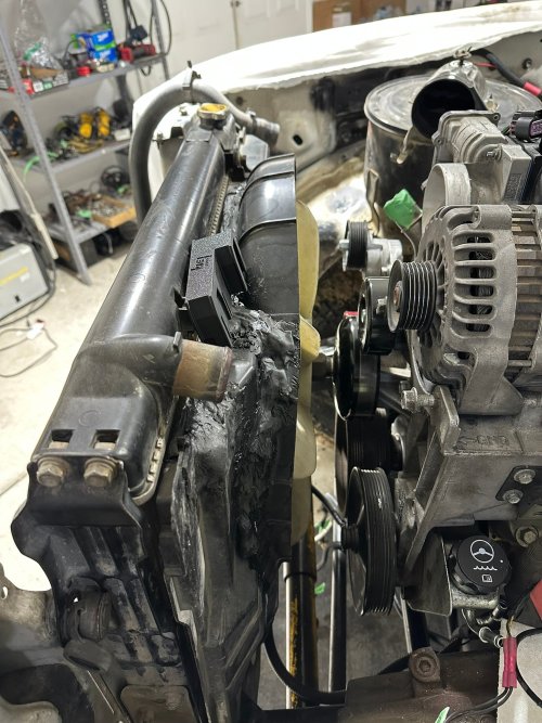

Factory shroud, radiator, hoses and factory mechanical fan. It sits right at 210° no matter what. One afternoon I sat on the highway in the sun moving around 3-4 mph for about an hour at upper 90’s and it never moved off of 210.
Keeping the factory junk just takes one more variable out of the swap blues equation.

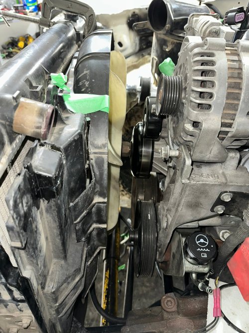

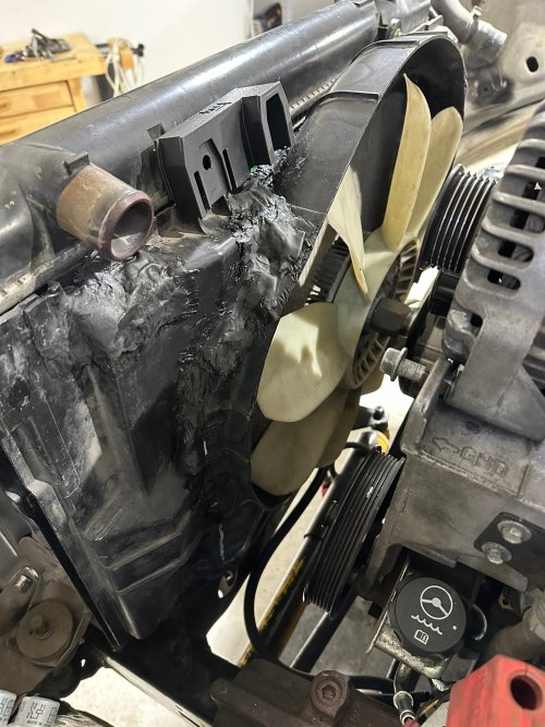

Wish I had room for the mech fan. I'm up to 4 electric fans now and it's barely holding the temps down on slow uphill climbs.
8,055

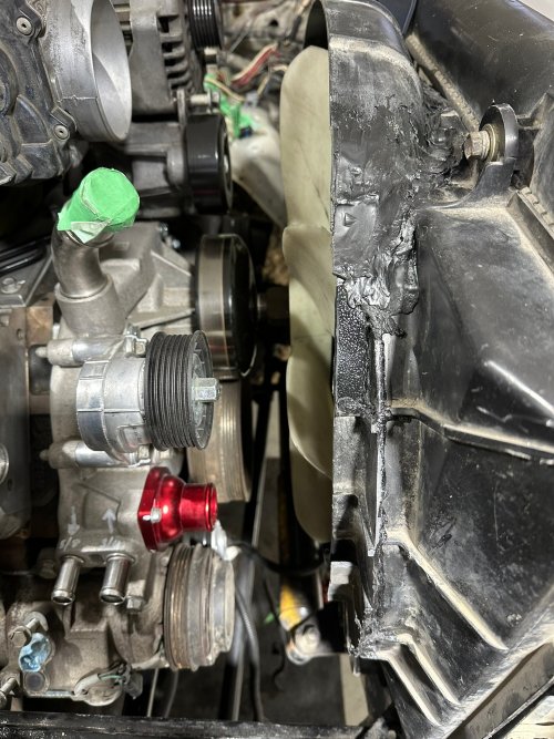

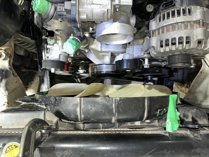

This is the OE shroud attached normally to radiator with another OE shroud flipped upside down and shifted left a couple inches. From there it was cut, fill, weld. The plastic welding is ugly and the top shrank a bit, but I think it will function.
0.5 - .75" clearance at fan tips.
About 1/2 way into shroud.
Unlike Toy fan, this one can be R&R without moving shroud. :cool:
Red water pump inlet was for when I thought I'd have electric fan. Its swapped back to OE style.
I will have foam sealing shroud to rad and on OE locations on top of radiator.

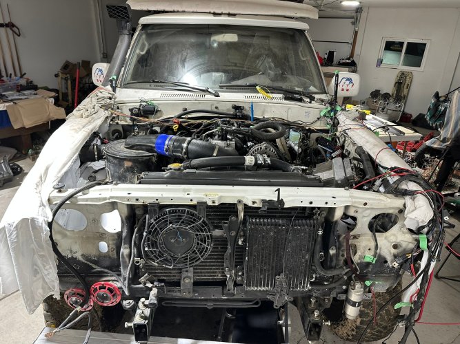

The truck had a not-connected pusher fan on the AC condenser I plan to re-install and see if i can get ECM to trigger relay.

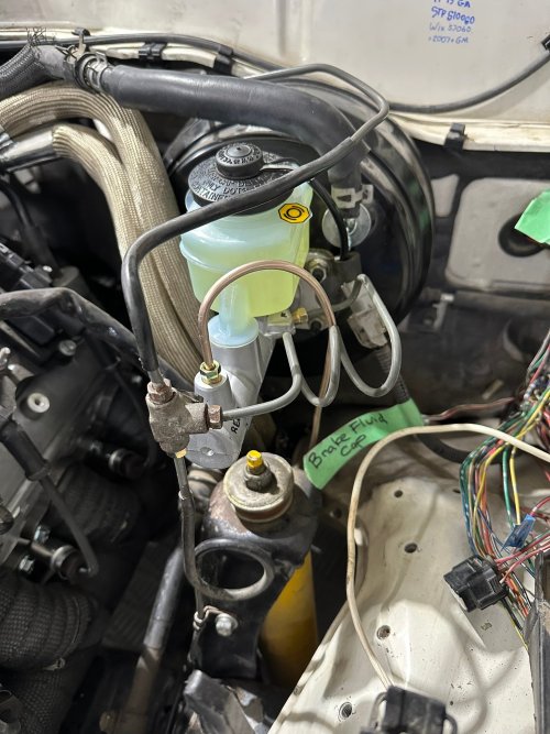

Good day at the LC Garage yesterday. Scott saw this thread and gave the day! We flared some brake lines (re-used a steel OE line for my new left front hardline - with a coil we made), bench bled the new MC, and filled, flushed, and bled the system. Bleeding without ABS or LSPV was different experience.
Scott created LC's "sign" and threw it! IYKYK. Semper Fi!

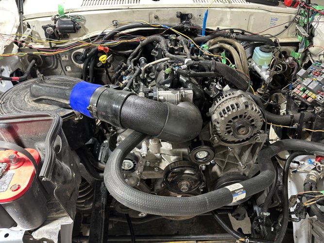

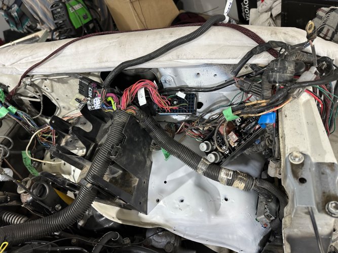

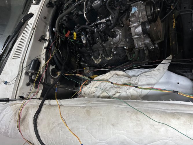

Yesterday I put lots and lots of wires together and I’ll be doing more of that today
8,055
Tuesday evening me, Tyler and Trey all hunted an electrical issue. It was a curious one! 11.9 v backfeeding from the Cruise Control ECU made me think there would be 12v to the starter solenoid with key in "On" position. Maybe. Nothing that could not be solved with a BvB and 1996 LX450 EWD. Checked two things today - that the theft deterrent system was already out and that the the cruise ECU was the source of the backfeed. It was. The current was barely registering on a meter in its most sensitive setting.
Gremlin resolved I put on a serpentine belt, installed the radiator, connected the transmission cooler and all cooler lines, put on the fan shroud, snapped off one of the shroud tabs that had already been broken, properly plastic welded it, modified the nipple guard to fit, fabricated and installed both radiator hoses from various pre-acquired parts, connected the air intake, and called it a night.
Tomorrow I expect to fill the radiator (water for now) system, hook up some wires so I can crank it - at least enough to pump the torque converter full and finish filling the transmission. Oil is already full - filled by pressure into the port by the oil pump top prime the whole system - pump, filter, and some through the galleries. PS is filled and hopefully bled.
Before I start I'm also going to put in some fresh gas and run the fuel pump with fuel rail supply disconnected to flush the line. I also have to get in to HP tuners and turn off VATS (theft system). While there I will enable the fan controller so I can connect an aux fan that was there when I bought it.
Have to plumb and wire in the tank pressure sensor and wire in the Chevy fuel level sender.
Still to be made: exhaust hangers. Exhaust is close to crossmembers as it goes back so I'm not sure how to do those. I have a few types of hangers on hand.
Visitors still welcome. Front stuff including ShortBus bumper, headlights, hood, etc., still to be attached. Have to reconnect lights and probably swap in one or two new batteries under the back seats - the house batteries. It will be busy!
A week from now I am supposed to be 1/2 way to Hammertown. Um ......

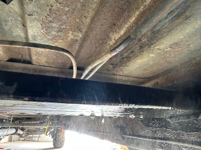

All fasteners marked with white paint pen after torquing. :-) Except whatever I forgot.
I knew we should’ve replaced Exhibit #1: Steel fuel line. I knew a bit I had cut off showed lots of corrosion. Now all replaced. Interestingly the smaller diameter return and vent are a copper blend brake line sized and not corroded.
