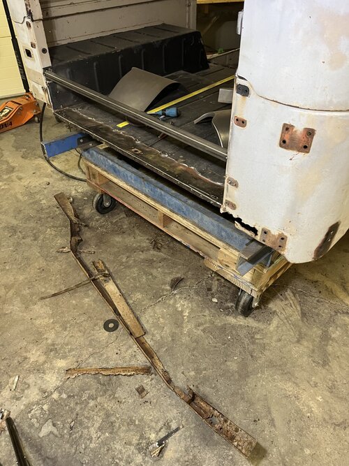

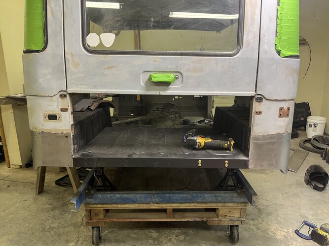

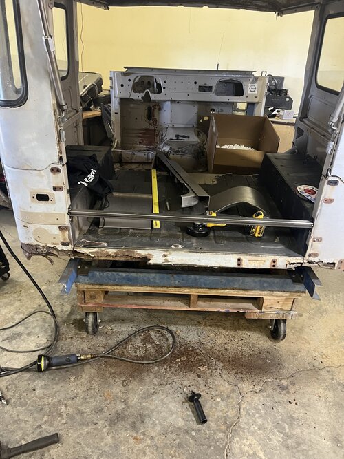

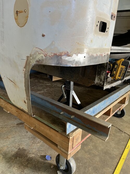

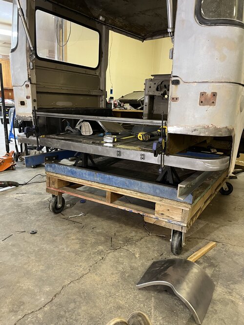

Jimmy’s 40 series rust removal.

It looks like you mig welded yours. I have a small flux core welder but that will blow right through the panels. I took a welding class at General Air last year and can lay a bead, I even made a horseshoe flower for the yard, but 18ga just seems like a different beast. Perhaps I'm being a chicken about it.
Yes, that is MIG. It will also run flux core if you run out of gas like I did once - LOT of spatter. As far as learning how to not blow through sheet metal, just practice practice practice on practice pieces. My '76 is 16 Ga and your '78 will be 18 Ga, but I welded on my FJ60 and didn't blow through. On sheet metal you don't lay beads, you do spots. Beads would overheat it and warp it and you don't need the strength anyway. Beads are for stuff like armor.

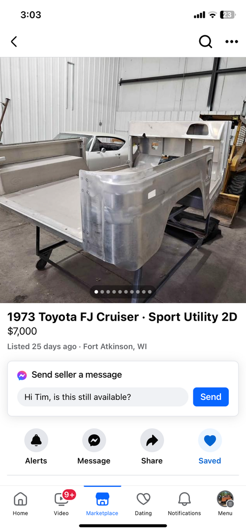

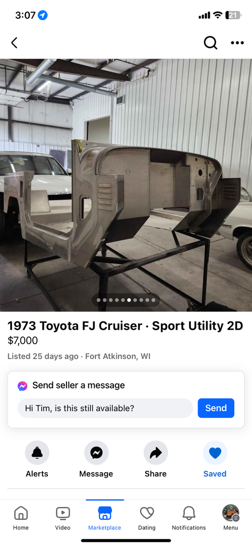

@Nate here’s a Aqualu full tub (3/4 tub w/cowl and windshield frame for $7k in WI.
