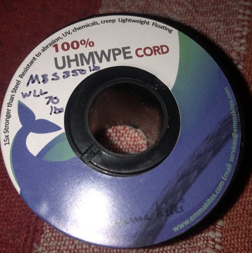

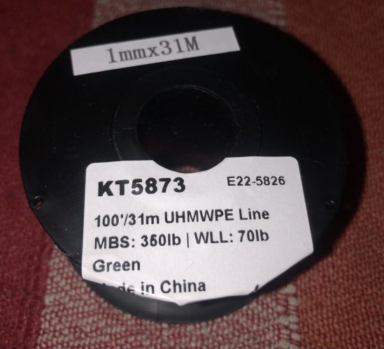

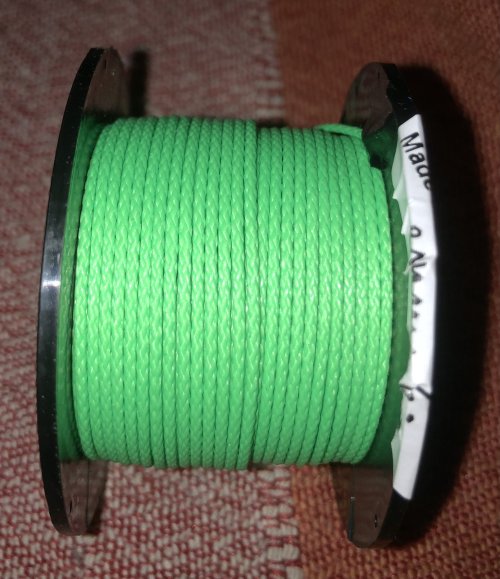

BTW, our splicing work is only with 12 strand dyneema (and other UHMWPE). Different types require different technique.
