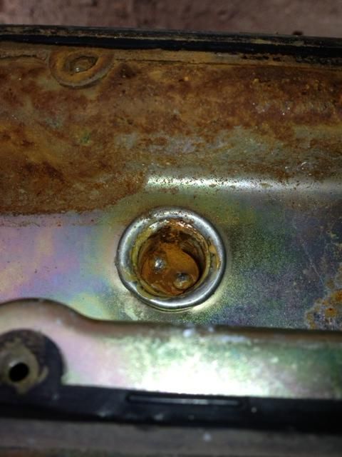

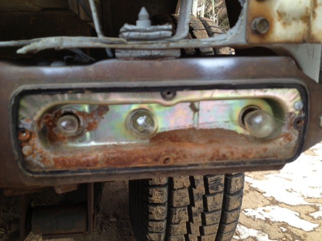

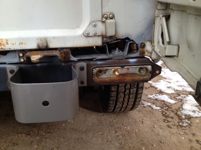

I decided to take advantage of the warm, sunny, and not very windy day and take care of a few things on the 40 To Do list. First, I tracked down my short. As expected, it was in the tail light housing. The fuse was blown, and as best I can tell it blew the second I turned the headlights on. Following the circuit brought me to only a few possible places. I knew the PS tail light housing was fairly rusty, so I pulled both lenses. The DS housing wasn't very bad at all, and the PS one was still nasty.
I pulled the bulbs on the PS side (the glass in the reverse light bulb has separated from the metal base), and right away found my short.
If you look really closely, you can see where the corrosion between the contact point (positive) and the side of the housing (negative) are very close, and the rust (iron oxide III, which is marginally ferrous) is bridging the gap. I cleaned it up with some sand paper, nudged the contact toward the center a bit, replaced the fuse and the bulb (left the reverse light out for the purpose of having it on hand to source the replacement), et viola! tail lights function with no shorting.
While I was at it, I checked the engine oil (a bit low from either leakage or burning... not sure which yet), trans fluid (fine), checked the transfer case linkage (it's loose, but it seems to be from wear), and finally cleaned it out and installed the SOR floor mats I got a while back.
