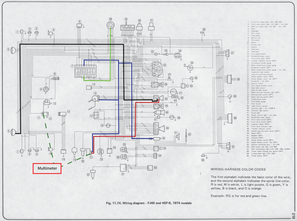

I've been testing the crap out of this thing to see if I could trace the problem. The primary informative tests so far have been:
If I hardwire the pump directly to the battery, I have full function. Pump is good.
When I plug my multimeter in as shown, there is zero voltage. When I throw the switch, there's battery voltage. Switch opens ground, power comes from the other lead. The switch and the ground side of the harness are good.
The wipers and radio both work, so the harness is good from power to there. Additionally, I tested conductivity from the fuse block to the plug in the engine compartment so we're good there too.
Also, I verified the plug has power by putting the multimeter between the positive plug terminal and negative on the battery.
Stumped.
Mar 25, 2012
299
Coal Creek Canyon
A bit ago I tried cleaning and reshaping the plug itself (it's about the only thing I can't really test). It didn't do a damn thing.
I just went out to retest something I'm fairly certain has tested correctly a dozen times just to make absolutely sure (plug positive to plug ground). It tested exactly as it should. Then I plugged it back in, and magically it started working again...
My best guess is that it's way too cold for the electronics cleaner and it needed some time and/or the multiple pluggings and unpluggings finally deformed the plug in such a way that it made sufficient contact again... I don't know if it will work tomorrow, but we'll see what happens. I'm cautiously optimistic. Even if it doesn't work, I think the plug itself is all that would need to be replaced.

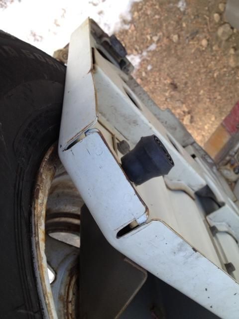

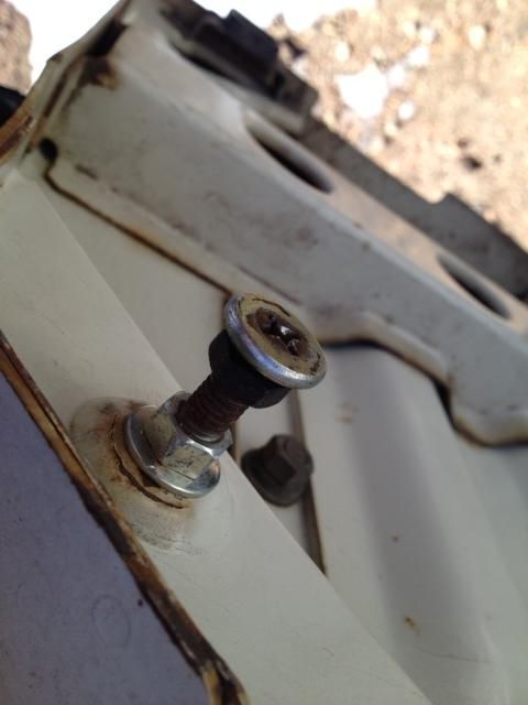

The rubber bumper on my tire carrier died the other day causing the tire carrier to make a nasty racket and further the dent in my tail gate. SOR has a bumper for something on the order of $15, CCOT has a less expensive one ($8), but with a $20 minimum it sort of becomes moot. I couldn't get a hold of CDan, so I figured I'd give McGuckins a go. Sure enough, a "cane tip" made for a perfect replacement at a wallet breaking $2.50. It's the rubber pad used at the bottom of crutches, canes, and (based on their location in sporting goods) walking sticks. A 3/4" tip was a perfect size for the wide flat headed screw that was the core of the original bumper. Given its intended use, I have high hopes for longevity. It will likely need a bit of trimming as it's the full length of the screw as adjusted, but no biggy. Photos when I have daylight.

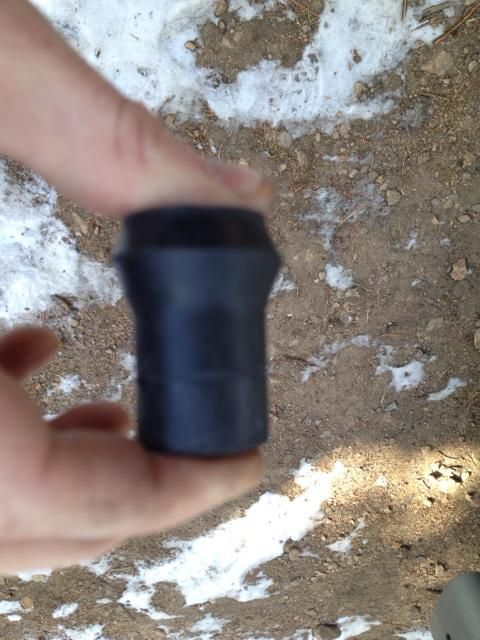

I used some liquid/graphite lock lube this morning to make the cable pulls in the dash nice and smooth this morning, and checked the radiator... I finished off the gallon and it is still wanting for more. Allie is going to pick some up from me on her way howe from work this afternoon, and we'll see how much is still lacking. I'll probably be doing this for a while as the bubbles work their way to the radiator. I think when the PO replaced the radiator and such, he didn't strike me as the most fastidious sort and probably didn't put enough coolant in. 4 gallons seems like a lot to me, and it probably would have to him as well. I'm going to keep an eye on things and see if I'm running hot (not according to the temp gauge, but it's worth watching) and blowing it out the down tube, or maybe slowly burning it through the head gasket (no signs of that either). Otherwise, it was kind of warm yesterday, and maybe it just hasn't been run in warmer weather... I really don't know the behavior of water cooled cars when it comes to this sort of thing... Please chime in if anything sticks out as remotely noteworthy. Assume I'm a complete naif.

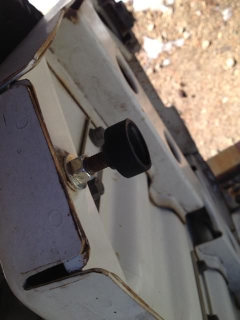

Meanwhile, as stated previously: the bumper on my tire carrier gave up the ghost this past weekend. The rubber got brittle, and the part that holds onto the specialized screw let go and it was just hanging on there like a really loose washer.
I took it off and was left with just the screw and a lot of noise as it beat up the tailgate over every bump in the road.
SOR has a replacement for $15 (plus another $5 or so for shipping and another $15 because they can somehow get away with that in 2013). CCOT has a slightly different one for $9, but there's a $20 minimum and I don't have an immediate need or desire for anything in that price range right now, plus shipping of course. So I went to McGuckins and found this (and proceeded to take a nice shot of the ground with it out of focus in the foreground):
It's a rubber tip for a cane, or crutches, or (given it's location in the sporting goods department) walking/hiking sticks. I'm thinking the wear from use shouldn't be a longevity issue given its intended purpose, and it can't be much worse than the factory rubber in terms of what little UV exposure it might get where it lives. Also, $2.50. The key is that it has a 3/4" hole, which is close enough to the factory hardware for a snug fit and can still be fitted by conventional means. It was a little longer than necessary and required cutting it a bit shorter, but in the end:
A nice fit, good and soft, the carrier closes easily and doesn't rattle! Win!
