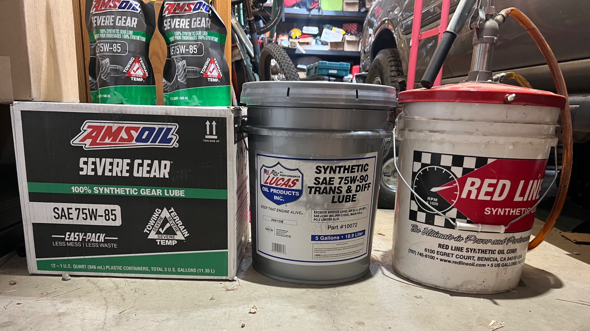

Still lots to like about the Delvac. Saying what gear oil is the best is like saying what tire is the best. A lot comes down to rpefeerence
Likely any good gear oil is OK.
