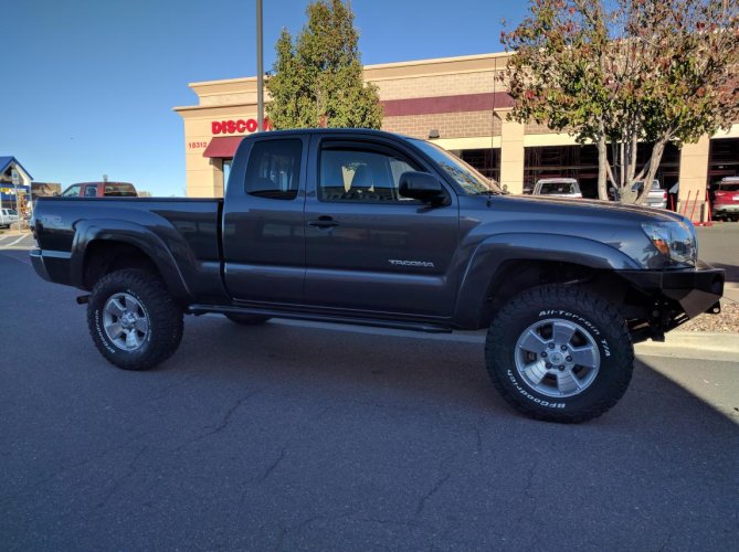

Here is mine today just after upgrading to 17-inch rims and 285 70 R17 BFG T/A KO2s. The front bumper is Demello Offroad and the sliders are the All Pro APEX sliders. I think maybe I need spacers in the front.

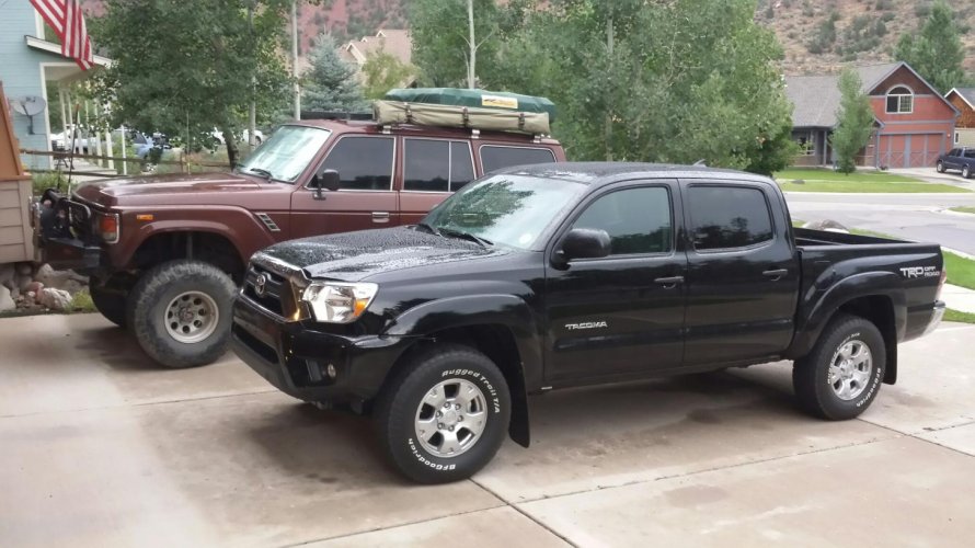

Here is a picture of my tacoma:
2014
TRD Off road
Six speed manual/TRD quick shifter
I already have 50k on the odometer
Replaced the rugged fail tires with 265/75R16 BFG KO2A
I bought this truck after blowing up my 2.5l 2001subaru leagacy engine.... (twice)
Really love the truck. :hill:
