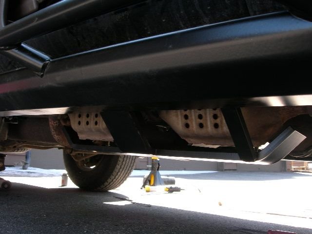

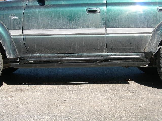

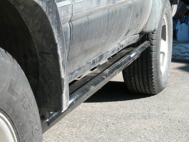

Install was a piece of cake honestly. Did it solo. Couple of tips for anyone who does this in the future.
1. Use a tap and clean out the 4 captured nuts by the cats BEFORE you start mounting the right side slider. This will save you much time.
2. I had to grind a little of the weld on the back side of the rear lower control arm brackets. Again doing so before you start mounting the sliders would be better. Due to clearance issue (with slider already in place) I used a Dremel tool to do so. A little slow.
3. Have a shorty 12mm ratcheting box and a long slim type 12mm box to get the brake line bracket bold undone behind the fuel tank. I used the long box at about 4 o'clock to brake it loose. Then I reached over the frame rail with the shorty one to get it out. It never went back in as the u-bolt was right there.
Other than that it went pretty easy. I used a pair of jack stands and one floor jack to assist. I would be easier with two people, but not something anyone should be afraid of doing themselves. I found these much easier than the IPOR skid plate to install, I wouldn't want to do a skid by myself again.

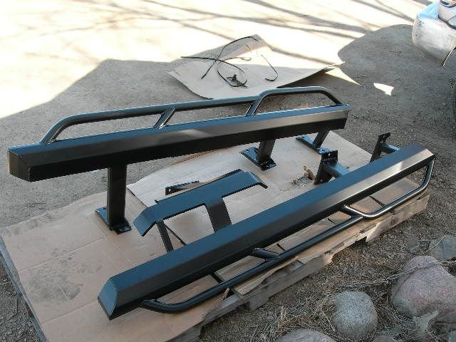

Is the Cat guard removable?
No, it acts as the 3rd support member for that side. In order to replace cats slider would have to be removed. PITA but not a regular PM item.
This is the only pic I have before I put them on the truck. The plate that rests against the frame rail and bolts on using existing captured nuts is hidden by the cat guard.
