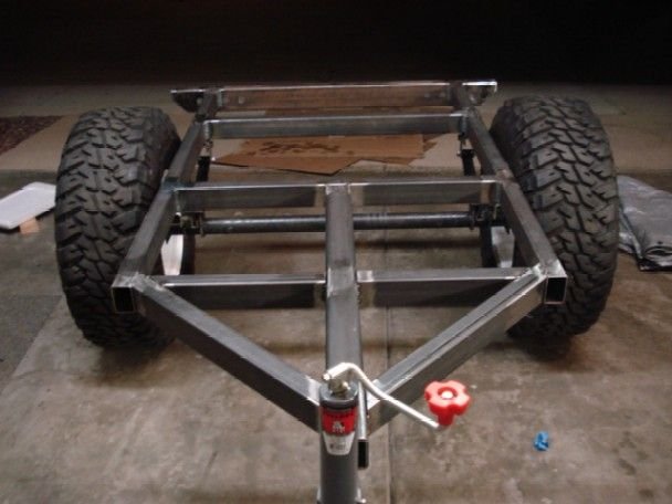

School me on my welds...
Sep 2, 2006
698
somewhere out there
get as close as you can, start at the top and work your way down.
bring it down i'll do it for ya :thumb:
as far as the end piece. i'd work a bit more on the flat part and edge over if you know what i mean.
i would have capped the end first, you would have more "meat" to weld with.

increase the voltage to compensate for the additional stickout.
work in an "A" pattern or triangle as you go up.

Cut down your penetration on the thin stuff, less voltage and less feed, and move a bit quicker.
Is this back seat welding, or team welding? Armchair quarterback welding?

Thanks guys.
Jim, The ends will not be capped because I am going to install little doors over them to store long poles for an awning in them.
Sounds good, I will try a few scrap peices!

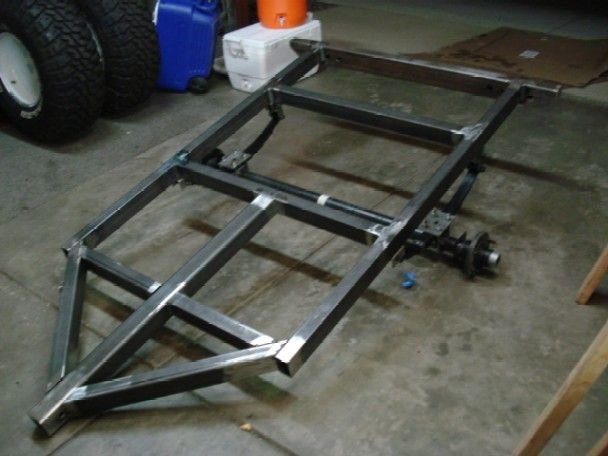

Thanks! My trailer is coming along nicely! :D What do you think?

Drew those welds are looking great!
Dunno what gun you're using, but I have an M10 if you're still needing something small to get in that angle.
Treat edges the same way you would, if you were welding thin to thick...spend a little more time on the flat and wick the edge in to the puddle, like SROR was saying.
Isaac, do you mean your beads seem too tall, or too wide?
-Sean
Both.
