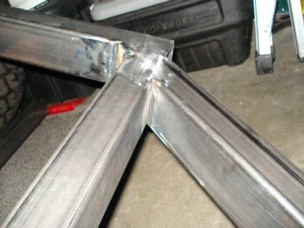

School me on my welds...
Rezarf
Aug 25, 2005
5,914
In Uncle Ben's Shadow

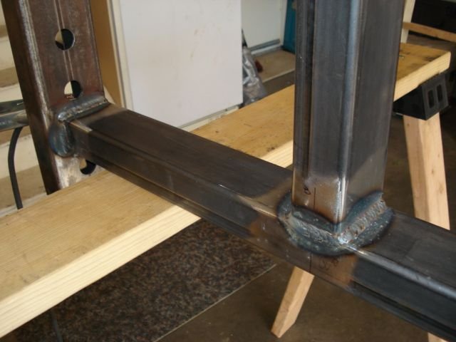

That is a beautiful weld! Run your puddle a tad longer so when you pick it back up on the next side you don't have a pinhole.
UB-
Do you mean run the bead around the corner at the end of each pass? It has been hard for me to turn the gun around that corner, I will try to extend it a bit more.
Thanks! :thumb:
14,144
Northside
UB-
Thanks! :thumb:
The puddle around the corner doesn't have to be deep. The principle is when you start the new bead you can push the molten puddle onto the previous puddle and start pulling the weld again.

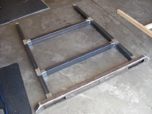

Spy photo's

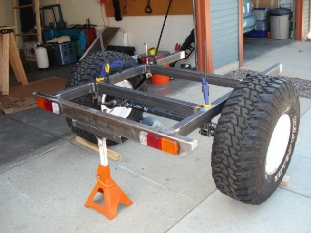

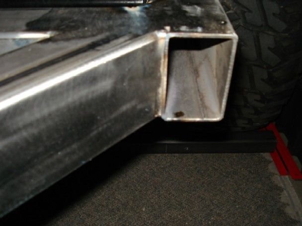

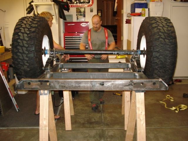

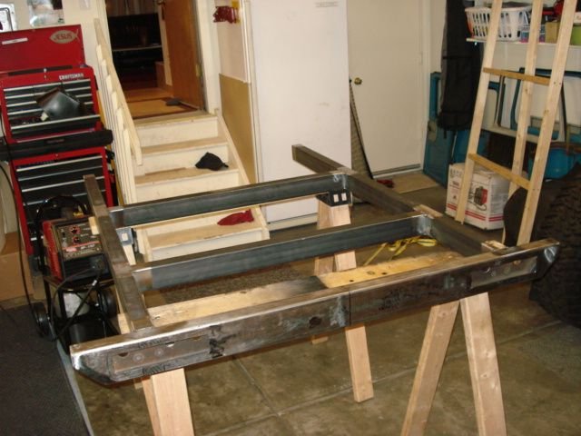

Here is what all my welding has been about, getting my camping trailer going finally!
Here are a few spy photo's ;) Thanks again for all the help. I feel like I was getting good penitration and I had a blast doing it! :beer: :beer:
I have a whole build-up thread on mud for this little guy... should be a fun build... been in the works in my head for years now, finally nice to see it happen.:cheers:

Beater
Dec 7, 2005
2,786
denver
very well done... my stuff never looks that good (for myself)...
corsair23
Jul 11, 2006
8,610
So Drew....
Ummmm, when are kits going to be available? ;)
Seriously though, nice work and can't wait to see the finished product! :thumb:
10,765
MMMMM....classy. I like the 40 series lights on it. That's a nice touch. :thumb: Great job on the welding so far too, I'm jealous.
15,557
Most impressive, Drew, that thing looks awesome! :thumb:
Red_Chili
8,335
Littleton CO
Yeah, but it ain't as cool as my trailer... no diff....:hill::hill:

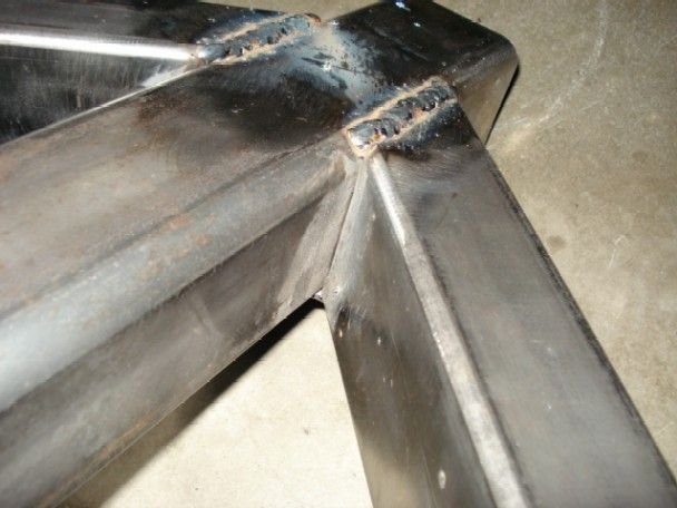

How do you weld this?
How do you weld this tight angled stuff? I can't seem to get the gun in close enough to make the weld puddle right. Is there a trick or two someone might want to share?:bowdown:
I now know how close the nozzle has to be to make good welds, and I am out about 1/8-3/16" past the sweet spot. Any advice, just shove it in and pull the trigger? :confused:
And what about when the edge is sitting there, I feel like I would burn through it too fast, any tips there too?
Thanks! :thumb:
