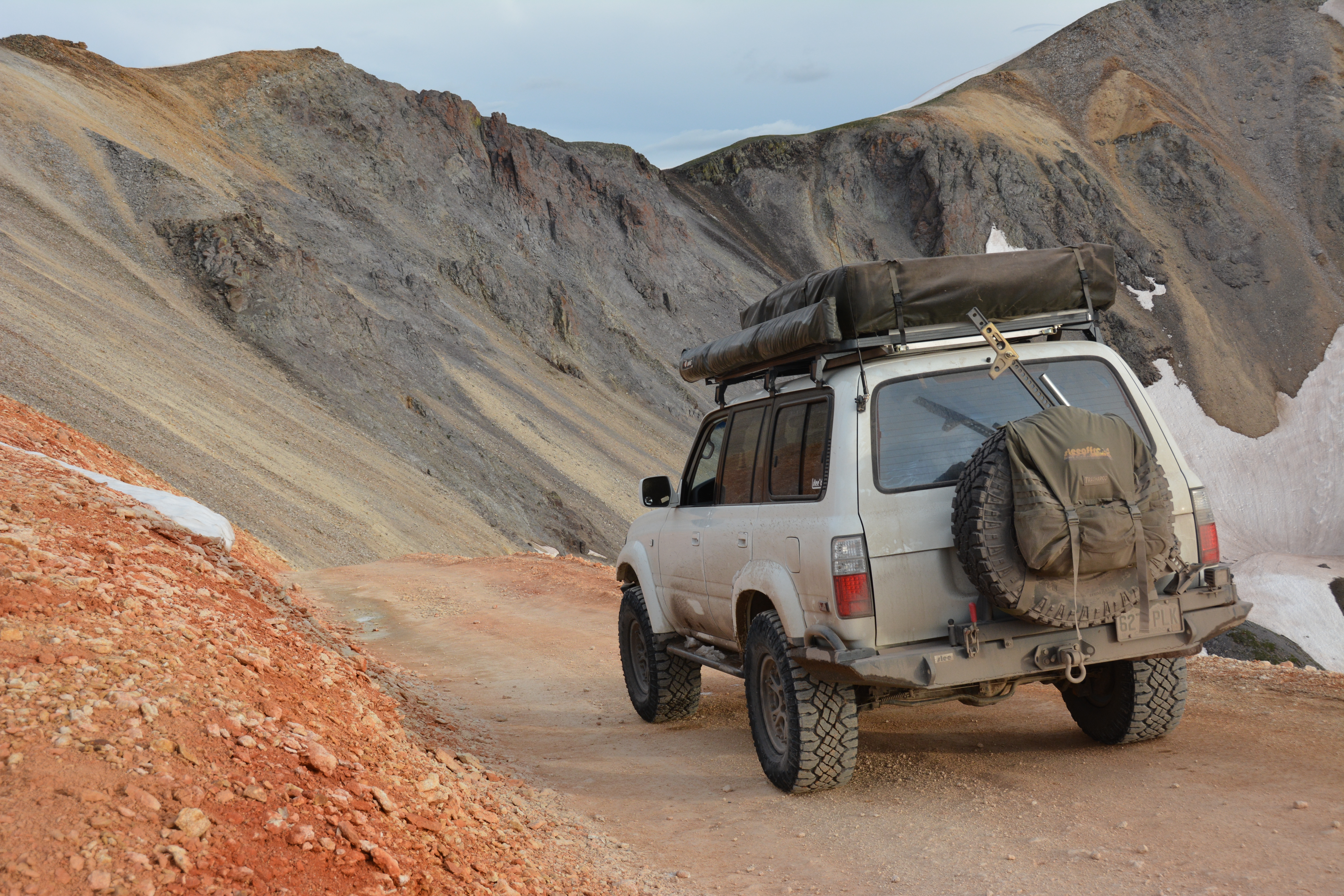

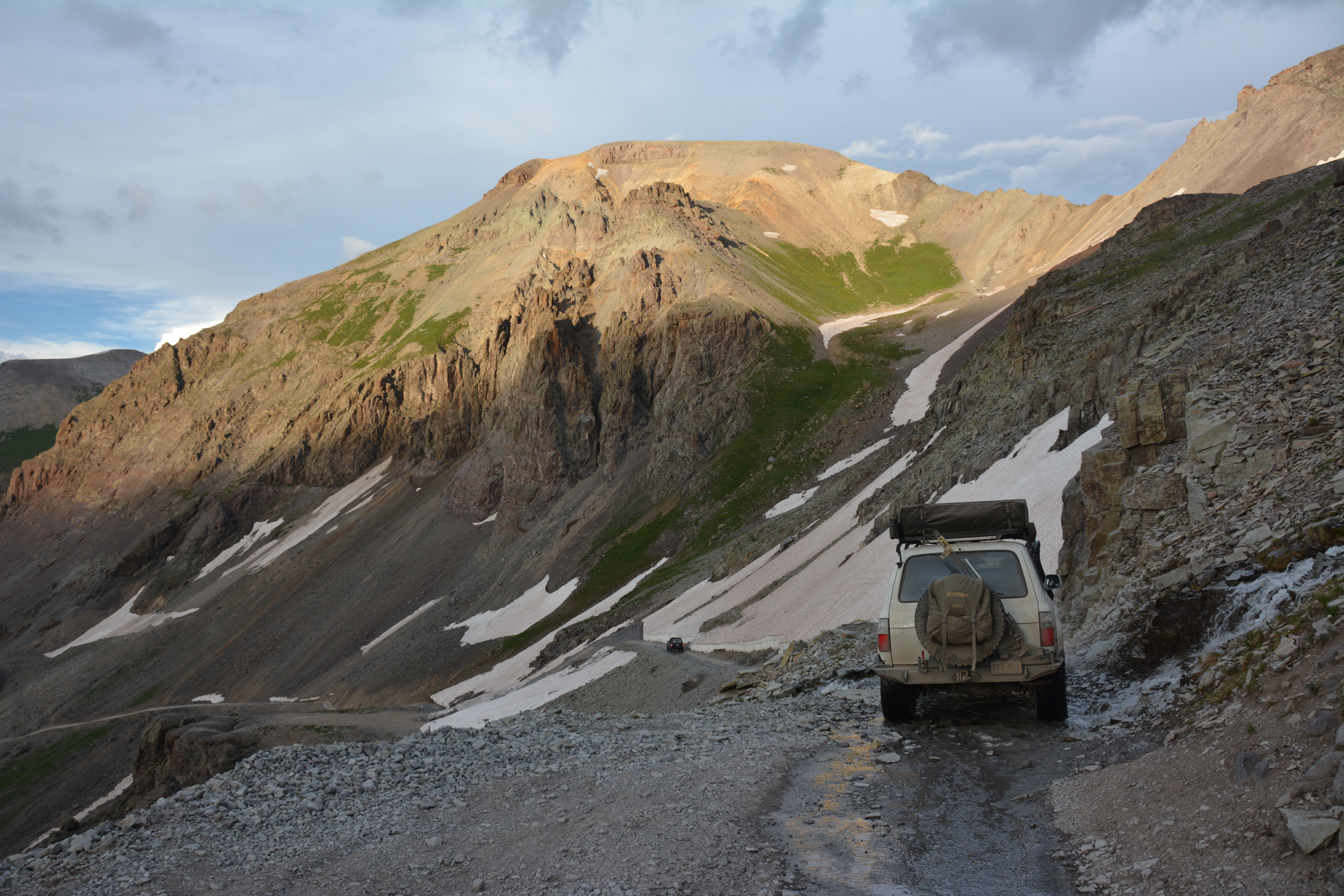

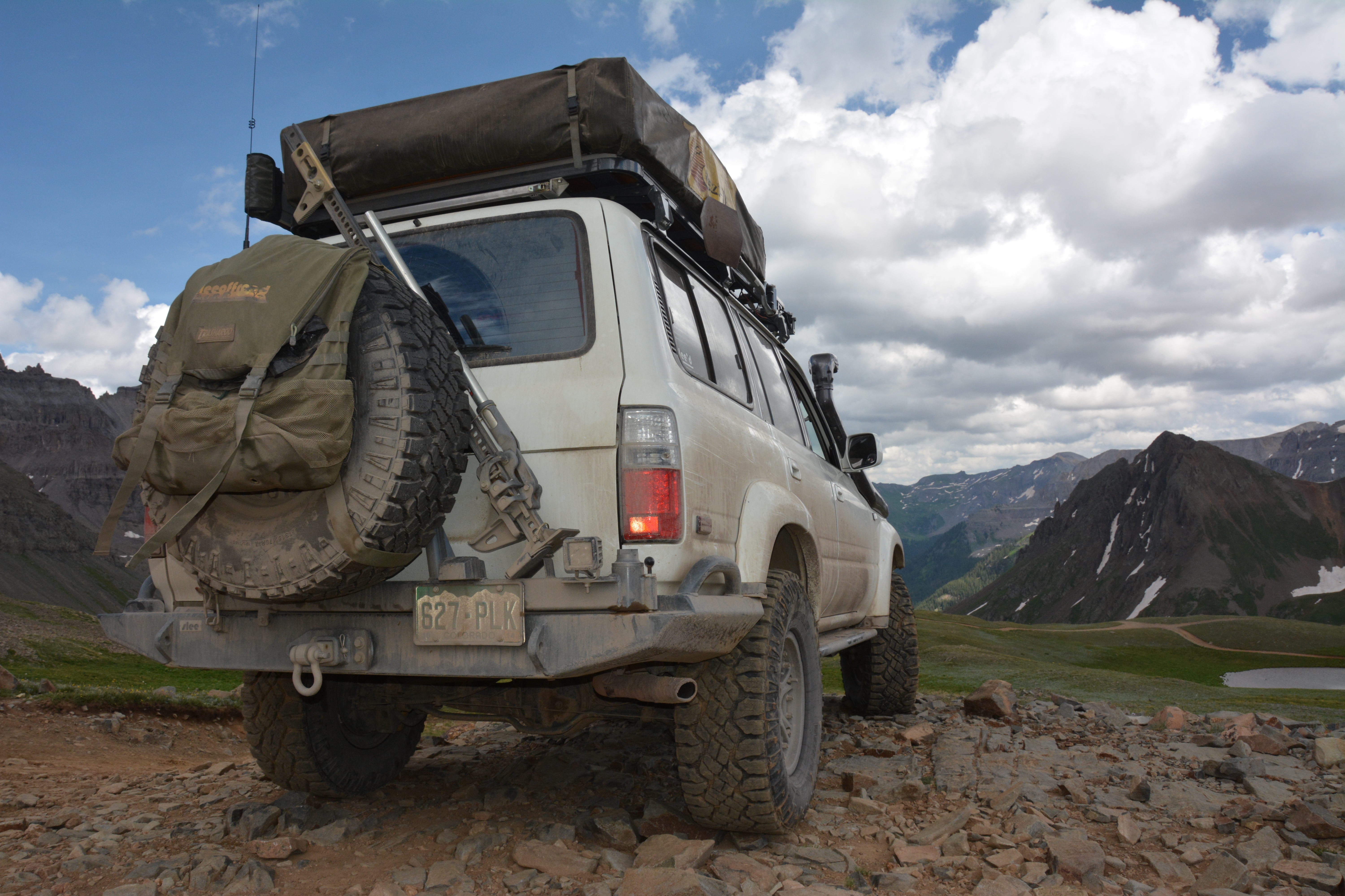

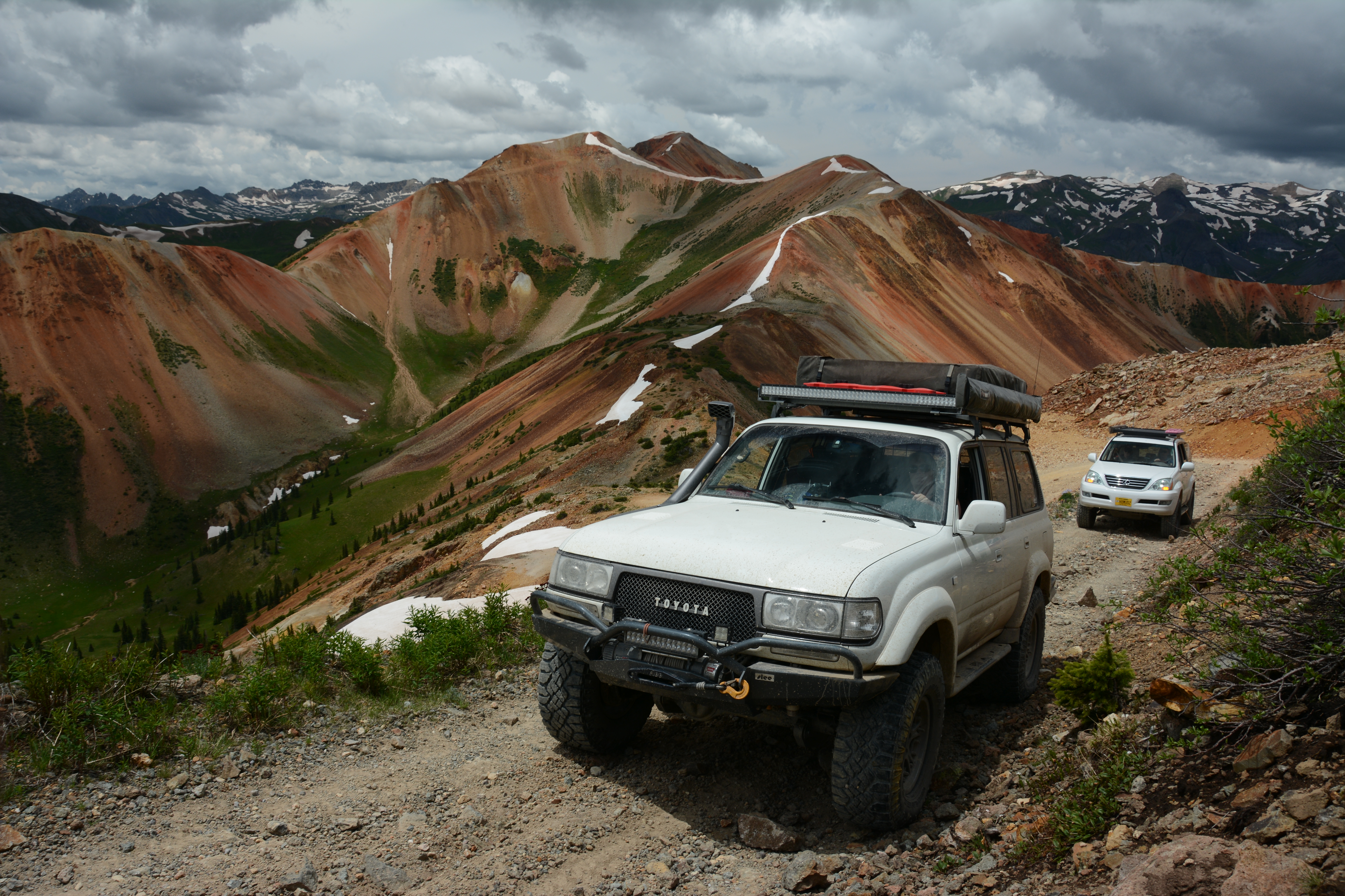

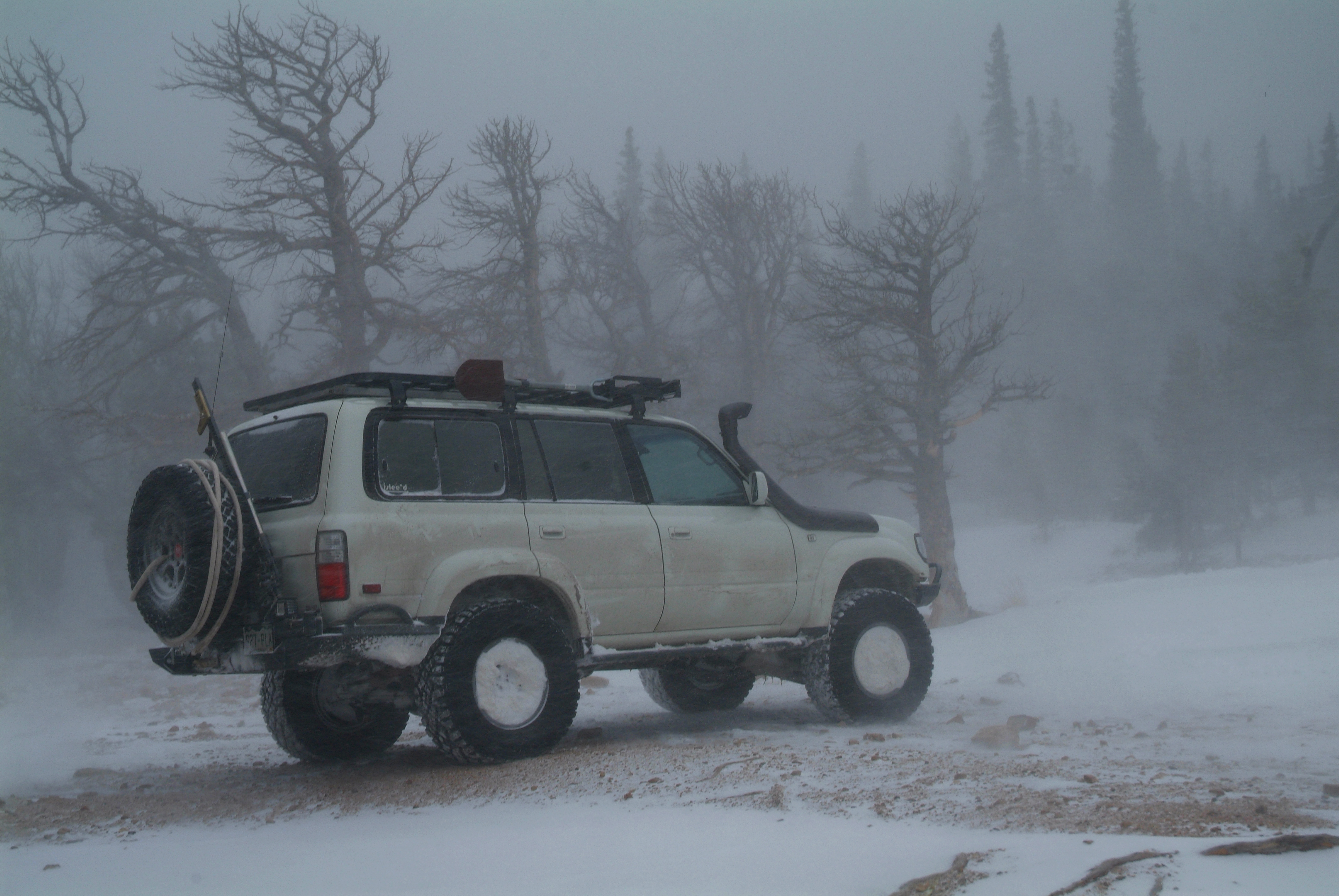

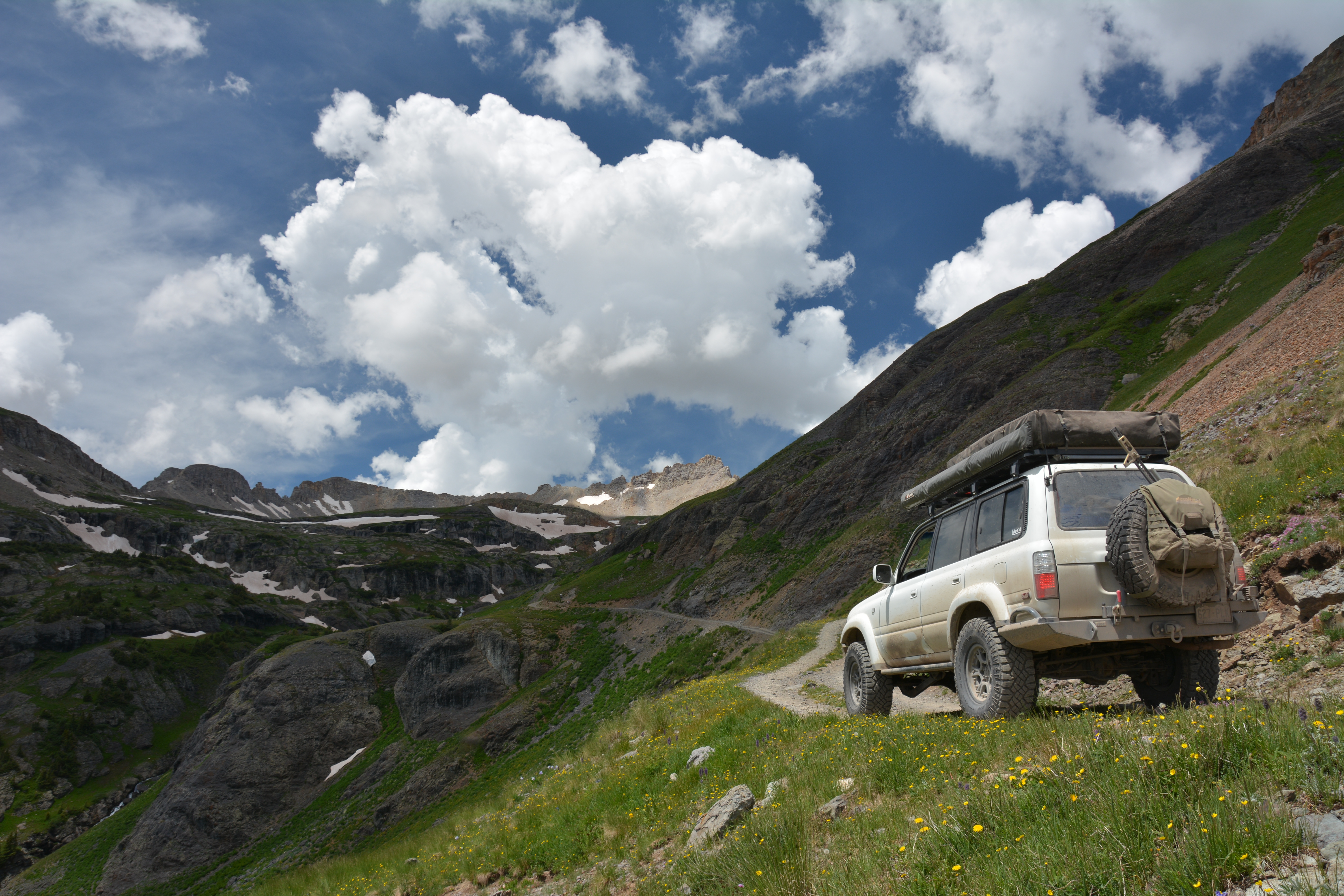

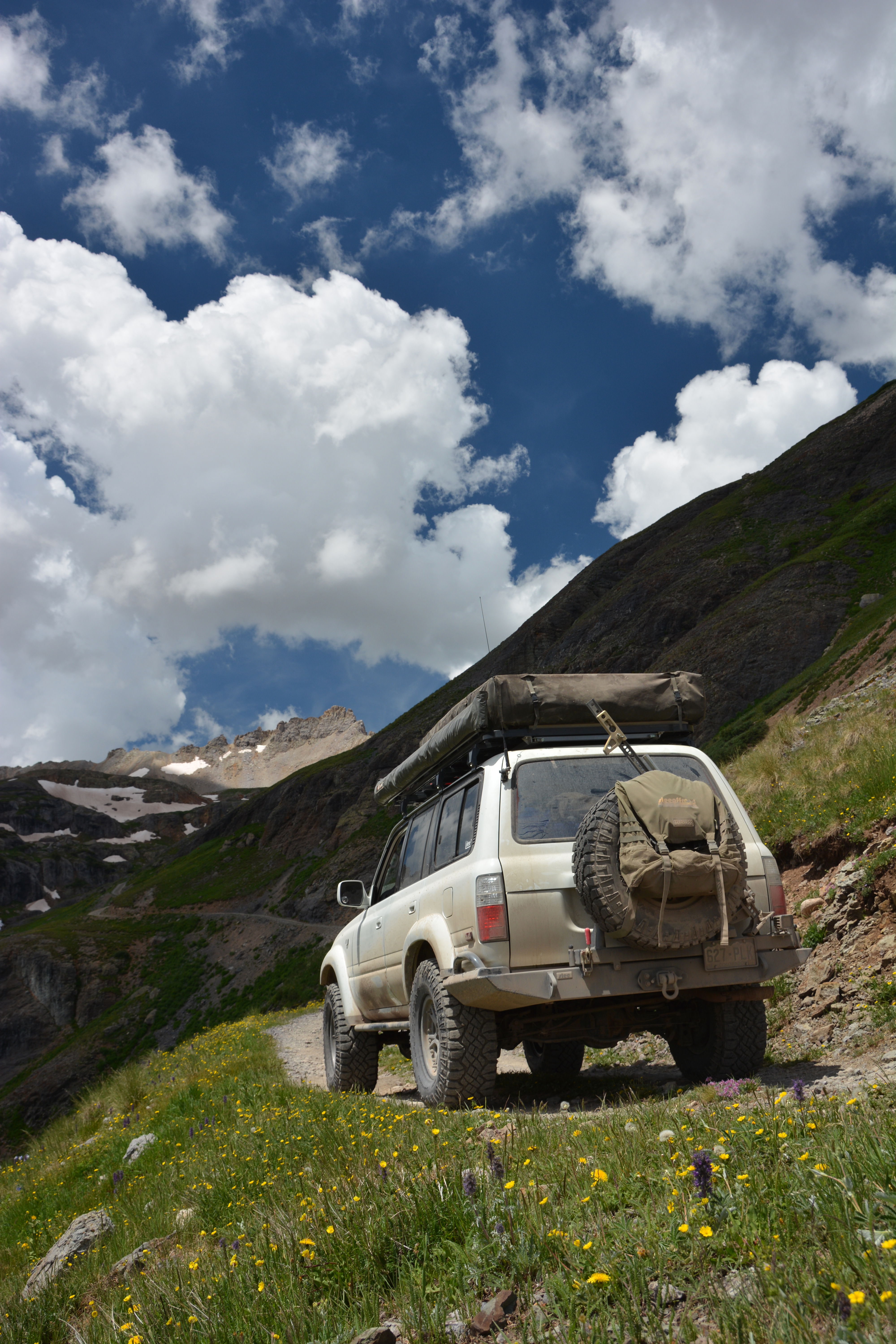

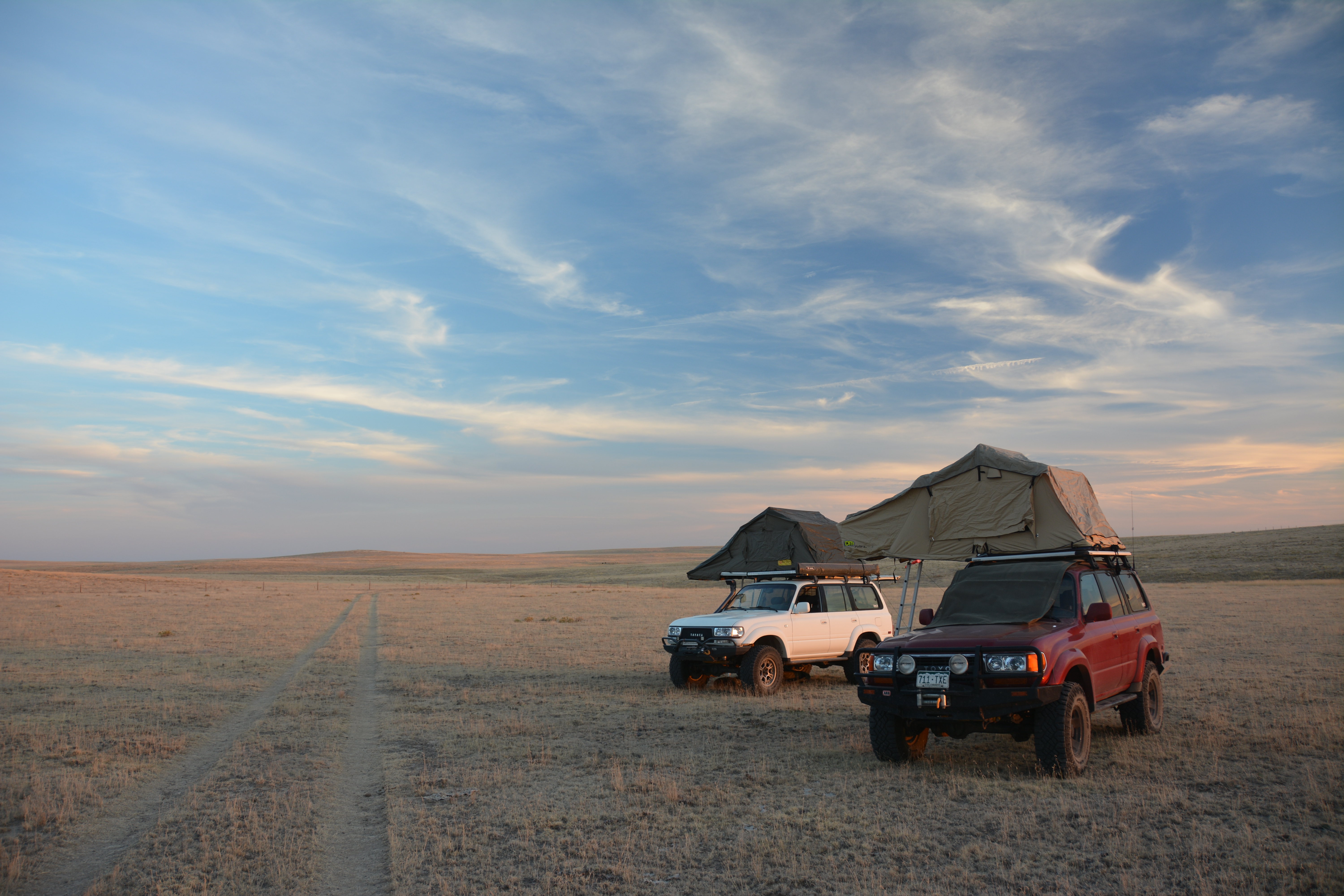

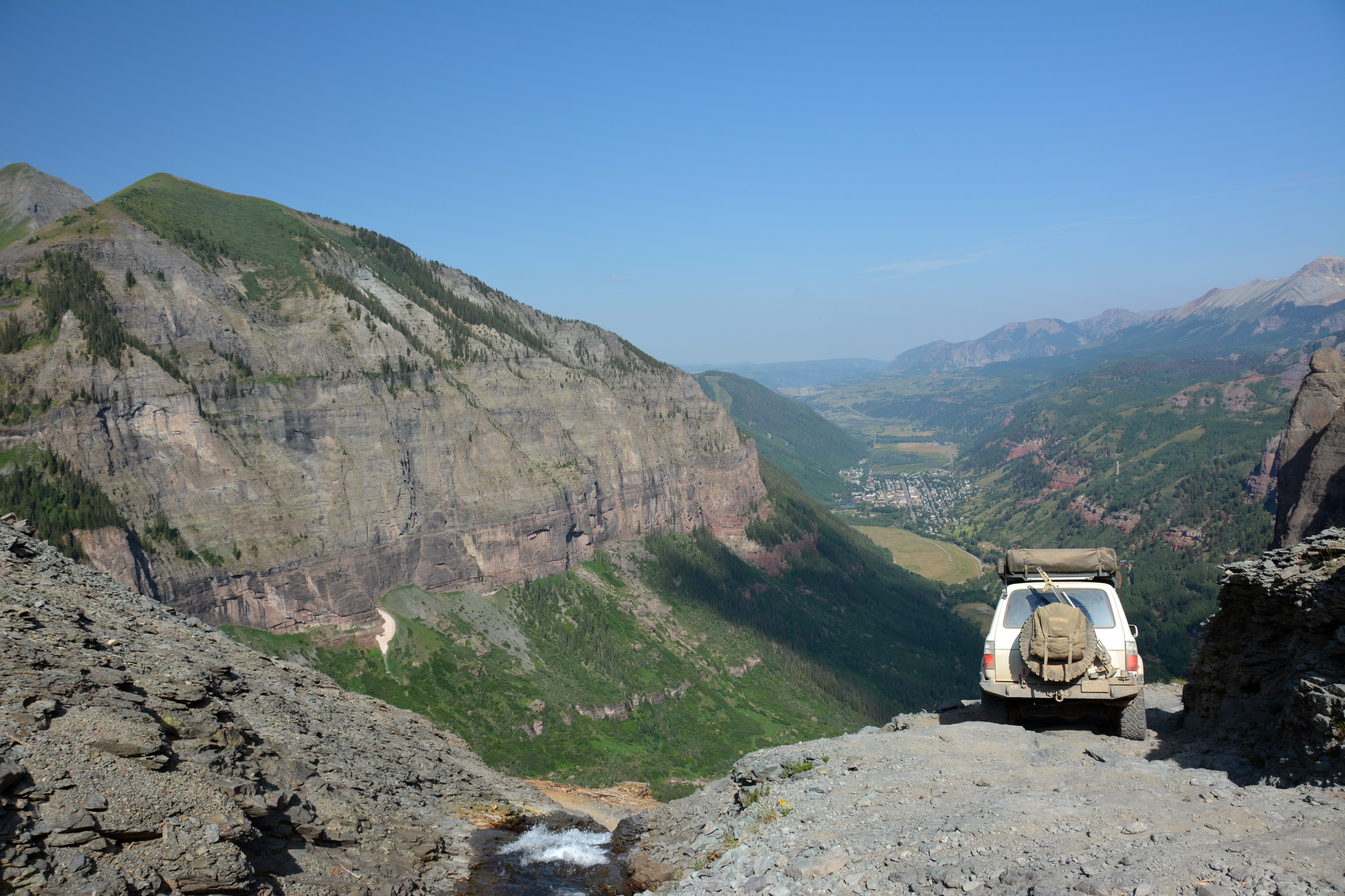

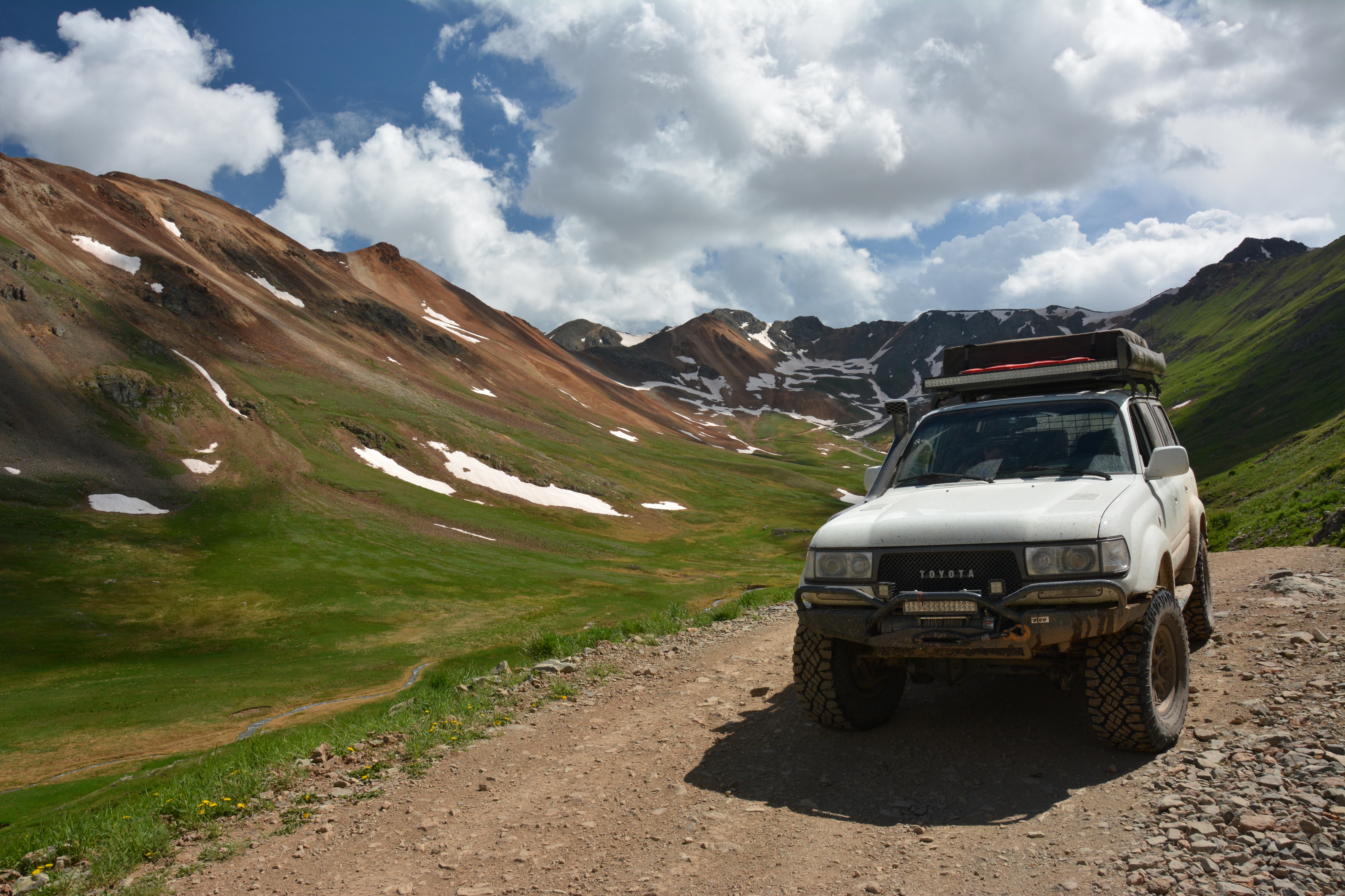

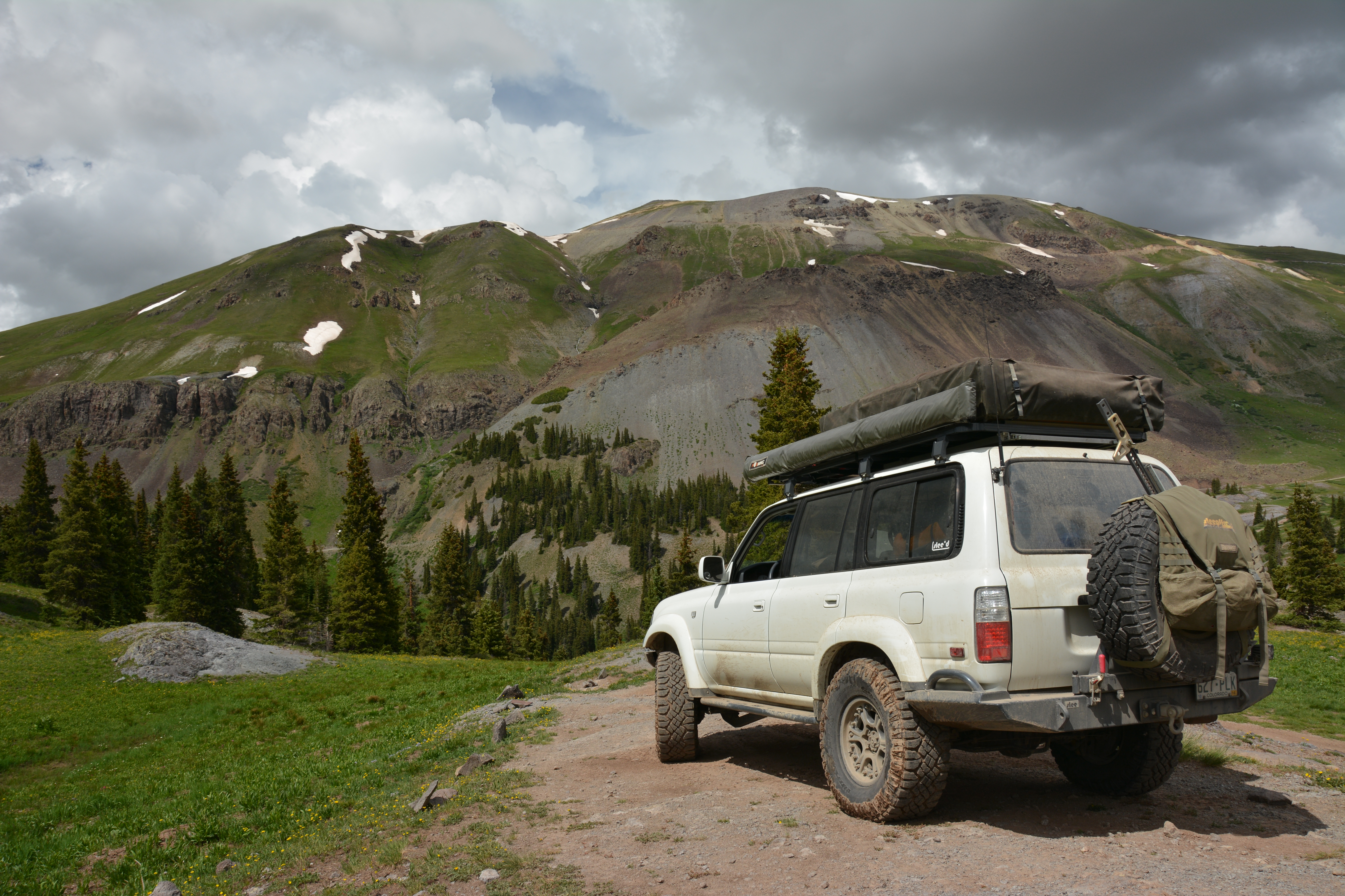

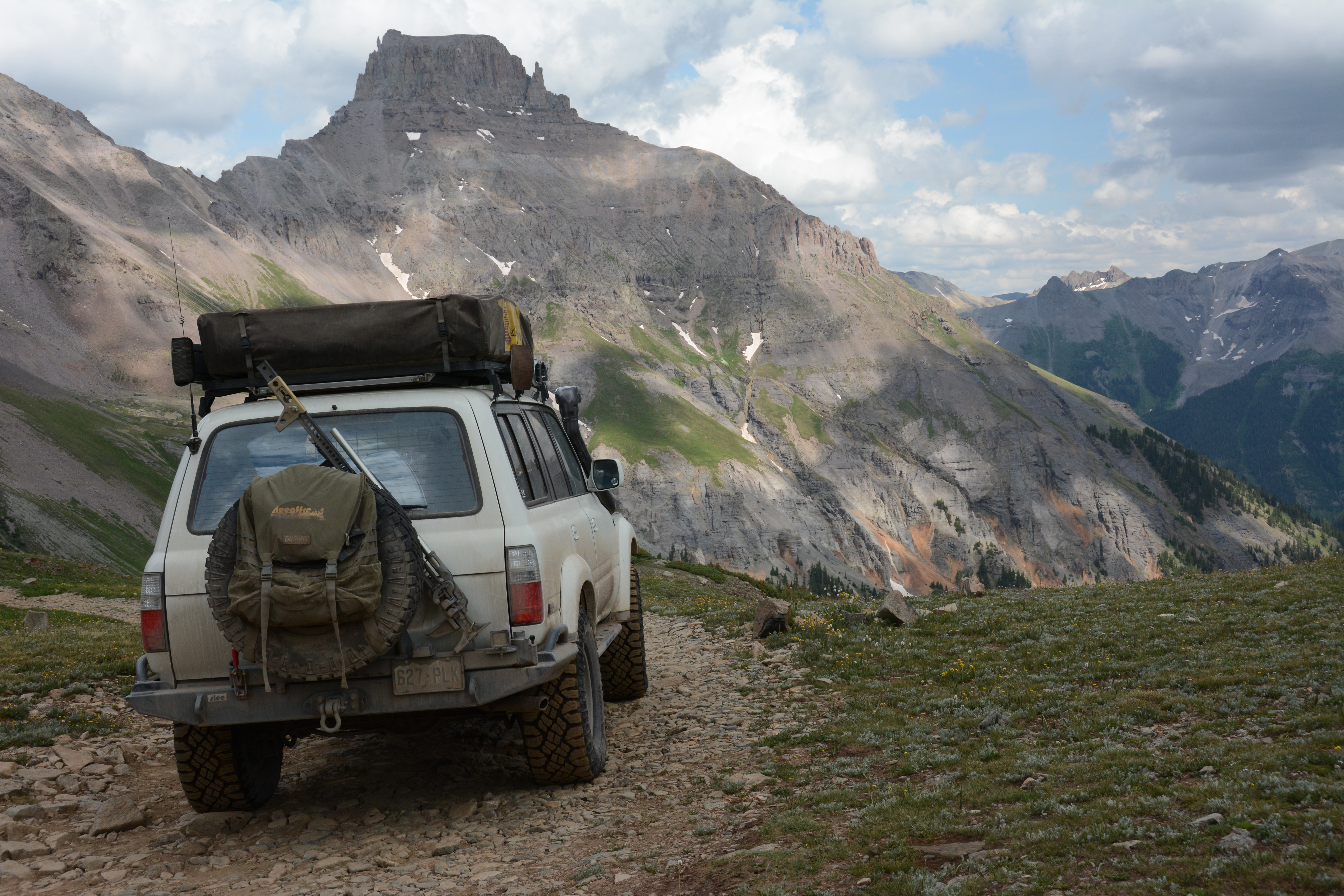

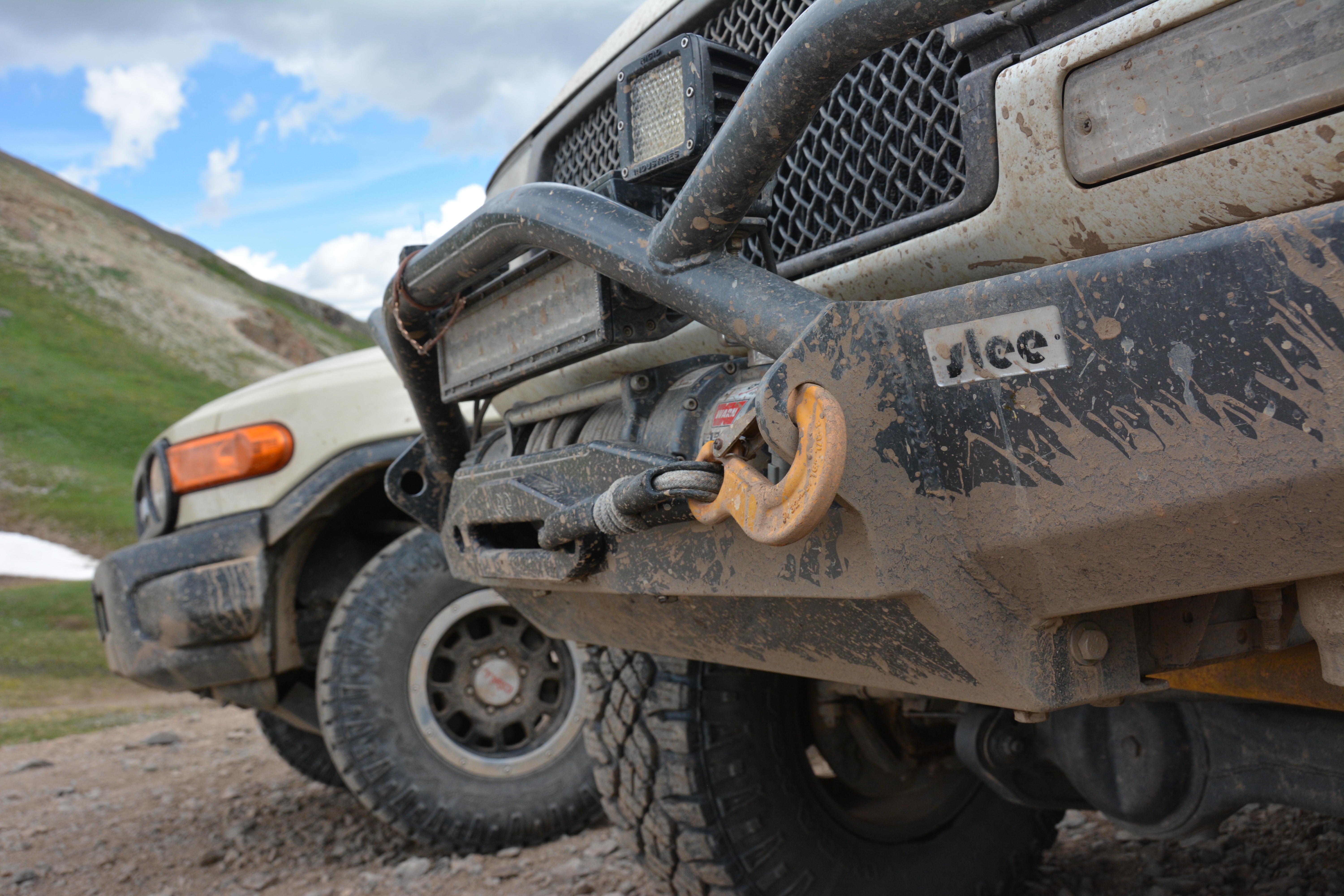

Decided to post some 2014 wheeling pics to the build thread
Pawnee National Grasslands - John Killham (Snowrun) and Mike Davidson (treerootCO).
Click for high resolution:
Brian and Heather Swearingen in the GX470
