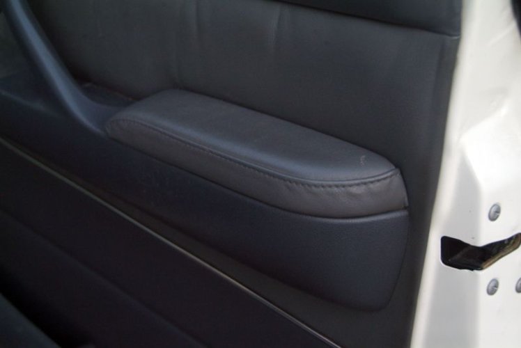

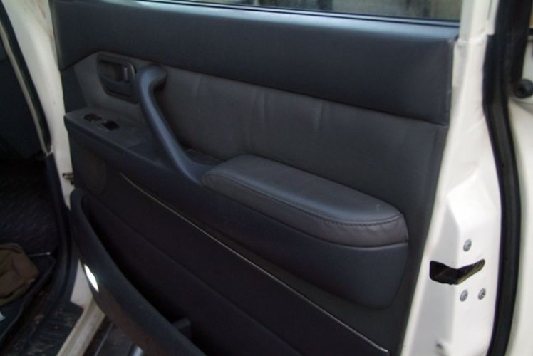

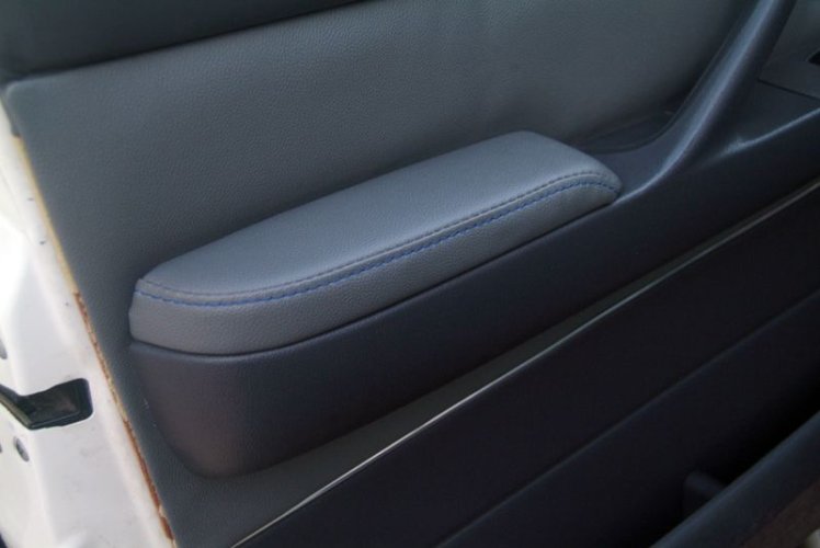

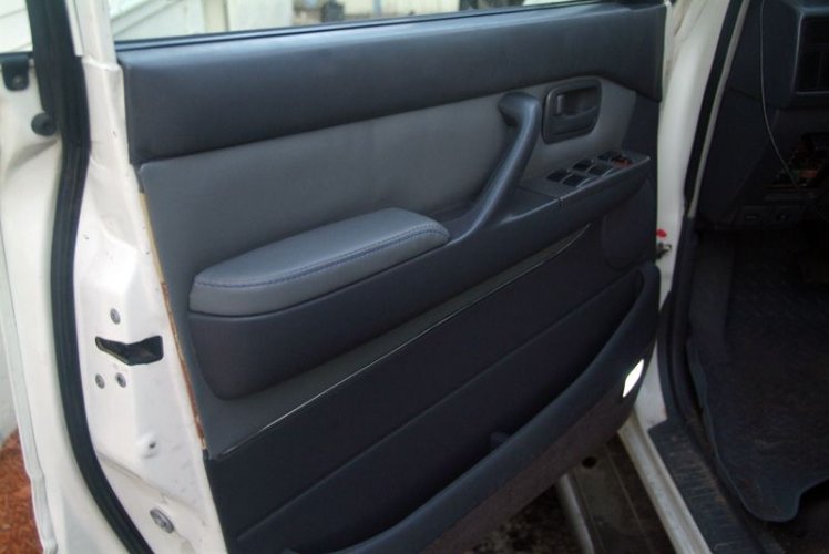

Started working on the new leather. A door and the armrest. I was going to gather the leather but decided to keep it smooth. Looking at the first pics, I need to go wrap the leather around the door edge. Whoops...
Blue stitching!
Before
After
Before
After

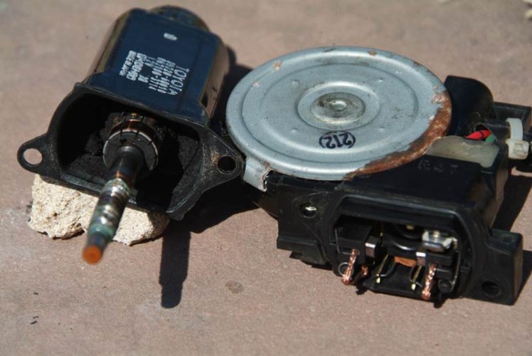

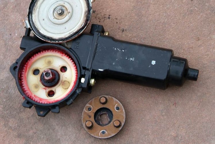

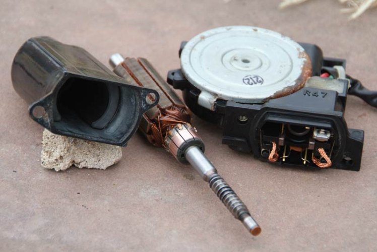

Fixed the driver's side window that refused to go back up when it was cold outside.
The regulator was broken and is only available as an assembly. At $95.00 it gave me a good chance to see what a good one is supposed to be like. There is no play between any of the pivot points and the spring is 20times stronger on the new one. If you can source a new window spring, hammer the rivets of all the pivots, and assemble with clean tracks, I would guess that is all that is required to make these new again.
The motor and brushes were really dirty so that got taken apart and cleaned. I polished up the armature with a red 3M scotch bright pad and reassembled. The only grease I could find that shouldn't get hard when cold was some Mobil 1 syn so I threw that in. The brushes looked fine and still had some life left in them.
I cleaned the window tracks and relubed them with silicone. I also added some sound deadening to the door and that made a big difference. The door feels like it should now without the bounce back twang it had since I bought it.

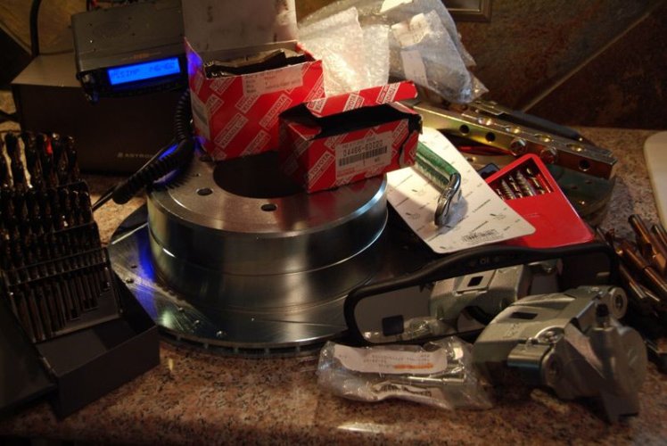

I lost the pads on the rear brakes and was stopping on the caliper...burned through the rotors and had to replace the calipers. Made a few calls and stopped the Mountain High Performance to have a load Cryo-ed. Slotted and cross drilled rotors from Christo, a new set of American made drill bits, and some left hand drill bits and extractors made in PRC :(, all got frozen.

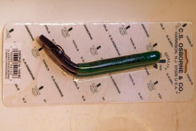

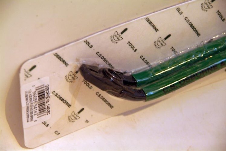

I also have been working on the new leather and went to the source for a real set of hog ring pliers. $65.00 out the door, not Chinese made, and should last well beyond just this set of leather.
The brand is C.S. Osborne, Harrison New Jersey.

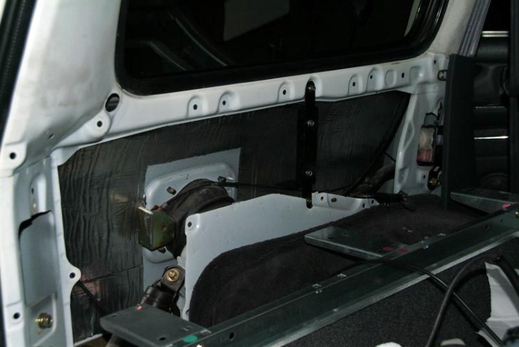

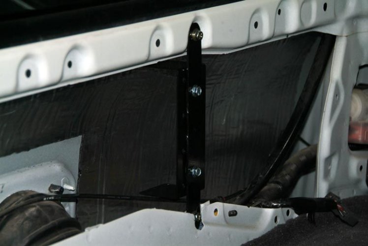

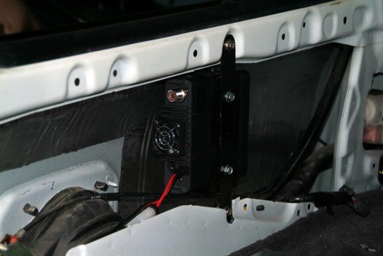

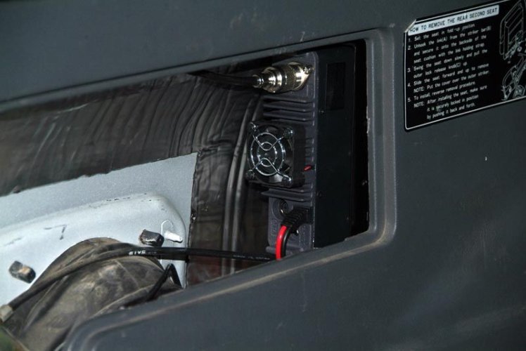

Quigly came by Sunday and helped get the ham mounted.

Sorry Mike looks good How are you going to hear it. The speaker boy where is the speaker going to be as Foghorn would say
treerootCO
5,424
The speaker is remote, there is a jack on the back for an external speaker. As an added bonus, the rear passengers can still hear the stock one. I am putting the CB and HAM speakers in the dash so no extra stuff cluttering up the interior.
